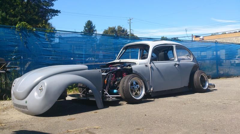

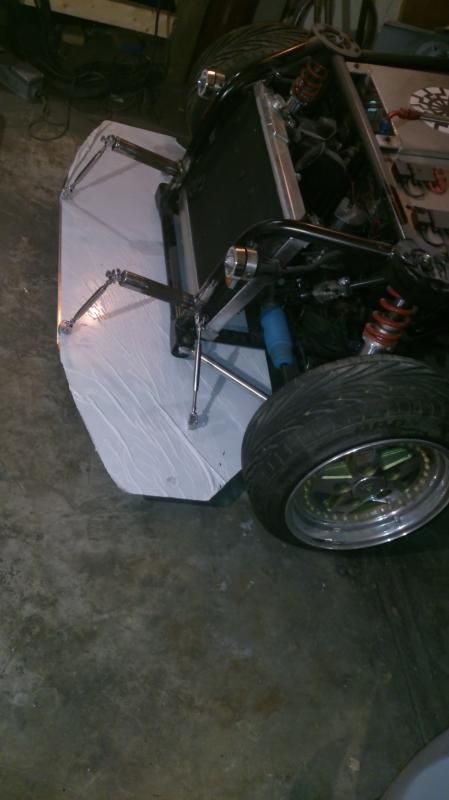

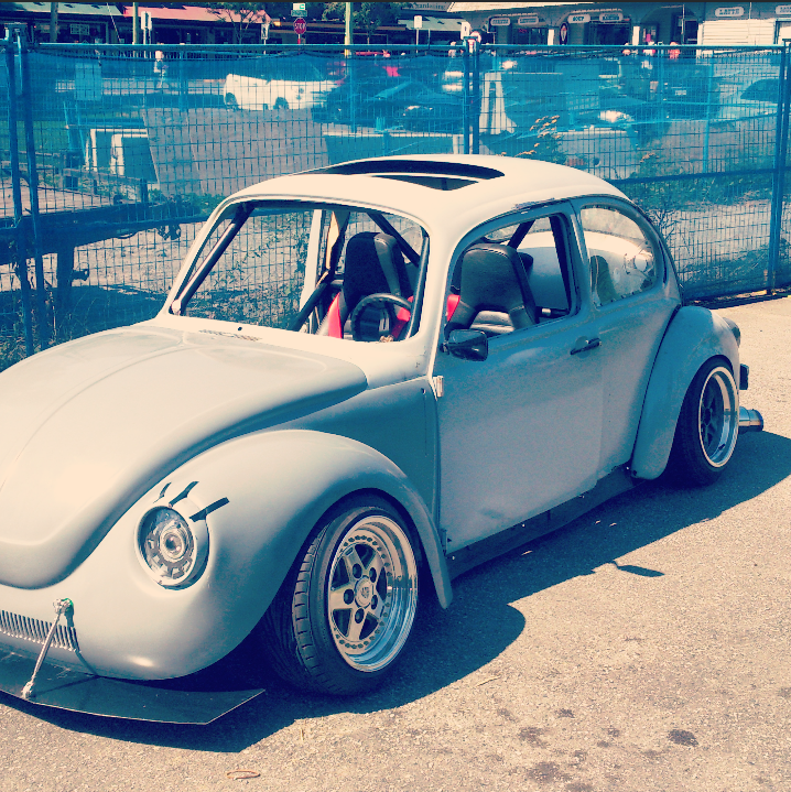

Almost done my front splitter:D
http://i7.photobucket.com/albums/y25...8.jpg~original
http://i7.photobucket.com/albums/y25...d.jpg~original
And some ideas for some side plates.
http://i7.photobucket.com/albums/y25...5.jpg~original
The splitter is quite strong and I can stand on it near the supports. And it helps continue on with the flat bottom of the rest of the car. I figured I needed something to make the front end stand out since I'm not going to run any bumpers on the car.

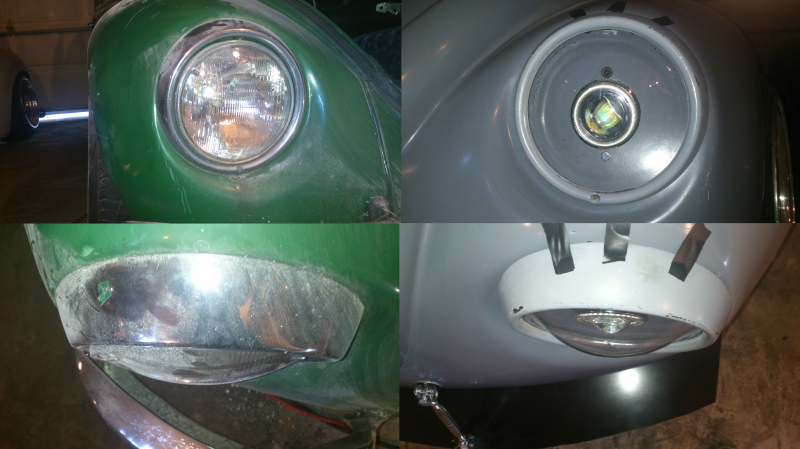

vw1303 August 14th 2014 16:34
http://i7.photobucket.com/albums/y25...c.png~original

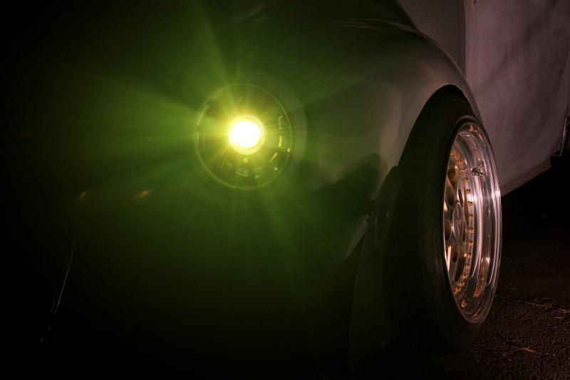

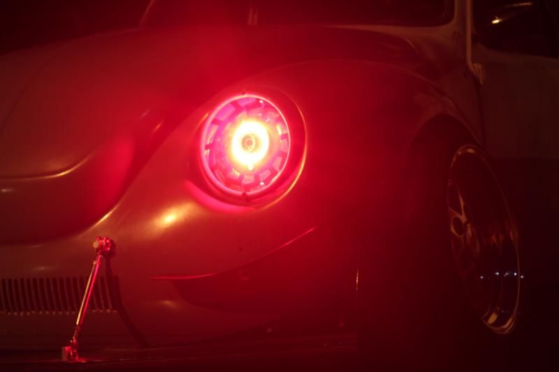

Working on the headlights. I used some acrylic sheets and made a small wooden jig with 2 holes and sandwiched the sheet between it then heated in a oven and used a bowling ball to form the curved lense.
http://i7.photobucket.com/albums/y25...0.jpg~original
Also front end is now fastened on with 5 dzus fasteners and to points at the front with a tow hook. "Side Skirts" are made with 6" garden edging and fastened in the stock location.

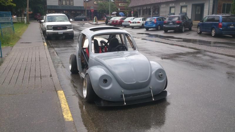

New front aero:D
http://i7.photobucket.com/albums/y25...y.jpg~original

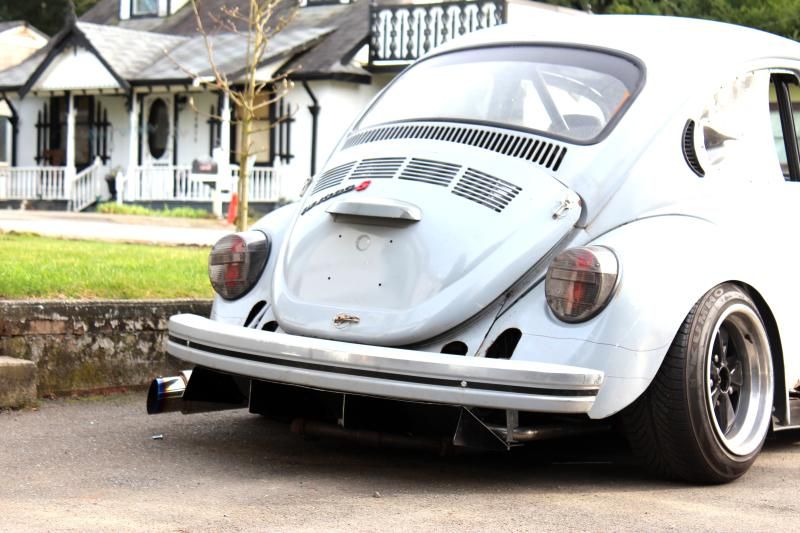

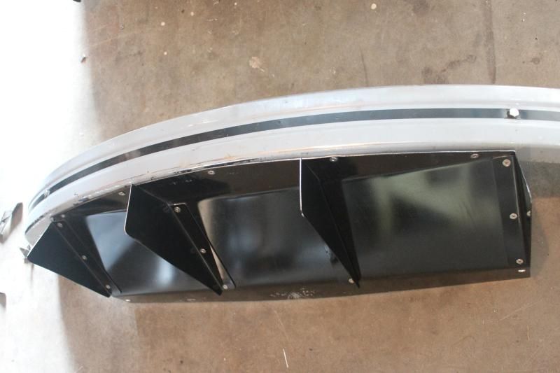

Rear diffuser
http://i7.photobucket.com/albums/y25...r.jpg~original

any chance we can can get some up close and under to see the Rear Diffuser and how it attaches and how you did the from Splitter too please..

vw1303 March 2nd 2015 14:40
http://i7.photobucket.com/albums/y25...a.jpg~original
Rear Diffuser attaches to the bottom of the rear bumper and extends all the way to the engine.
graham March 3rd 2015 02:39
ej20t 1303 project
Ive had something like that knocking around in my head for ages :D good on ya
owdlvr March 4th 2015 16:27
Watercooled...+1 point.
:P
vw1303 March 11th 2015 11:40
Yeah the diffuser would probably hinder cooling in an aircooled application.
Here are some pictures of the projector lights in action.
http://i7.photobucket.com/albums/y25...k.jpg~original

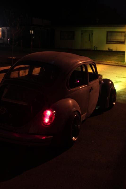

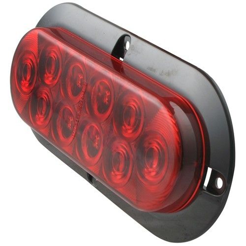

And LED tail lights
Coincidentally these fit perfectly in the elephant foot:)

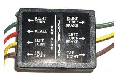

I used one of these for the so I can have stop/turn/running light.
Scotts73SB March 11th 2015 23:19
I might be weird..(who isnt) but i really like the "bloodshot eyes" look!!

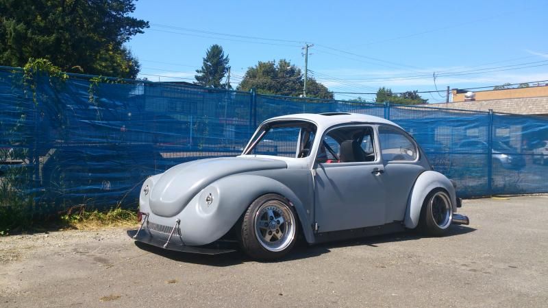

Splashed some paint on the forever grey car.
