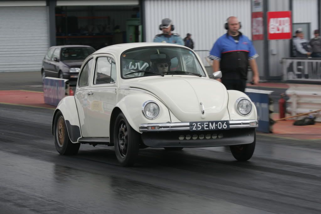

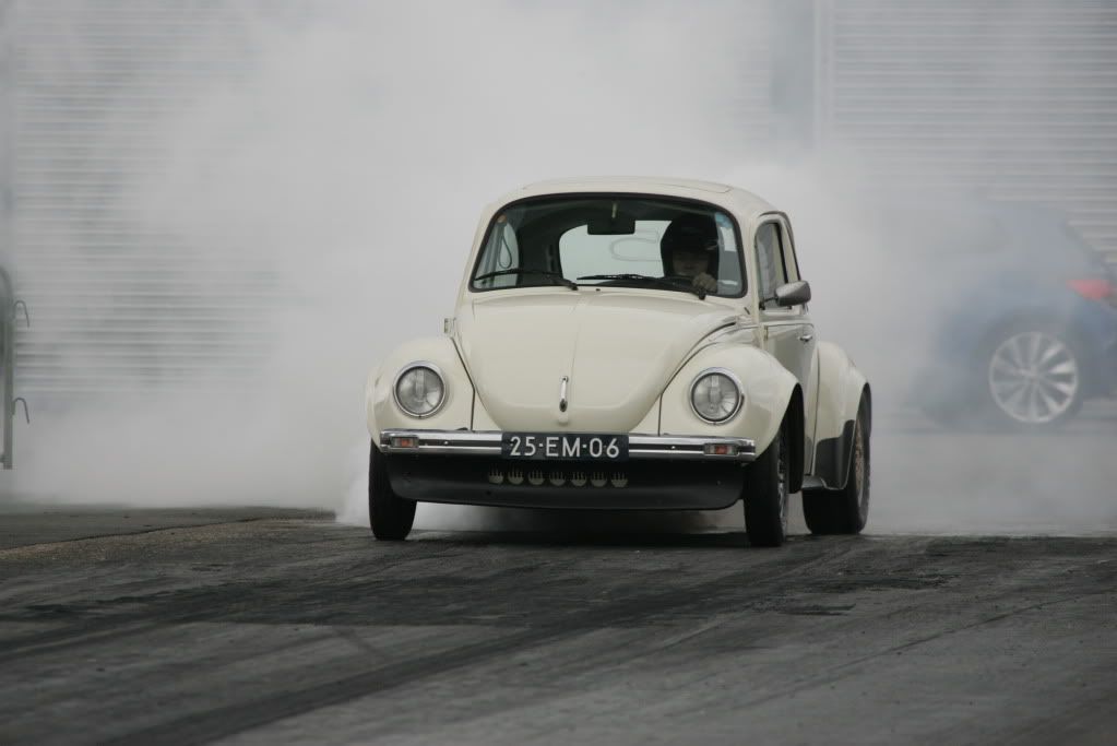

Went to VW Action last weekend! Absolutely fantastic!
More details to follow, but I ran a 12.05 with a 1.65 60ft :)
chug_A_bug September 7th 2009 19:01
Nice Wally...
Looks like you Hooked up well on the Last pic :)

Wally September 8th 2009 06:18
http://i631.photobucket.com/albums/u...ON20091320.jpg
http://i631.photobucket.com/albums/u...ON20091321.jpg
http://i631.photobucket.com/albums/u...ON20091324.jpg
The 130 mph end speed is a fluke, but a cool one :-)
