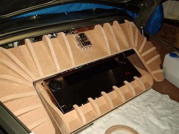

today the f/g work started finally on the upper tier. The skeleton pieces were hot glued in place and then fabric stretched over...couple coats of resin were applied to stiffed it all up to get ready for the f/g matt (this week some time).
http://i10.photobucket.com/albums/a1...9.jpg~original

Slowly but surely the amp rack progress continues. When painting fibreglass (rather than carpeting or vinyling it), a lot more time has to be spent to get it spot on.
There have been about 8 layers (most of which gets sanded off) of filler applied to get the desired shape. Lots of sanding thats for sure! Hopefully will have it high build primer then colour soon.

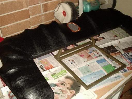

Well I pulled my finger out and shot a couple coats of high build primer this arvo. Overall pretty happy with the prep - only a couple of areas that will need a bit of glaze putty. Took ages to sand between the ribs on the hinged cover piece - pain in the ar$e but should be worth it once it is finally finished!
http://www.manxgallery.org/gallery/a...ck20_Oct16.jpg
http://www.manxgallery.org/gallery/a...ck21_Oct16.jpg
