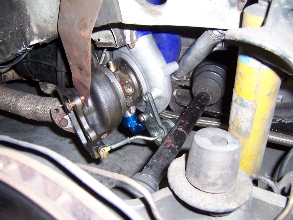

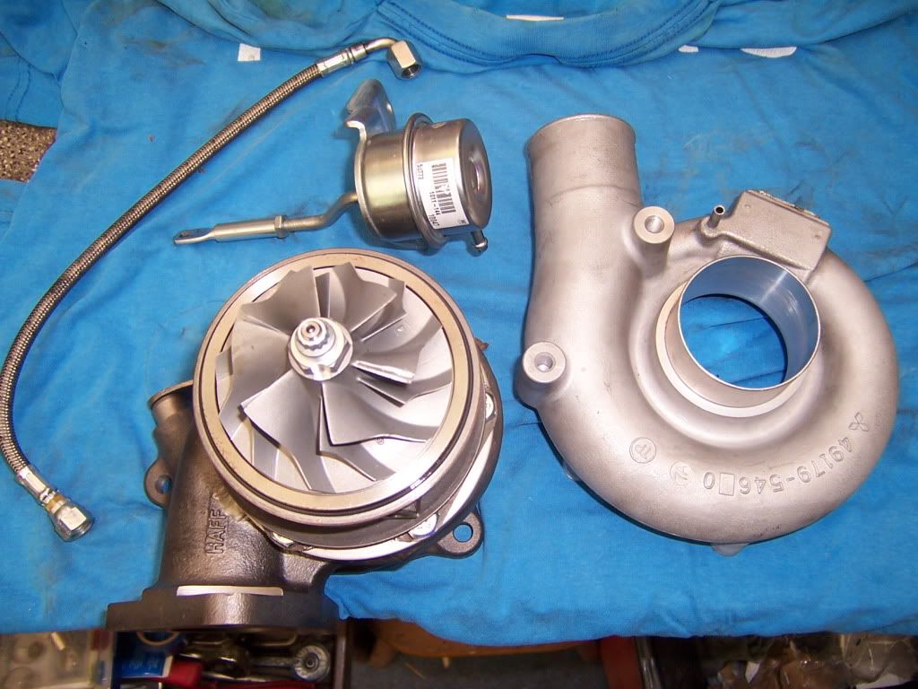

Got a smoking deal on a slightly used 'bigger turbo' :D
Hope it gets here in one piece soon...
Its not one of the usual turbo's that are being used though..
http://img15.imageshack.us/img15/1579/img5368n.jpg
http://img195.imageshack.us/img195/5743/img5366e.jpg
fahrvergnugen September 16th 2009 14:29
Don't you have a bigger picture:eek:
Paul:;)
Sandeep September 16th 2009 15:55
Judging by the size of that picture, it IS a big turbo !
GT3076R CHRA ? :rockon:
When is it being installed and when is the dyno booked ? :D
Wally September 16th 2009 17:06
Yep, I guess I have basically the same turbo as you then? :cool:
Said to have a 52 lbs compressorwheel...
Probably an over winter job and fitment is likely to be not as easy as I anticipate (as usual..)

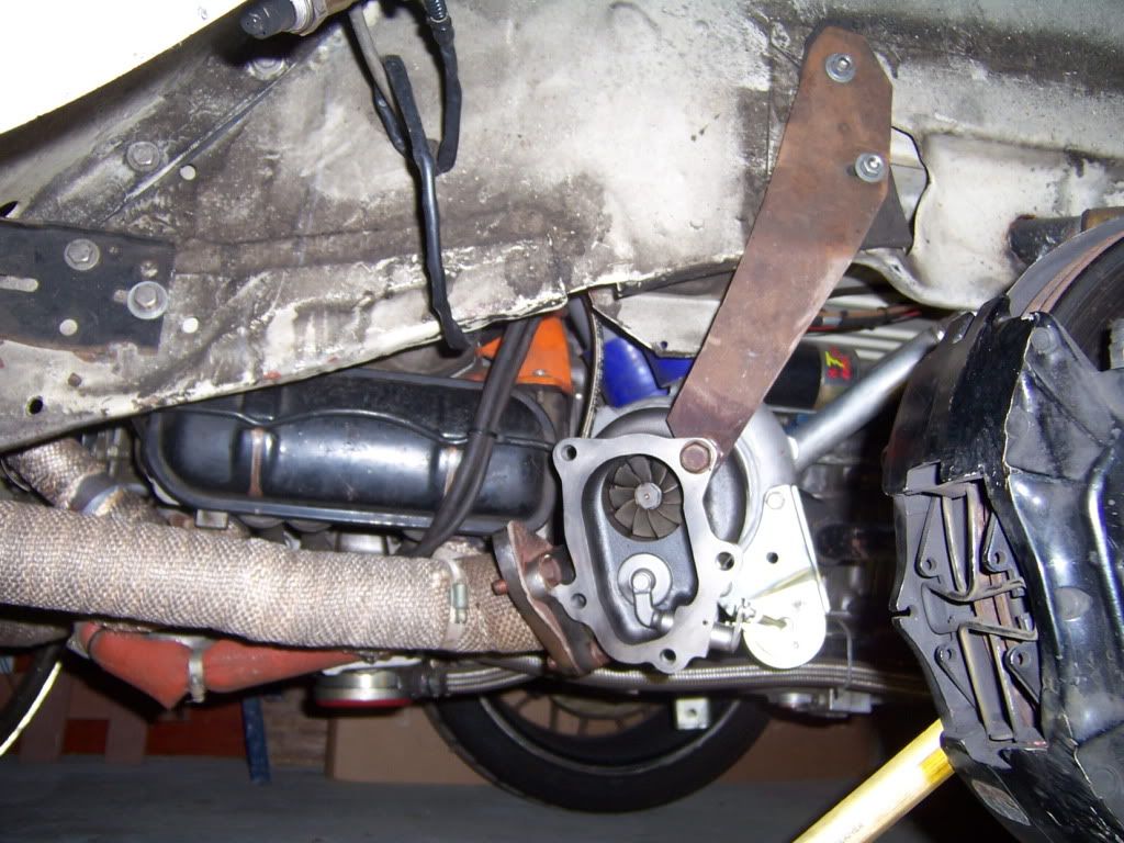

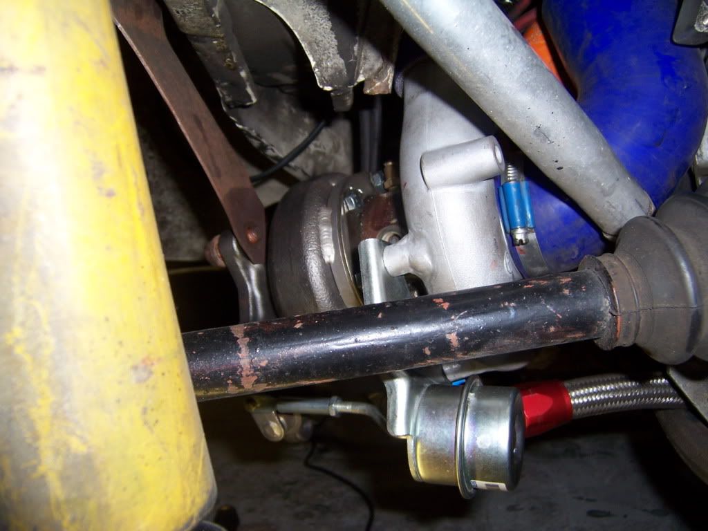

The Blouch DOM3 (or GT30R if you like) is underway and going very well. Almost too well...
Getting the right orientation for the install under the bug meant disassembly. Always scary as you don't know the part and taken apart a perfectly fine almost new part is somewhat counterintuitive..(well...:rolleyes::lmao:)
Here you can see that the intake is just passing the cupstrebe and the tranny/starter. The wastegate even has more room on this one, but one of the alu threads for fixating it to the housing is almost stripped...Have to wait and see if it holds.
So, the IHI VF34 is now for sale ;-)

effvee October 15th 2009 07:37
Waste gate location
Hi Walter, please be very careful of the waste gate location. If somethng hit it/bend it, you could over boost.

evilC October 16th 2009 07:17
Heat on the outer CV could also be a problem especially when stationary after a power run and its glowing red hot:angry:. You could kill two birds with a heat/impact shield over the waste gate and exhaust side of the turbo.
