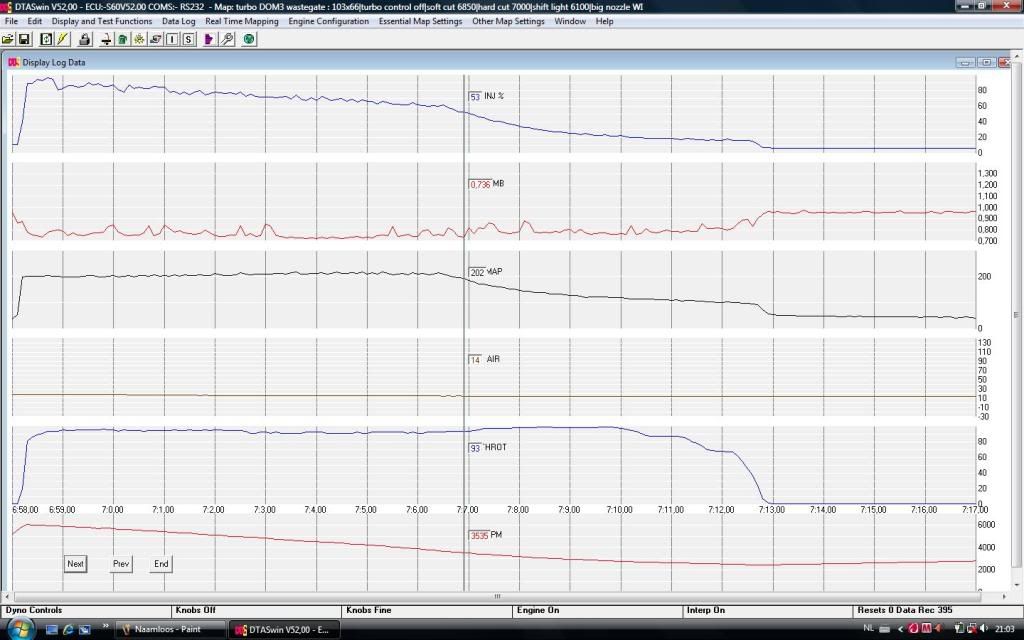

New turbo has been started and run for the first time! Whoaha! I like this turbo already :D
This was just on the internal wastegate without WI and without any additional tuning, but already is clear that this 50% more flowing turbo only gave a 100 rpm later spool to make 1 bar boost :cool:
Proof:
http://i174.photobucket.com/albums/w...g.jpg~original
It also holds its boost better and the internal wastegate doesn't creep (yet) as is shown by the steady boost line.
BTW: 200 MAP is 1 bar boost above ambient (=100). The wastegate boost goes on to about 1,15 bar boost (~17 psi).

Even without further tuning that is quite an improvement! My guess is that your intake temps are also lower due to the better effeiciency of this turbo.How much boost do you intend to run?

Intake air temp is also in the graph: ' AIR' Its in Celcius and outside temp was about 12 degrees Celcius. IAT started at 14 Celcius and climbed to 18 Celcius during that WOT run. But I have a slow Bosch sensor and its probably not showing the fast increase accurately.
The info is all there in the log though ;)
EDIT: does everybody 'get' the log? (in what you see?). The log adds data and therefore puts new info at the left in front of what was already there, so you need to watch it in such that the car runs from the right hand side to the left. Boost and INJ% (= IDC) rise when I floor it and throttle gets over 90% (100%=WOT). The x-axis is in seconds (time), so the log part you see here is from about 7 minutes ago after I shut it down back home. /EDIT
Do you also see the IDC (injector duty cycle) climb to over 80% at the end of the run at about 6000 rpm? I am a little (too) rich maybe so a little gain in IDC room can probably be made, but I am running out of injector pretty soon (again...)

70Turbobug October 29th 2009 10:54
Ahh now I see the air temp - thanks!
then that says something about the efficiency of the combo.
That is the reason I was asking.I´m anxious to see how much you can add without detonation.Myth has it,that a larger bore is more prone to detonation.So another myth to be busted! :D Inlet temp plays a key role for that,which also dictates how far you advance your timing and where in your rpm band your max boost will start.
What is the MB (Lambda?) and PM (Timing?) on the vertical line in the graph mean?

Wally October 29th 2009 12:46
Some of the abbriviations fell away because I put the line exactly in the spot where 1 bar boost has been reached, so you all could see what the sensors read there, especially the rpm, which makes a nice bridge tou your q.:
MB is the remnent of LAMB ;)
and PM the remains of RPM ;);)
so hopefully you now see that 202 (1,02 bar boost) is reached at 3535 RPM :D

I've copied the image to my desktop so I can review it in detail and then ask some questions :lmao: What size are your injectors again ? I'm now thinking my 57 LB/hr (599cc/min) are now too small :(
Your very welcome to it :)
I now run the 60 or 63 lbs Siemens injectors. Said to be 660 cc/min at 3 bar or 45psi fuelpressure, but I have upped the fuel press. in the meantime to 3,5 bar.
Rolling road dyno is booked for saturday morning early. Little bit too soon, but later wasn't possible or too late for me...
I hope I can get the boost regulation dialed in again on time and tune for it. Will be stressed for time, but very curieus what she will do on the dyno.
BTW If you indeed study the plot closely, you can see that at around 5800-6000 rpm, the lambda gets a little higher for half a second and that the closed-loop immediately corrects this by adding fuel, which makes the IDC go up there at almost that same very instant! The Bosch/Innovate are very quick to react and the DTA closed loop function does too. It all shows in that very spot. I have now added some more lambda filter, so that will smoothen the curve a bit more I hope and relex the closed loop corrections a bit ;-)
