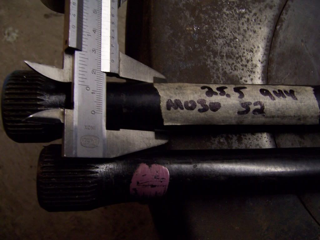

Something to handle the upgraded power a bit better (I hope) through the corners: 944 M030 25.5mm torsion bars:

Wally, nice job! :)
I hope those 25.5s will be OK, because I also bought them for my project. I guess, I'm waiting for the update about how they changed Your Bug, meaning driving feeling!
