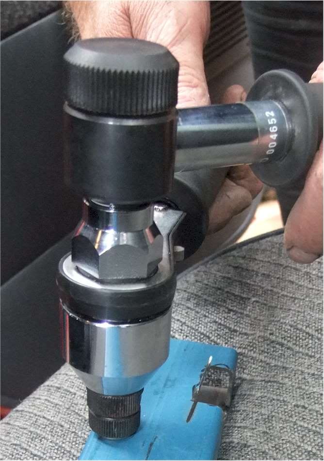

I will check my local flaps tomorrow for a sender. Do you need anymore metric nutserts?
I came across the correct tool for them made by Wurth, I love it

Haha, one thing I do not need is more Metric Nutserts! When I realized how tough they would be to get, I cleaned out the warehouse :-) I've got 200xM5, 200xM6 and 100xM8. I don't think I'll run out for a while!
Hmmm...that tool does look trick. Will look into it.

I use a Kobe rivnut setting tool for the M4, M5 and M6 blind rivnuts (nut serts etc), It cost me £24. Its a two handed operation and can be used with a cordless drill etc but I use a 1/4" ratchet that sets them perfectly every time. For the M8 and M10s I use a tool that looks like the Landrover one that consists of two pieces of 1/2" steel bar with two 5/16" UNF bolts that force the bars apart and a hole through both to fit a bolt that holds the rivnut on one side. The whole thing is closed up and a rivnut is put on that goes through the panel hole. The bars are forced apart that causes the rivnut to set. The important thing here is that the rivnut can't rotate, which you can get using just a single bolt to set the nut causing it to unwind. If I have a problem with the Landrover style tool is that I can overdo the clamping force that causes the top of the riv nut to collapse, closing the hole and making the setting bolt difficult to get out easily.
judgie February 24th 2012 04:43
i have a air powered tool for rivnuts. it could double as a torture tool as the part that slides is right were the web between your thumb and finger wants to sit on the handle. means you have to watch how you hold it or it pinchs you and you have to recycle it to get your hand out. how do i know this?......
has to be set right or you can pull steel m10 serts inside out but you can do m4 alloy serts with it.
