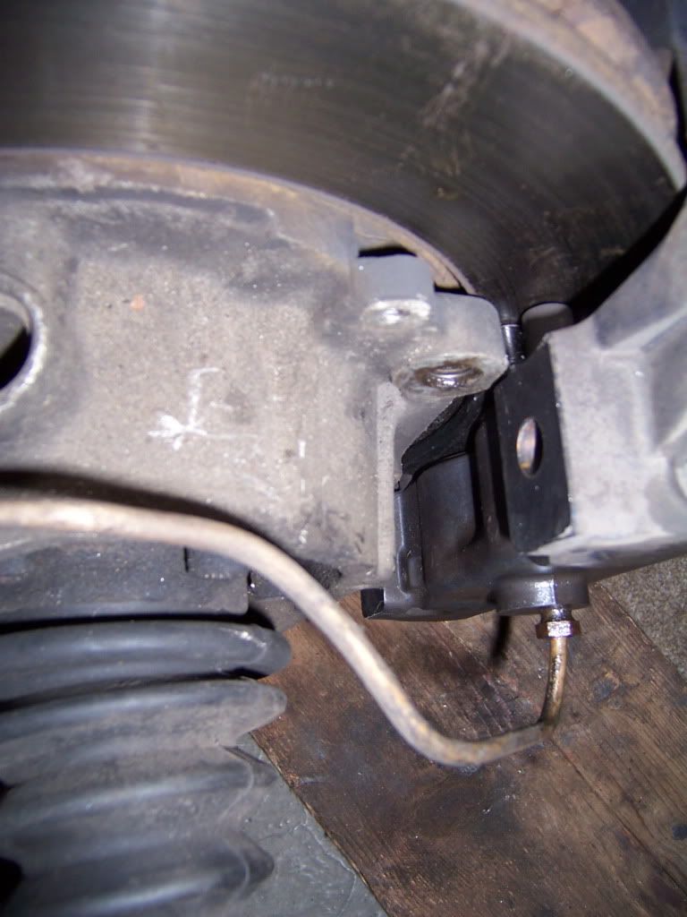

Wally December 20th 2009 12:36
Winterjob: adapting boxster front calipers to the rear to get better balance:

70Turbobug December 21st 2009 06:11
You had 944 turbo calipers before right? What was the "problem" with those?
Wally December 21st 2009 07:04
No, I even had the 993 rear calipers, which even have a little bigger cups than the 944T's.
Problem is brake balance. Been fighting too little rear brake bias for years now. Yes, tried 'everything'. Going back to my original believe that on a bug you can almost have the same calipers front as rear. Fronts are are 996 front.
This measure should solve that 'problem'.
