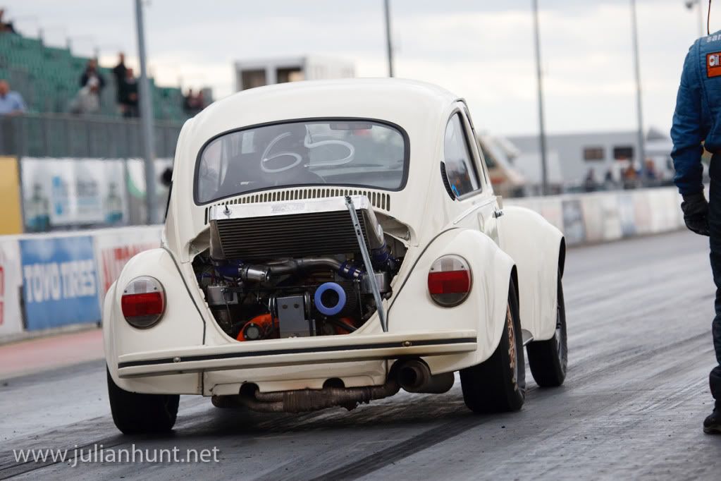

Some late incoming (awesome) pics from Julian Hunt (www.julianhunt.net) from the VW Action trip last september:
Yeah, I did run very low tire pressure to try get into the 11's, which worked great for 60ft times, but mph didn't move much:

Great photo's Wally! :thumbup:

Drag photos!!! I love them!!
Wally December 25th 2009 07:22
Glad you like them!

Great pics Wally! Looks like you´re getting a little air under the front wheels in that last pic?

Love the pic with the crinkled tire on launch! Bad ass! Great pics!

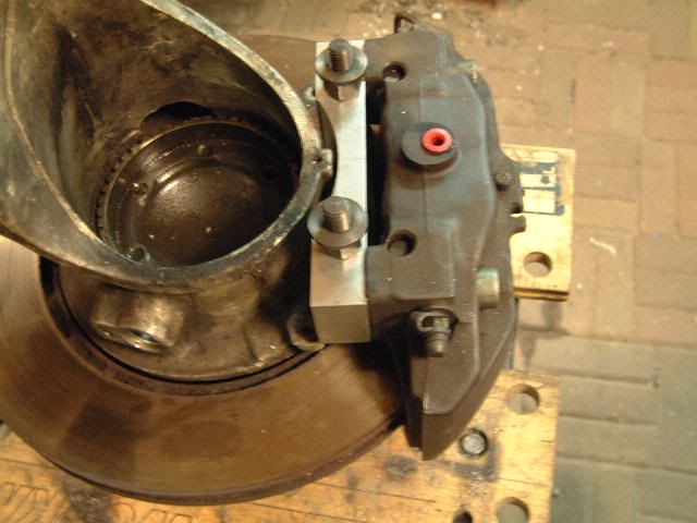

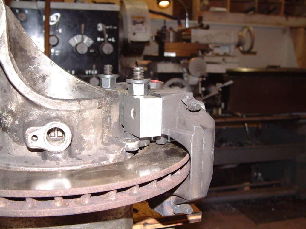

Those are 986 (2.5 or some early 2.7) front calipers. No Boxster S as Boxster S (987) are actually the same as 996 and have 28mm thick front rotors! I have 24mm rotors in the rear, same as front 986. See? ;)
On the front of my bug I now have 330x28mm and I use 996 front calipers for that. Originally 996 fronts are 318x28, but those calipers work very well on 330 too ;)
Progress: adapters made:
