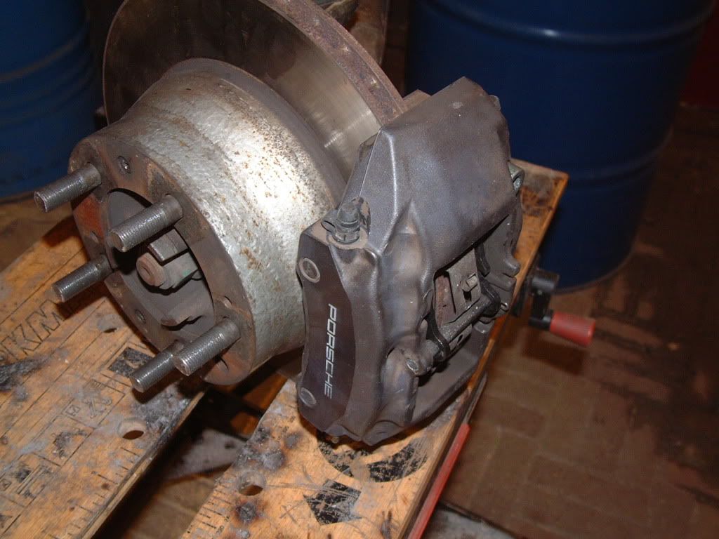

Very nice work Walter. Question, presently I have the 1985 944 rears for both front and rear. Do you feel fix caliper do a better job than floating calipers?
The reason for my question is due to, on my Chevy truck I have floating calipers and the right front wear every time faster and sticks. This is due in large part to the floating caliper design. However, over here fix calipers are hard to find. Unless I want to go to the Porsche junk yard and get rapped by sticker shock:eek:
This is the front caliper on the rear, I feel I can't just use four wheel disk brakes from a 944/front engine, and not try and even out the braking. I have a old, I believe a 1970 911 book, in it, they use pretty much the same diameter calipers on front and rear. Leaving the larger caliper on the front, I feel would cause lock up too easy.
A monoblock or fixed caliper is far better.It has more stability and more clamping pressure and resistance to heat.The resistance to heat without warping is the biggest advantage,because the caliper maintains braking pressure and doesn´t fade as much.
