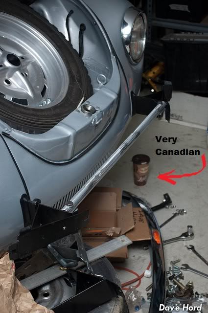

Beginning of bar fabrication:
http://farm8.staticflickr.com/7041/6...47f0285c_z.jpg

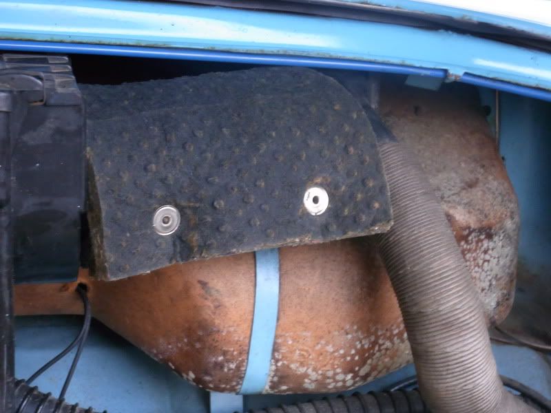

I still had some time before bed, so I took to finishing up some items in the trunk. With the fresh air box mounted, I needed to find a way to join the box to the defrost ducts. Eventually I decided that some aluminized jute padding would probably do the trick nicely...which it does. Problem is it looks like crap! Instead of that space-age look you think it's going to have...it just looks, well, cheap. I know the factory used plastic tubing on the inside, but none of the bits I had fit very well. On the plus side, tonight was the first time I have ever turned on a working Fresh-Air fan that I remember. WHOA!! there actually is some serious defrost air flow! Definitely did not expect that.
http://farm8.staticflickr.com/7184/6...d4800b8c_z.jpg
chug_A_bug March 13th 2012 06:37
http://i41.photobucket.com/albums/e2...z.jpg~original
Nice work on the rally Lights too man.. could always put some Spray foam in the bumper and shape it and then put that Plastic dip over it....I think it would Help with vibrations and abit of Aero ;)

owdlvr March 13th 2012 13:53
http://i41.photobucket.com/albums/e2...47f0285c_z.jpg
hahahahahaha, so true.
I don't need a beer tap in my garage, I need a Tim Horton's dispenser.
