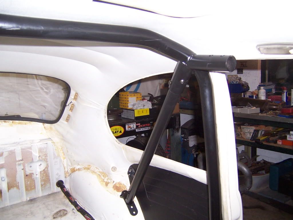

In the meantime, the Heigo rollcage came in and I test fitted it today:
It really fits nice and is very close (good) to roof and the A- and B-pillars.

volkdent January 13th 2010 15:47
OK, I REALLY like that fit, do a have a shot of the distance to the roof? Is there a US distributor for HEIGO?
Wally January 13th 2010 16:04
Yeah, here it is, but dificult to see because of the very contrasting white headliner and flash...In reality its snug against the headliner. I had to specify steel sunroof or not. Its that critical. Piece of german 'kwalität' ;)
Sandeep January 13th 2010 16:50
That cage looks fantastic Walter, superb fit.

The weight wasn't too bad either: the package was heavy as fock but the certificate showed it was 'just' 35kg's while I expected like 50 or 60 kg.
I think I'll just add one bar behind my head to mount the drivers side harness onto.
Jim January 13th 2010 18:26
This is very nice and safe addition in your car wally, it will be more stiffer now in the corners!
... and as i see from the photos it needs a little triming in the dash in order to fits nicely!
