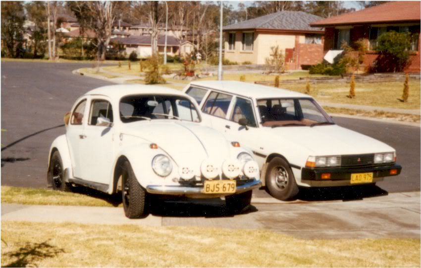

I had an 1963 austerity model bug that I used to do a bit of motor sport with.
It had 2 Cibie Super Oscars in the middle and 2 Oscars on the outside pointing out a little to look around corners.
http://i1184.photobucket.com/albums/...a.jpg~original

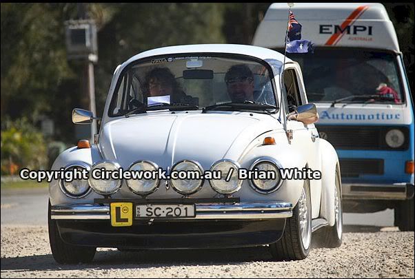

When my son was learning to drive we had to do a few interstate trips, so knocked up a light bar and fitted 4 Cibie Super Oscars.

Is that your GH Sigma there Steve?
Makes me feel old that I'm the same age as one of them :lmao:.
Steve C March 17th 2012 20:06
The Sigma was my wife's car, traded a 68 Type 3 wagon in on it, misses wanted AC.
