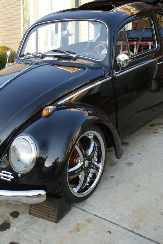

Speed Dreamer April 17th 2010 06:55
Day time pics

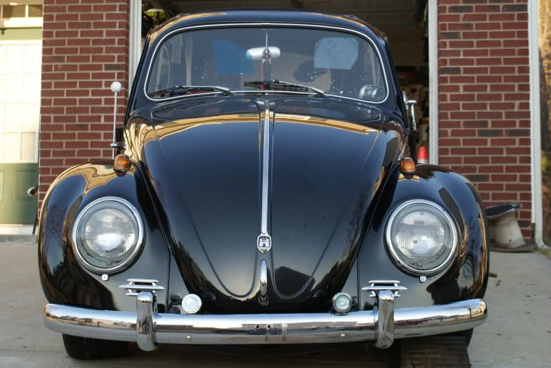

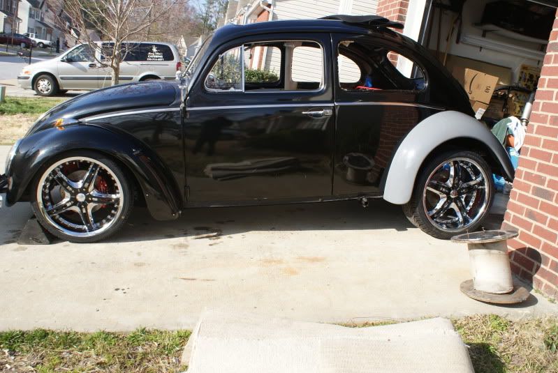

Speed Dreamer November 24th 2010 07:25
One question, short update and more pics

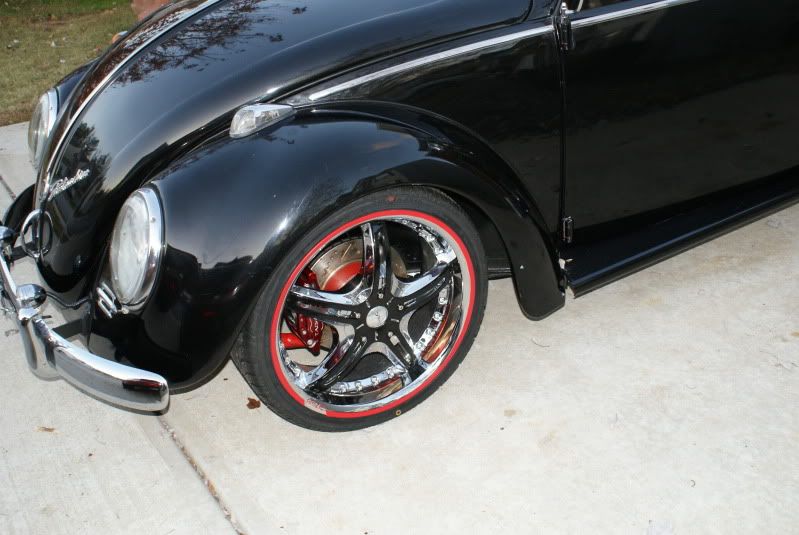

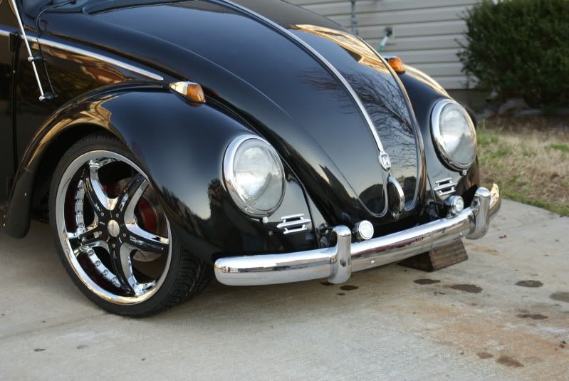

Question ---The question is do I keep the red detail on wheels? Interior is going to be black and red thought red detail on wheels would go good overall.

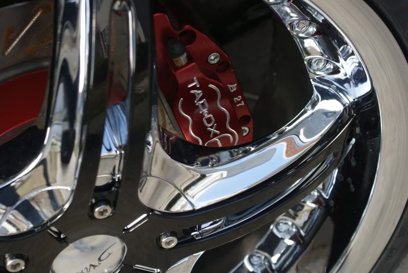

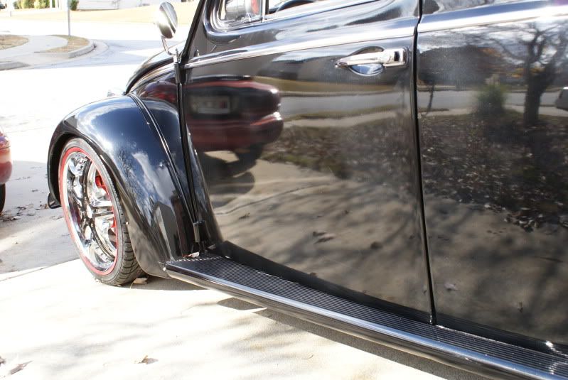

Update---- Rear fenders and running boards painted and install. All new brake components installed to go with new front and rear disc brake kits brake lines, master cynlinder and brake fluid reservoir. Body to pan seal installed and pan now completly bolted down. Transmission still sitting in the garage and engine in the hands of steve sands. After headliner then welding in torque bar mounting tabs. Next on the to do list install sound deadner and send car out to have headliner done.
More pics---

70Turbobug November 25th 2010 15:14
Looks great! The wheels fit excellent! Nice work!
wrenchnride247 November 25th 2010 21:41
I would keep the red accent... helps carry the overall red and black theme.
judgie November 26th 2010 04:28
very cool ride, wheels work well with the red detail.
vdubzack December 2nd 2010 07:46
Love the TAR-OX Brakes. Don't see them often in the states

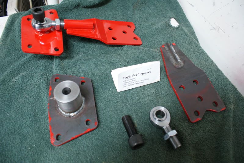

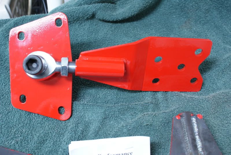

Speed Dreamer February 3rd 2011 07:56
Red accents will stay, Eagle Performance and more pics
First off I would like to give a special thanks to Mrs. Blue for all her love and support I dont think she realizes how much help she has been.
I have decided to keep the red accents for the time being.

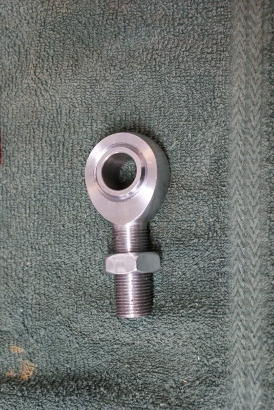

Next on the install list is the coil over conversion kit that I received for Eagle Performance http://www.eagleperformance.com/CoilOverKits.html. I have researched many different kits over the years and finally decided on the Eagle Perfomance Kit. There are more expensive kits out there and ofcourse there are cheaper kits out there, but anyone doing a coil over conversion should definitely check out the Eagle Performance Kit. A friend of mines has a cheaper version without the offset and he just can't seem to get his toe alignment correct, and I have also seen the versions offered without the load boss and I wouldnt feel safe doing any spirited driving with those kits. Started the install a couple of days ago and had a small clearance issue. Gave a call to Eagle and the problem was solved immediately. Will post later with some install details and pics.
