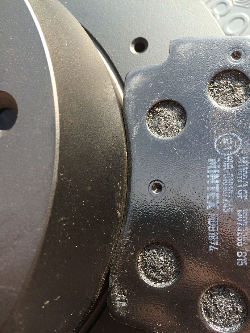

One remaining concern I had was my 944na disc friction surface has a beveled edge on the outside and inside, to the original pad size I think. If the disc was flat to the edge (inner & outer) then it would be a neat fit. I have got new Pagid rotors. Perhaps another brand would not have this bevel (Sebro?). Kai, what brand are yours and are they also bevelled? (The inner edge looks to be more of an issue).

Bruce my Mtec disc also have had a beveled edge. However my mintec pads appear to fit very snugly to my 944NA disc rather well.

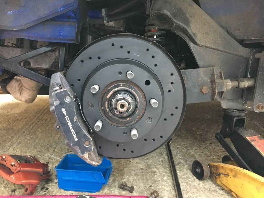

kai4130 January 12th 2016 05:47
Finally have my car back and all the hardware required to fit these brakes. Had an email exchange with Lanner and I can confirm that both me and my mechanic can't eyeball size any thing for **** :lmao::lmao::lmao:
I have used Lanners brackets and hardware, 944 NA Disc brake arrangement, 944 NA Disc , 987 calipers and pads.
it was very easy to swap everything out and Lanners brackets make it a bolt on affair. I did shave some metal off from the inside of the outside pad however I don't think it was really necessary.

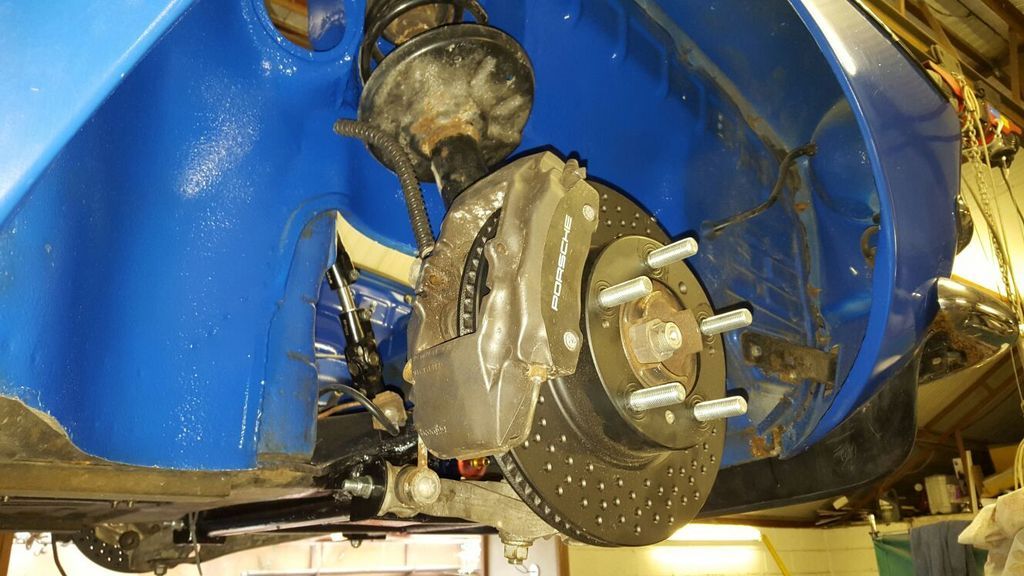

So I've now got the cayman brakes all round on my notch, today's task is to change my master cylinders and get them bleed.

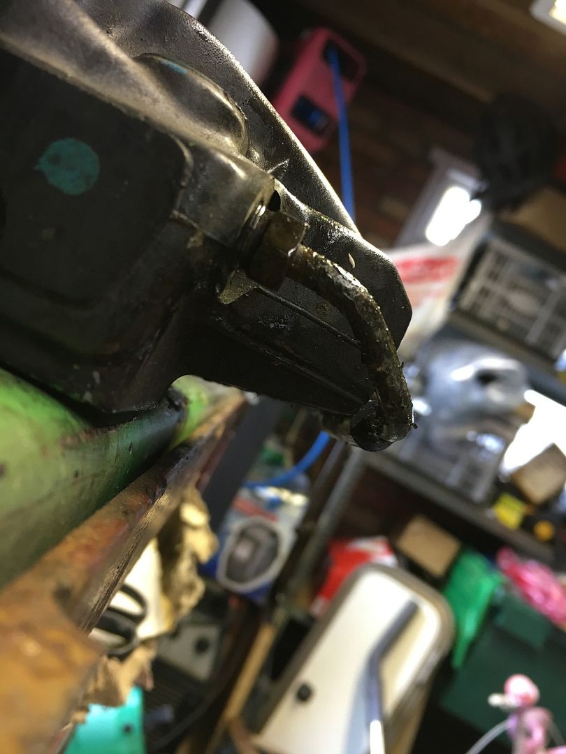

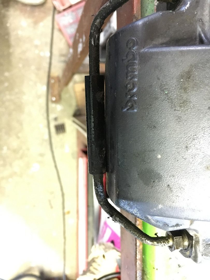

Calipers swapped over.
I first swapped the cross over pipe on each calipers from side to side but repositioned it on the new underside. The lack of recess doesn't prove to be a problem.
http://i16.photobucket.com/albums/b3...f.jpg~original
Plenty of clearance.
http://i16.photobucket.com/albums/b3...b.jpg~original
proudbugowner January 12th 2016 10:26
That's nice then! Good thing you sorted it out.
The smaller piston needs to be on the side where the rotor 'comes in' so that the larger piston can compensate for the torque applied on the pad by the rotor. This causes an even wear on the pads, which otherwise would wear at an angle.

I've done the pipe swap recently (side to side and end to end, as the "legs" are different lengths). I used a heat gun to release the stuck nuts because the alloy expands more than the Steel nut.
