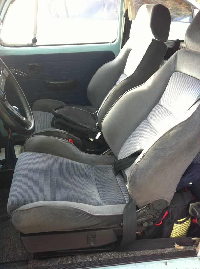

Recaro Seats
Also forgot to mention I made a welcome addition to my interior. Recaro seats from a MkII gti/gli. The perfect mix of comfort and support. I welded a couple pieces of flatbar to a stock set of seat bases and the seats bolt on to those. This puts the seats at a perfect level.
http://i150.photobucket.com/albums/s...8.jpg~original
Humble October 27th 2011 15:07
Nice shot in the magazine :)
Those seats are one of my fav's, good find!

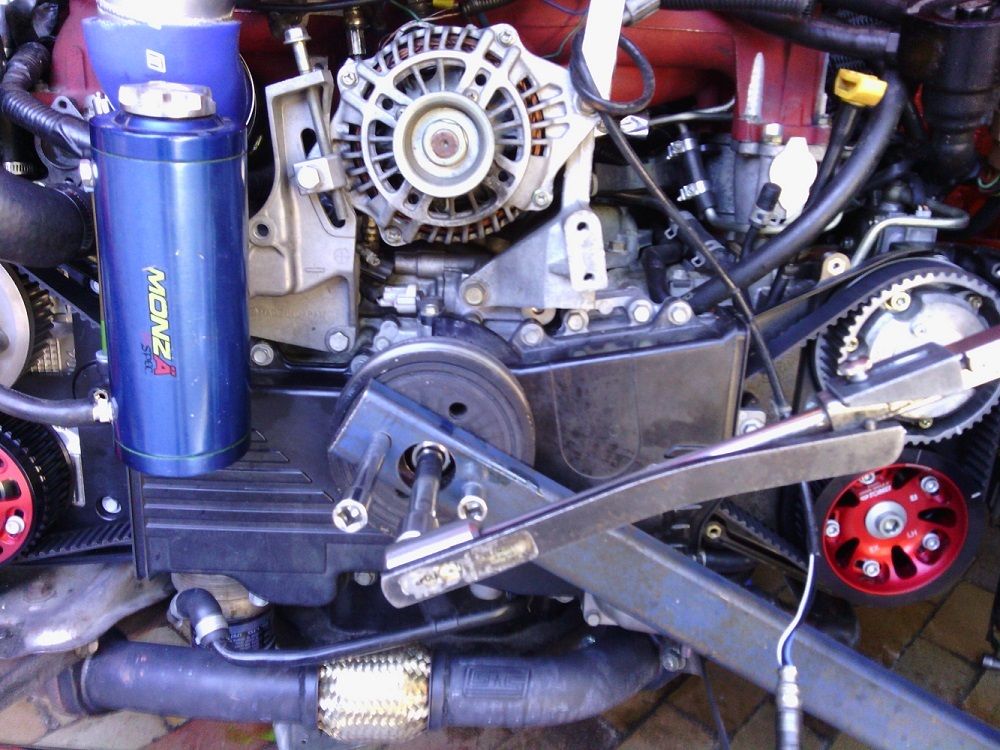

Its been awhile. I like this forum and still check it occasionally. The type 4 motor didn't work out. I was too young and didn't have enough time, money or experience to make it happen. Now is a different story.
I am currently in the process of installing an ej22 motor from a 1993 Legacy into my bug, and just wanted to share some of the things that I have done to make it a clean install. Currently I have the wiring harness done, but not shortened and fitted to my car. I am in the process of fabricating the exhaust, and making changes to the engine that will be handy later. I will let the pictures speak for themselves.
Things I have knocked off the list
Wiring harness
Sump stock fuel tank
Run 3/8" fuel lines through the tunnel and into the engine compartment
Shortened oil sump and pickup tube
Reversed coolant manifold (will add pictures later)
Many more things to come
I was rear ended a couple years ago and it really messed the car up. I have most of the body back to where it needs to be, but getting it moving under its own power is my major motive at the moment.
