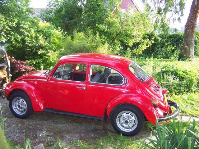

The thread title sais it already, it's a roling rebuild. At the anual check they found a few rusted eareas that had to be repleaced. Both the heat channels had to be replaced and the rear floor was also rusted under the battery.
http://i129.photobucket.com/albums/p...6.jpg~original
http://i129.photobucket.com/albums/p...4.jpg~original
http://i129.photobucket.com/albums/p...5.jpg~original
http://i129.photobucket.com/albums/p...7.jpg~original
http://i129.photobucket.com/albums/p...2.jpg~original
This kind off job should be done with a complete body off resto. But it can be done with the body on the chassis. Instead of the regular rubber or closed cell foam I used weldseam sealer between the new heaterchannel and the new floorplates.

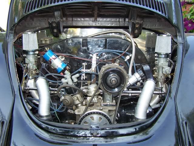

The next motor was a 1641 cc. with a dual Solex 34 PCI setup from Riegert.
http://i129.photobucket.com/albums/p...8.jpg~original
The stainless firewall was a temporarely solution to hide the green engine compartment. All my friends said it was even more ugly than the green paint.
What I wanted to show in this post is something that has never happend to me before an d I hope will never happen again. When I went to a specialist to fine tune the Riegert carb setup something happend when he was almost done. Suddenly the left carburator was'nt responding to turning the mixture screw. He send me home and told me to see what's wrong. So I drove home (a few miles) and started to remove the intake manifolts and carburators. When I looked inside the carburator I noticed that there was a jet missing.:eek:
http://i129.photobucket.com/albums/p...3.jpg~original
Threre is only one way a loose jet can go. I expected bent valves and, and. To my suprice the jet was still in the intake port of the cilinder head. It was'nt even damaged.
The problem with this jet in the venturi of the 34 PCI Solex is that if you tighten it to hard the mixturetube brakes off wich is the end of the carburator. I used a little bit of Loc-Tite to solve this problem. My advise, use a little bit of Loc-tite on every nut /bolt and jet that can fall into youre heads.

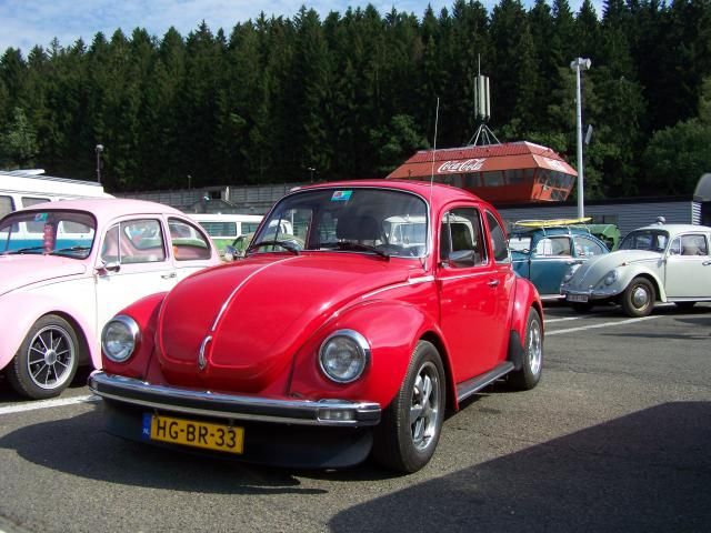

Hello GL fans. I still have the black '75 and its still a lot of fun. But I wanted sometyhing more family friendy. So I bought another '75 1303.
Restored by previous owner to stock specs.
http://i129.photobucket.com/albums/p...f.jpg~original

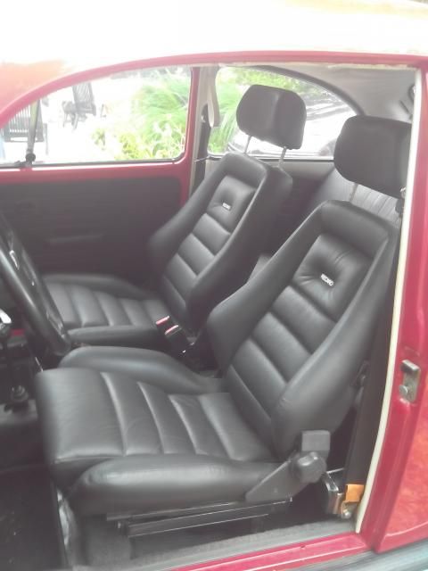

I replaced dented bumpers, installed popout's, new runningboards, TMI Black carpet, Leather Raid steering wheel, electric windowwasher, audio upgrade, H4 headlights, clear indicator lenses, leather Recaro seats, Original Kamei spoiler, lowered suspension and mounted 7x15 rear and 6x15 front original Fuchs wheels.

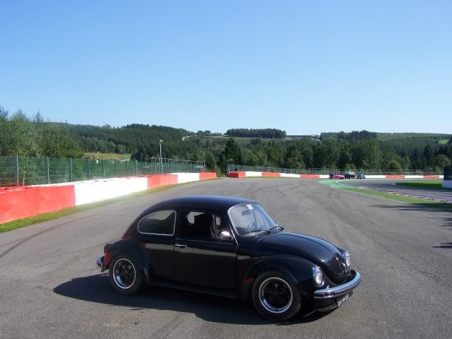

It looked like this at Spa 2014.
http://i129.photobucket.com/albums/p...9.jpg~original

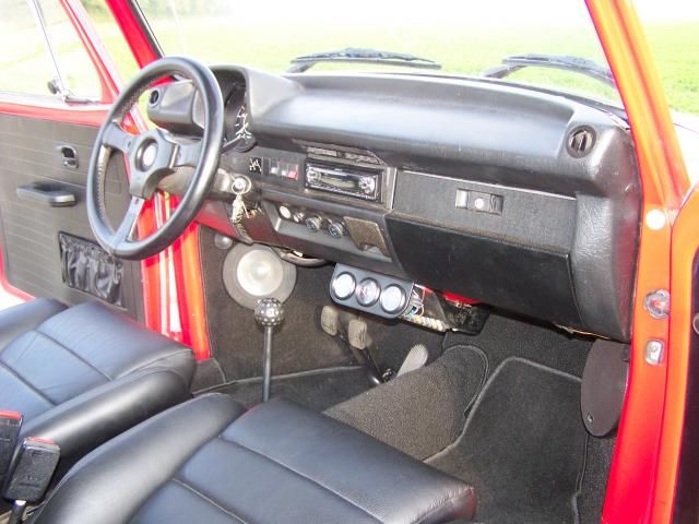

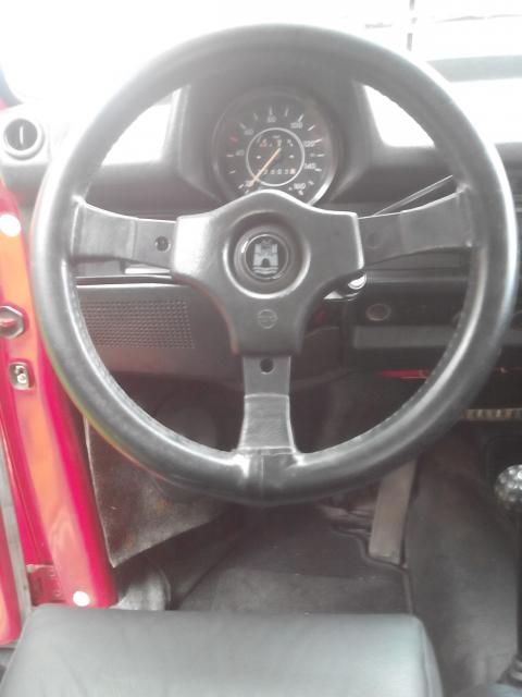

New carpet, oil pressure and oil temperature gauges and head temp. gauge.
http://i129.photobucket.com/albums/p...d.jpg~original

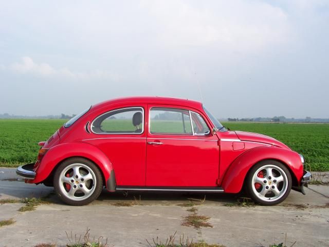

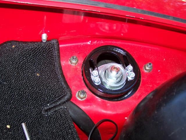

Right after the Spa meeting I started on the suspension and brake upgrade.
Front.
KW inox coilover set. Home made camber plate. 944 NA spindle (with hole for speedo cable) with custom bearing spacers. 944 S2 hubs without ABS. 944 turbo '87> brake rotors. 2006 Boxter S calipers on home made axial > radial adapters. 993 Cup-2 7Jx17 ET-55 Goodyear Eagle F1 195-45-17 under stock wing.
Rear.
944 S2 torsionbars, koni yellow shocks, urethane bushings in trailingarms and for torsionbars, 944 NA hub on 1303 IRS. 944 turbo '86 brake rotor. 2006 Boxter S calipers on homemade adapters. 993 Cup-2 8Jx17" ET 70 Goodyear Eagle F1 225-45-17 under stock wing.

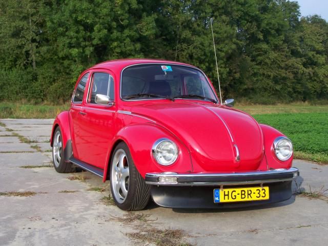

How it looks today.
http://i129.photobucket.com/albums/p...0.jpg~original
http://i129.photobucket.com/albums/p...1.jpg~original
Next upgrade will be a 2 liter type 4 with CSP python exhaust.
