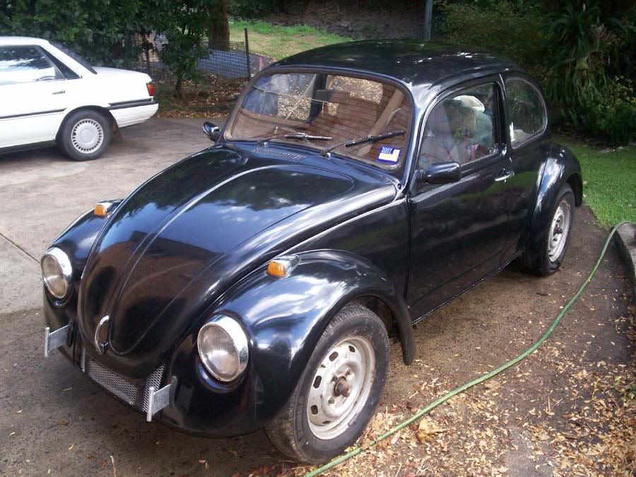

Rob, what have you got in terms of vent openings into the radiator?
on my black 70 just had 3 holes cut out as big as possible and a small scoop underneath but it didnt hang down real low
http://i226.photobucket.com/albums/d...5.jpg~original
also what is the setup with your pipework?
metal pipes underneath in the road draft have a huge effect on cooling
