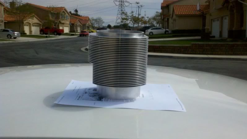

effvee March 20th 2011 03:52
Skirt of the Cylinder
Hi everyone, question, at the bottom of the Cylinder where it goes into the spigot. I have noted some cylinders having a machining out a dish like shape. What is the removal of metal for? These are not my cylinder that I am having made, but very close to them. My fins will have the same diameter the entire lenght.

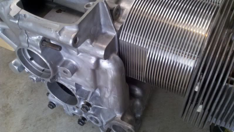

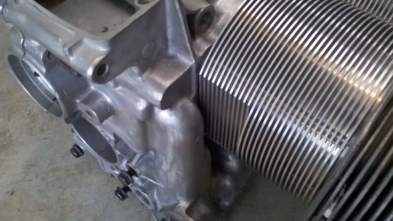

effvee March 25th 2011 23:24
My Cylinders
Hi, well the machinst finished them. I told him to only machine one of the four cylinder with the clearence for number 3 cylinder, well he did all four the same way:o
these are for my 88 stroke engine
see the machining at the spigot end? is this madatory?
I will have Costa Mesa R&D finish hone to spec's i'll select a 12Ra and cyro treat them before I send them to U.S. Chrome.
See the botom of the cylinder, should'nt I have a cutout for the counter weight to pass by?
Wally March 26th 2011 03:54
Nice! I don't think a cut-out is neccesary when the spigot depth in the case is equal or less then that part of the cylinder.
AFAIK, the spigots are normally there for a little smoother internal case breathing when the piston comes down.
What alu type did you end up with?

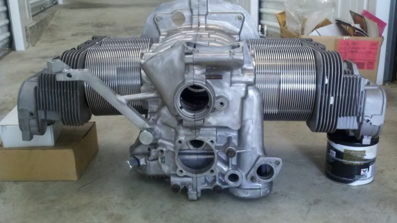

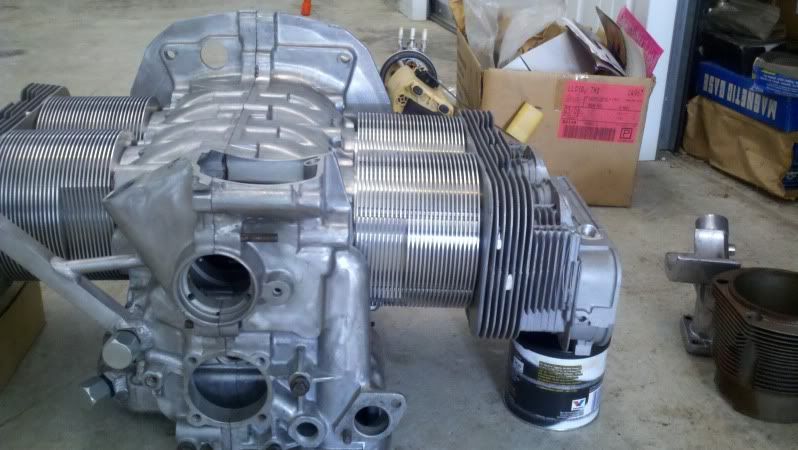

effvee March 26th 2011 20:21
Just had to see how they look
Hi, well I went to my storage unit today. I just had to see how the cylinders looked moked up. I could get use to seeing that coming together, and it being my:D
I thought that only the #3 cylinder would need the releif cutout, but by my fins being the same diamter all the way down; it would seem that the #2 cylinder releif was a good thing there to:)

70Turbobug March 27th 2011 13:04
They look great Francelle! Excellent machining and design! I´m really anxiuos to see how they will hold up! Good Luck and keep us posted!
