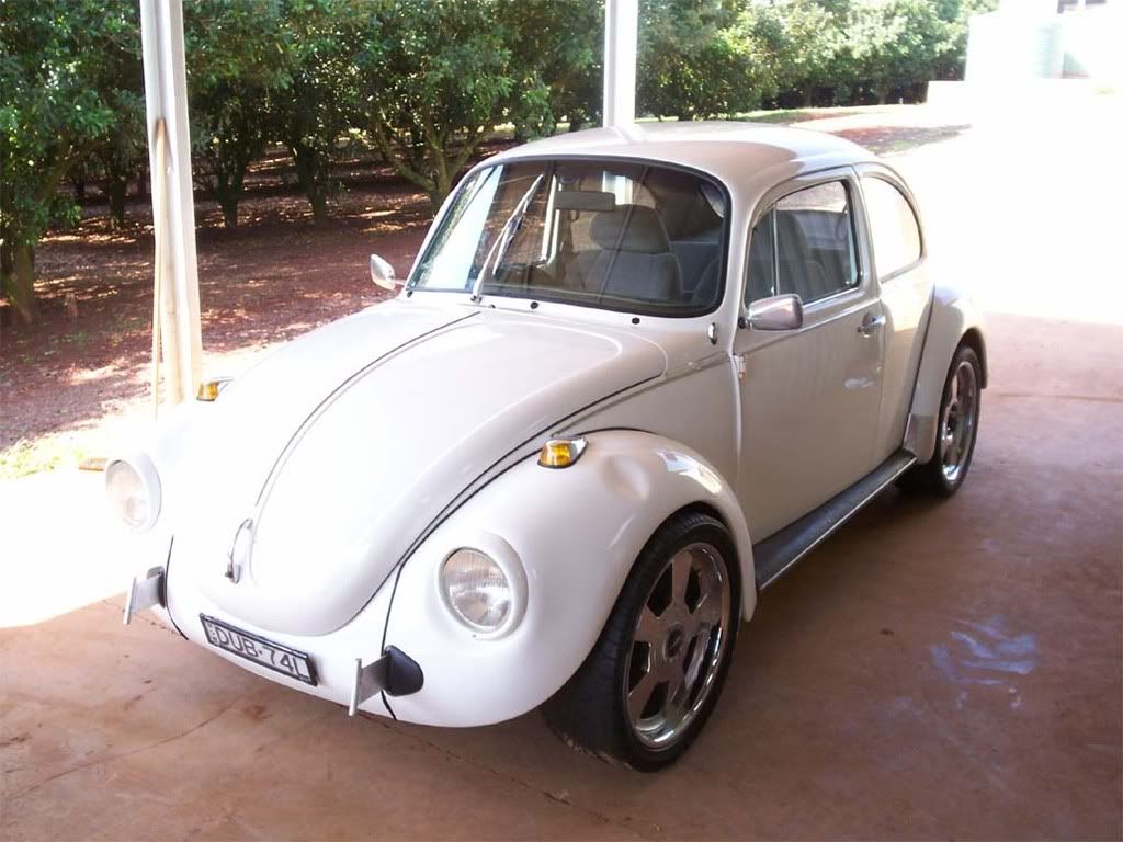

i had a single wiper conversion for a while
i just cut down a flat screen beetle wiper motor so it was only one shaft and mounted it to the LHD mounting hole in the center with a stock 1303 wiper just with the bend straightened out
i also changed the arm arrangement so it parked in the vertical position
it gave great coverage but i had to return it to stock to keep the local authorities happy

I'm going to stick with dual wipers as the engineer that has to pass my car has said that the duals have to stay.
What I'm thinking of doing is altering the pivot ratio on the passengers side of the car so that it does a longer sweep, this is on a 1303.
Joel October 12th 2008 07:16
Steve, thats what i did when i had the single wiper to get to cover the whole screen
i chopped 5mm out of the spindle crank
