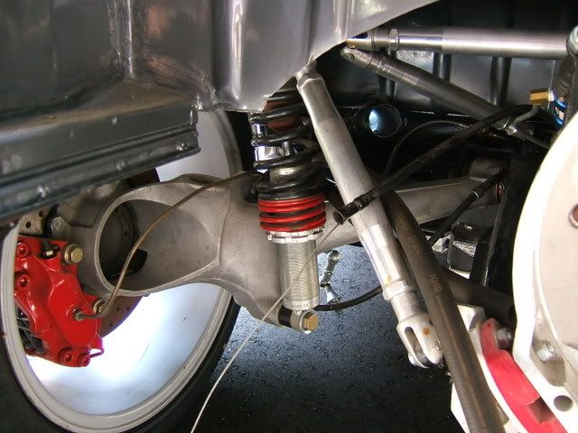

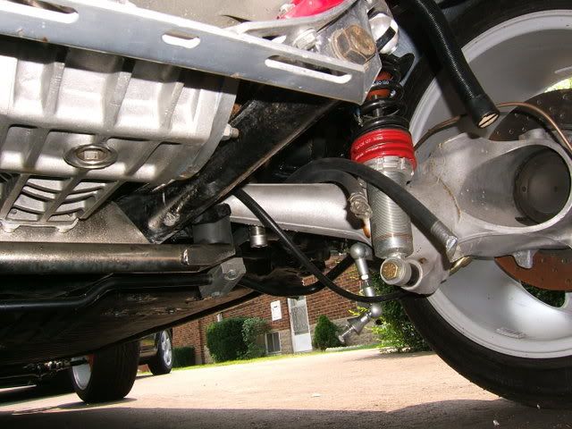

petevw August 7th 2007 00:37
I'll bring it back too.....
Was working on mine this weekend and ran into a few problems.
Couldn't lower the rear lower more because the spring hits the trailing arm. So i pulled the bolts to see if i can space it out some more and found the threads to be damaged. Could be wrong bolt or stripped thread. :(
What is the thread inside the 944 AL trailing arms?
I was thinking of spacing out the coilover further out another 1inch. Could a longer bolt be a problem. Would it flex or break?
pics:
