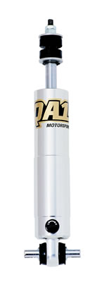

If you contact QA1 I'm sure you could get a pair of these made with the threads for a coilover. Looks like it would bolt right on to a BJ front end after removal of the lower bar and the addition of some sort of sleeve.

follow up to QA1 coilovers...
Is anyone running these on their street car? I am interested in how these are setup, they look nice, what springs are being run? anyone?
volkdent April 24th 2008 16:14
I have them on the front of mine, can't remember what spring rate, so far so good, still playing with the tuning, but I'm not going to waste too much time until the correct springs are in.
