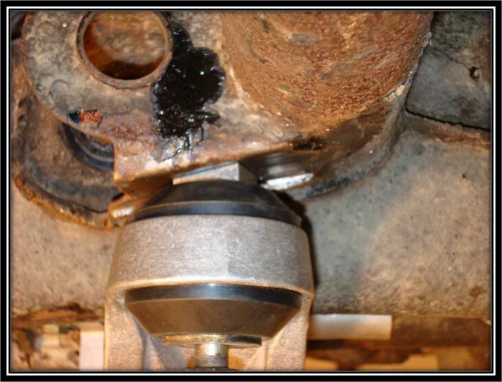

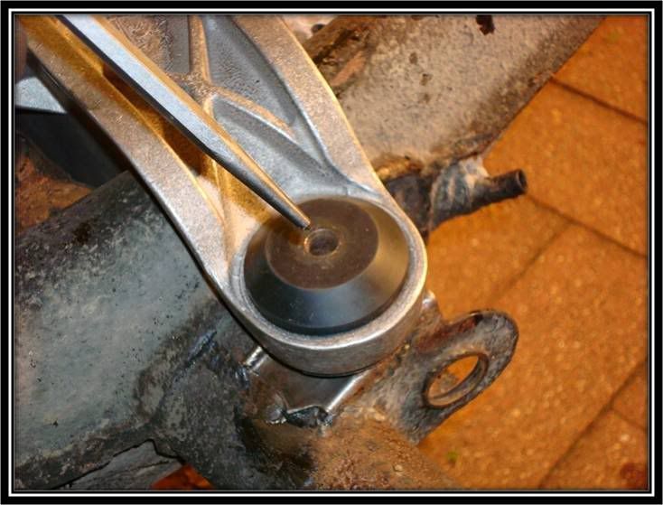

Slide 60- Type I IRS Chassis Prep
A center punch and hammer are utilized to mark the location for drilling.
Starting with a smaller (approximately 6mm or ¼” bit) make the necessary pilot hole
Note: Remember to use cutting oil, and eye protection
Slide 61- Type I IRS Chassis Prep
http://i78.photobucket.com/albums/j1...a.jpg~originalhttp://i78.photobucket.com/albums/j1...b.jpg~original
Final hole will be made with a M12.5 or M13 Drill bit. The Front traverse will be attached to the IRS mounts using a M12 Bolt (19mm), two washers, and the supplied metal wedges.

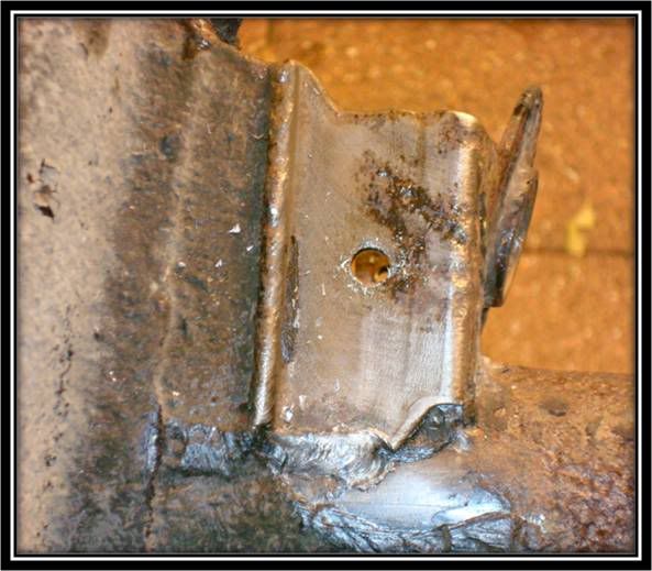

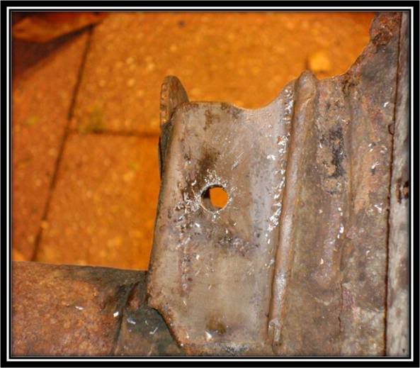

Slide 62- Type I IRS Chassis Prep
The wedges are provided to create a level surface for the mount to go onto.
4 wedges are included in the kit.
Slide 63- Type I IRS Chassis Prep
You will notice the location of the second wedge on the back side of the IRS mount.
Using M12 hardware, secure the bolt with a lock not and some thread lock

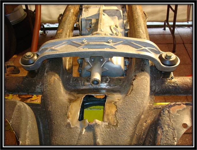

Slide 64- Type I IRS Chassis Prep
Picture of what the under side of the chassis should look like.
With gearbox partially secured and all the trimming, cutting repositioning and clearance now complete, it is a perfect time to check everything once more.

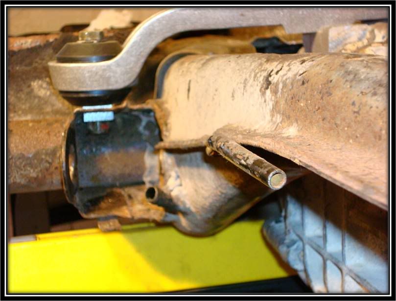

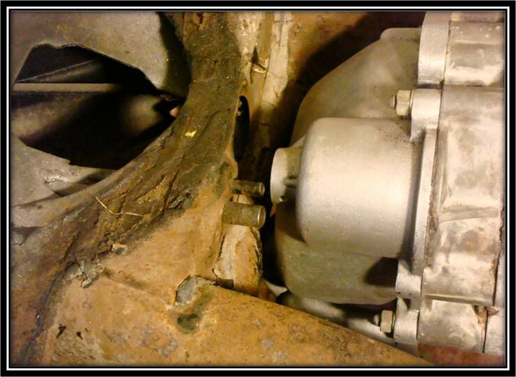

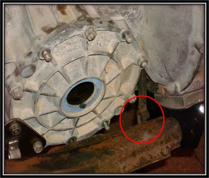

Slide 66- Type I IRS Chassis Prep
You will notice with the gearbox installed that the clutch cable tube that exits the rear of the transmission tunnel is not properly aligned to mate with the new adapter plate
Maintaining this exit angel will cause the tube to interfere with the gearbox, Bowden tube and the clutch cable.
This will need to adjusted/modified.
Slide 67- Type I IRS Chassis Prep
The clutch guide tube is held in place with a strong weld from the factory
Utilizing a metal drill or Dremmel along with a steady hand, break the weld and tube free. A sharp chisel will a great help, too.
Using a suitable-sized punch, metal rod or piece of steel bar, you then carefully bend the tube, thereby realigning the exit angle of the cable. A new spot will be needed to retain the tube at this new angle
Note: Care must be taken to not damage the tube when removing the factory welds, as any dents or kinks may cause clutch cable interference
A trial assembly of the re-routed Bowden Tube (flexible clutch cable conduit) from the back of the chassis is checked on last time. Need to ensure a smooth curve with no tight angles is necessary

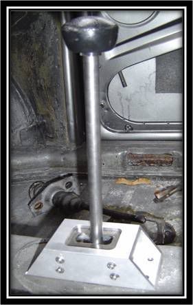

Slide 69- Bug@5-Speed Shifter Install
http://i78.photobucket.com/albums/j1...c.jpg~original
Installing of the shifter onto tunnel is relatively simple
(1) Remove old beetle shifter
(2) Make template of the base of the Bug@5-Speed Shifter, and trace this onto tunnel
(3) Using a cut off wheel or similar type tool cut the necessary 50 x 78 mm for the new shift lever into the tunnel
(4) Finish off by grinding edges to crate smooth finish
Slide 70- Bug@5-Speed Shifter Install
Next, you will need to tap 4 holes onto the tunnel to install the supplied (4) hex bolts
Lastly Install shifter as shown in pictures onto the tunnel and secure utilizing the (4) hex bolts
Following instruction in shifter guide for adjustment and alternatives modifying the beetle tunnel shifter rod

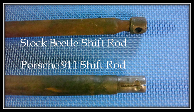

Slide 71- Bug@5-Speed Shifter Install
http://i78.photobucket.com/albums/j1...a.png~original
Here you see the difference between the factory stock beetle shift rod, and the 911 shift rod option.
Lower picture shows where the Porsche coupling would slide into the 911 shift rod.

New pics of the Bugat5speed Inner Shifter rod (Slide 15), Modified TOB Fork (Slide 16), and a few pics to show the difference between 911 and Beetle Shift Rods (Slide 71: The one in the tunnel)
