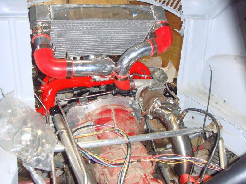

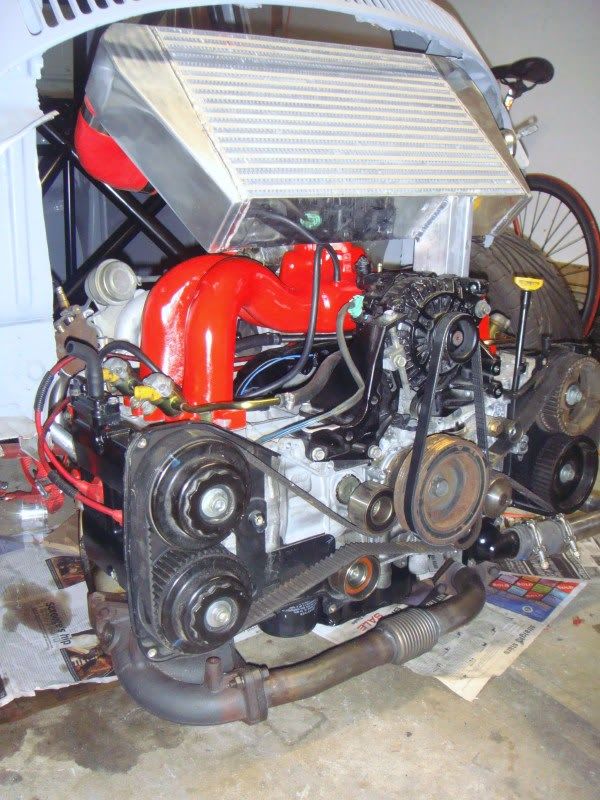

And some ducting for the intercooler which is going to be fed by to NACA ducts and 3" flexible hose in the rear window. Started on the rear firewall. That is going to be a big task.

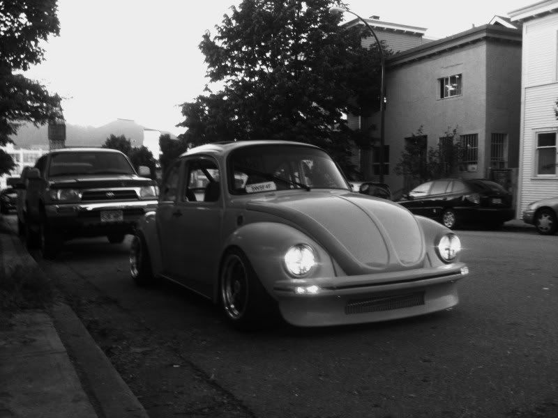

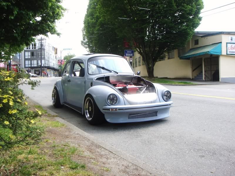

Took it for a spin on the street. The hippies on Commercial Drive loved the sound of the rev limiter in second gear:D
http://i7.photobucket.com/albums/y25...5.jpg~original

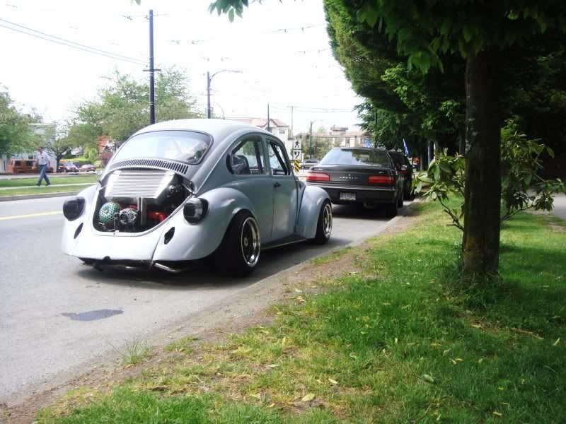

Also made a matte black front and rear windscreen banner and attached the running boards. Rebuilt the alternator as it wasn't putting out a charge. Changed my spark plugs to one step colder copper ones NGK BKR7E. Made a wiring cover and tidied up some more wiring. Now to finish the exhaust to keep the neighbours happy:)

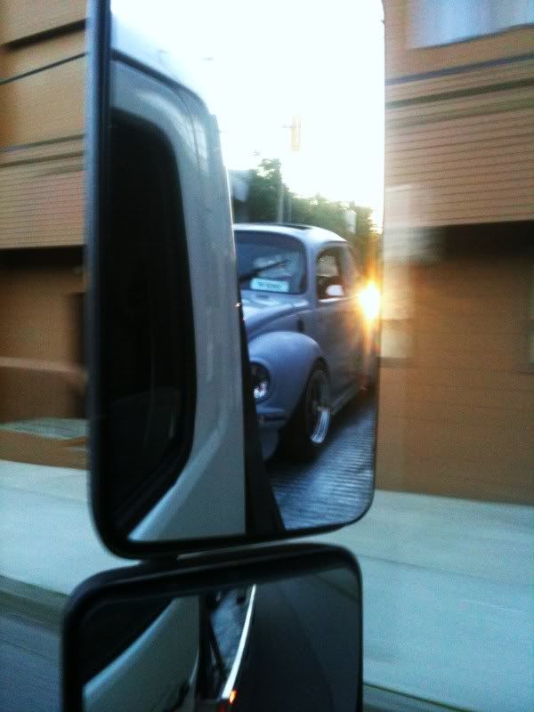

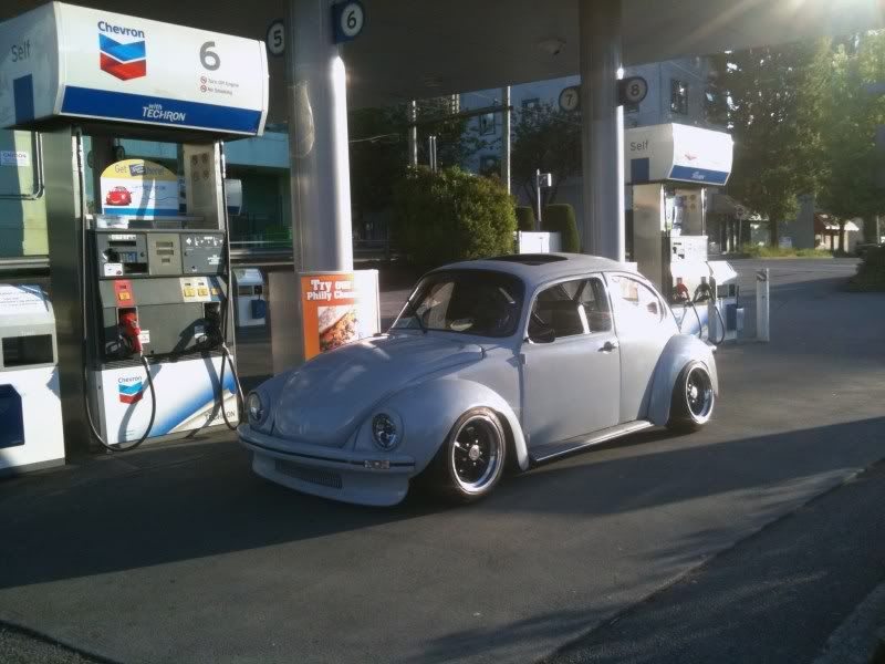

Fuelled up and a day permit ready for the open road....
http://i7.photobucket.com/albums/y25...6.jpg~original
http://i7.photobucket.com/albums/y25...0.jpg~original
Stopped along the way to take a few snaps.

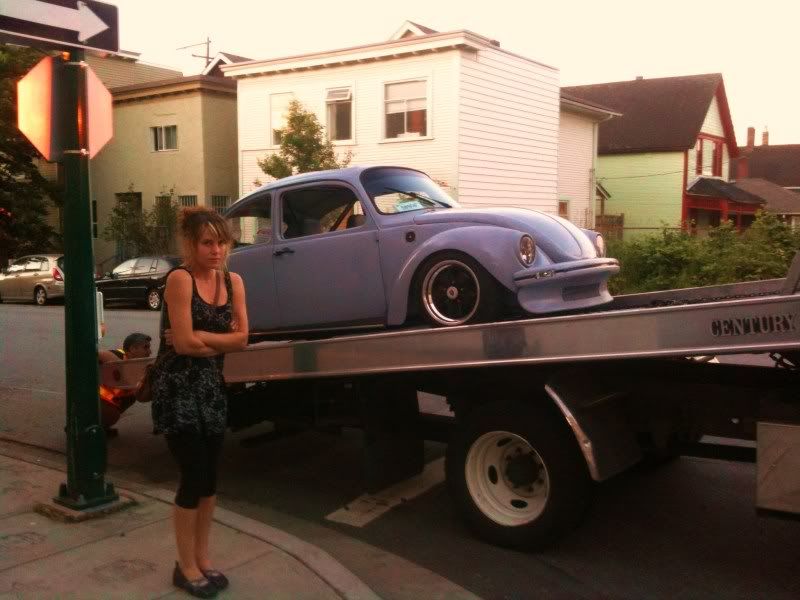

Girlfriend look really impressed. Battery flat/plugs fouled/rear suspension arm failure.
http://i7.photobucket.com/albums/y25...4.jpg~original
AHHHH:mad:

rear arm failure???? what happened??
i agree the girlfriend look ssssssssssssoooooooooo impressed there lol

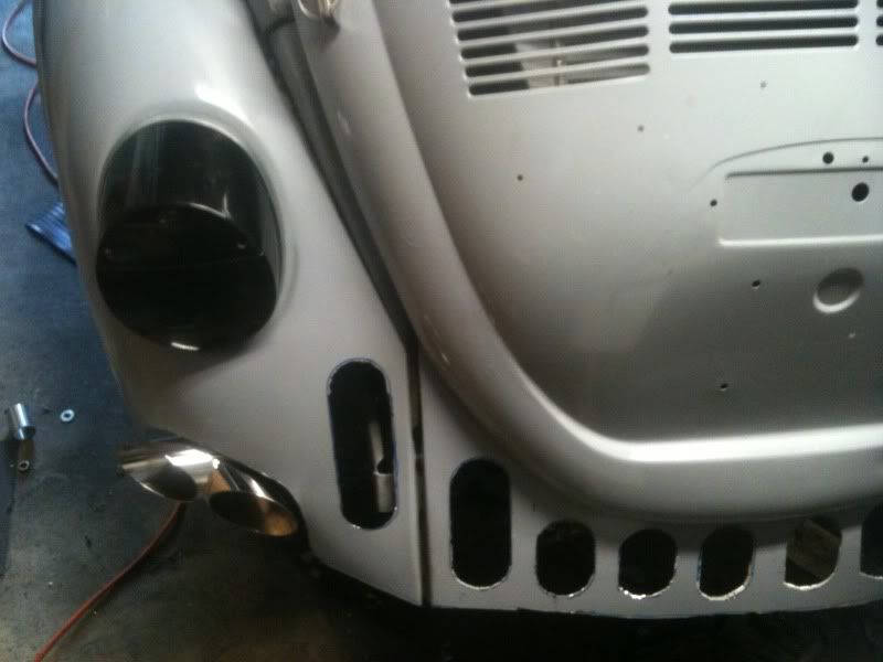

Some Updates.
Cut some speed holes in the rear apron.(Not quite finished yet) Made a 3" exhaust with 2 3" tips.
No muffler yet:D

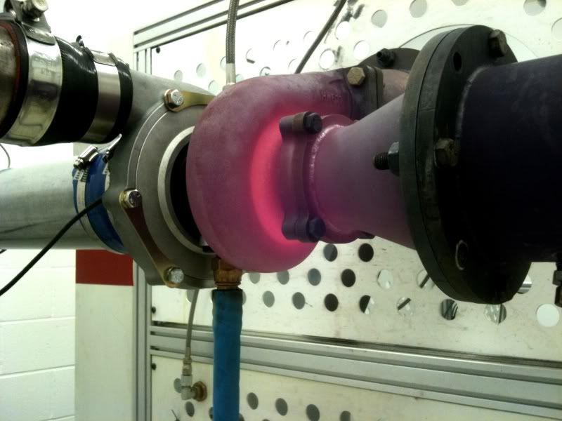

Started a position at my old work. Test Stand Technician. This picture is of a Rotomaster GT30 being tested at 900deg.C This turbo was headed to an aircraft engine. 5L flat 4. Aircooled too:)

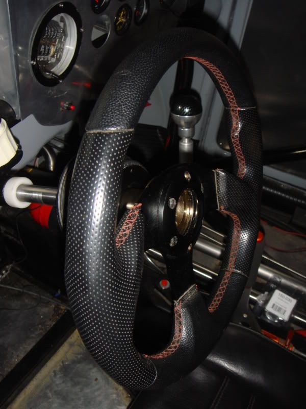

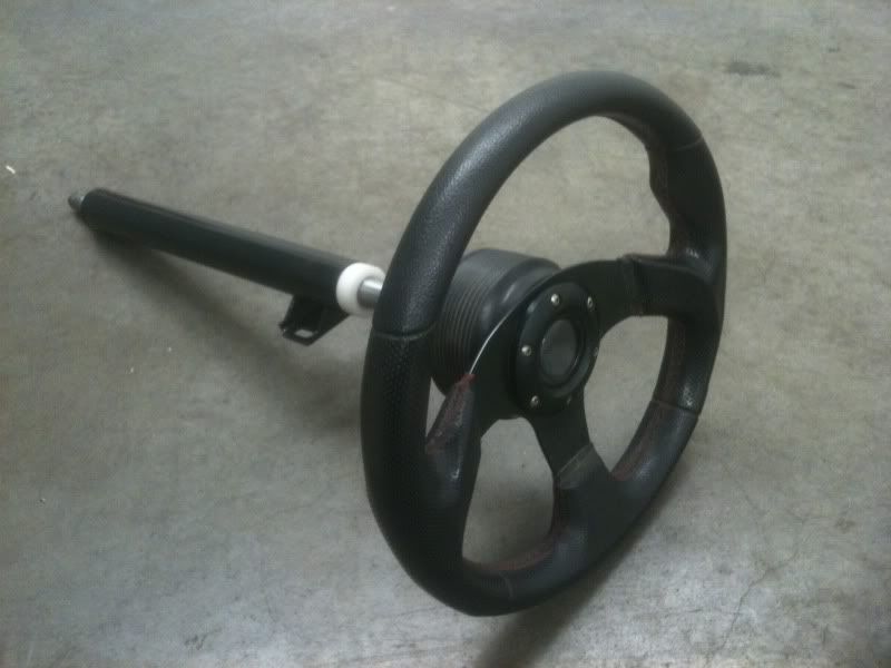

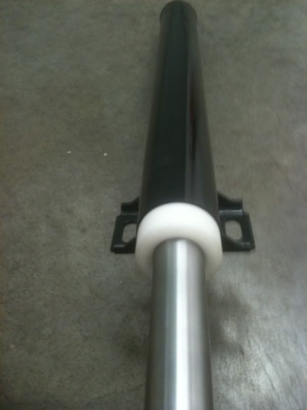

Made some improvements on my steering column. Plastic bushings on the top and bottom of the steerer tube replace old bearings and rubber bushings. Also turned off the steering lock part of the shaft.
http://i7.photobucket.com/albums/y25...7.jpg~original
I just need to get rid of that cheesy steering wheel now.:lmao:
Any suggestions? Nardi? Sparco? Momo?

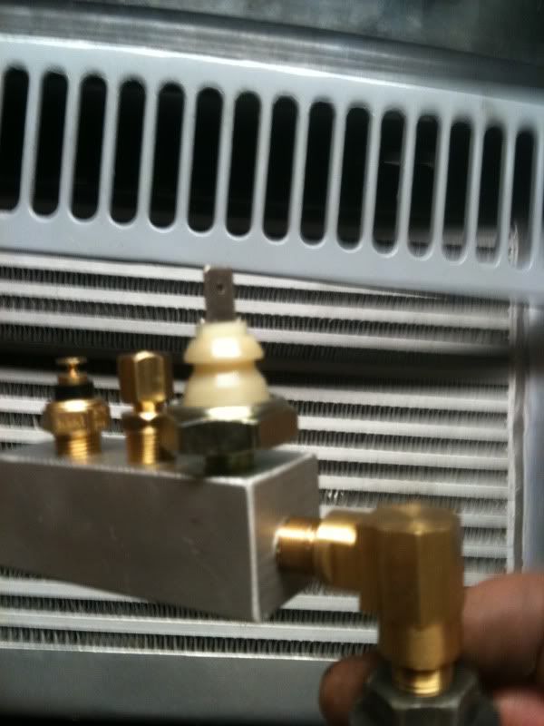

Made an oil manifold that houses idiot light/oil pressure/oil temperature senders.

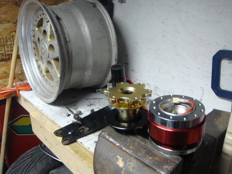

Played around with some quick release steering wheel hubs that a friend borrowed to me. I really liked the colour of the red ball release one but after I installed it I found it had too much play so I will be going with the splined one which was way better.
Going to pull the gearbox next weekend and install the spool:D

Who made your steering column bushings?

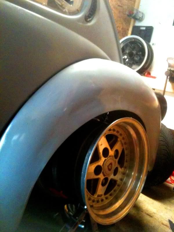

vw1303 February 11th 2012 21:39
Hey Dave,
To fit my rear coilovers I had to do a bunch of modifactions.
I sectioned out some of the rear trailing arm along with adding some gussets to the lower shock mount.
http://i7.photobucket.com/albums/y25...9.jpg~original
Here is a picture of my 5 bar setup. I might revise the attachment to the upper shock mount and fabricate it in steel.
Now for last month I have been a little side tracked doing this.
Put the big lathe to use.
http://i7.photobucket.com/albums/y25...3.jpg~original
These will be the crowning jewels to roll on.:D
