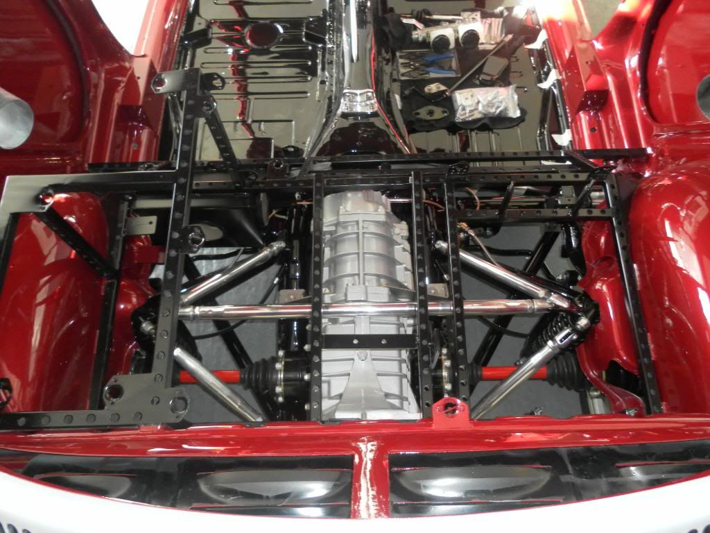

My aim is to debut the car, fully finished, at the Volkswold Show.

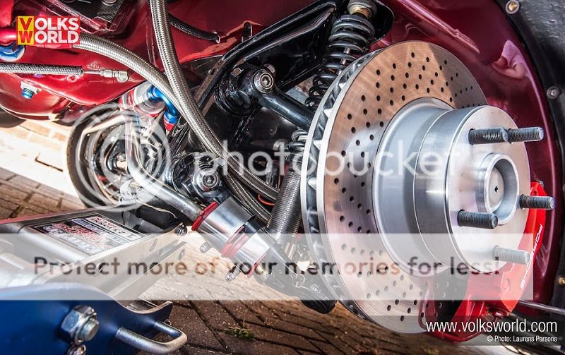

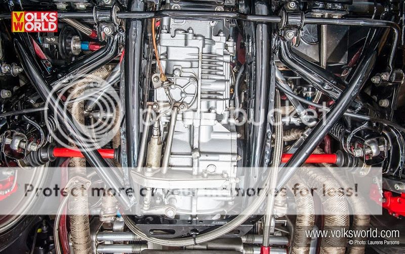

The suspension setup is Porsche rear arms. Unibal setup (I believe to be an American setup that Marco Mansi sourced years ago when the project began). IRS adjuster bolts. AVO fully adjustable coilovers. Front end AVO adjustable coilovers. The beam has been modified to accept special bearings that allow the arms to move independantly a mod by Marco. The top arms have been modified to pull the top of the wheel in to give negative camber. (Trying to be like you 1303 Boys!).
There is a few other tricks in the chassis regarding bracing of the gearbox and frame horns and also the strenghtening of the front beam. All credit for the superb finish of the chassis goes to Mark at Flatlands.

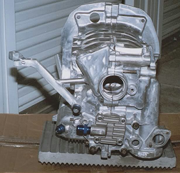

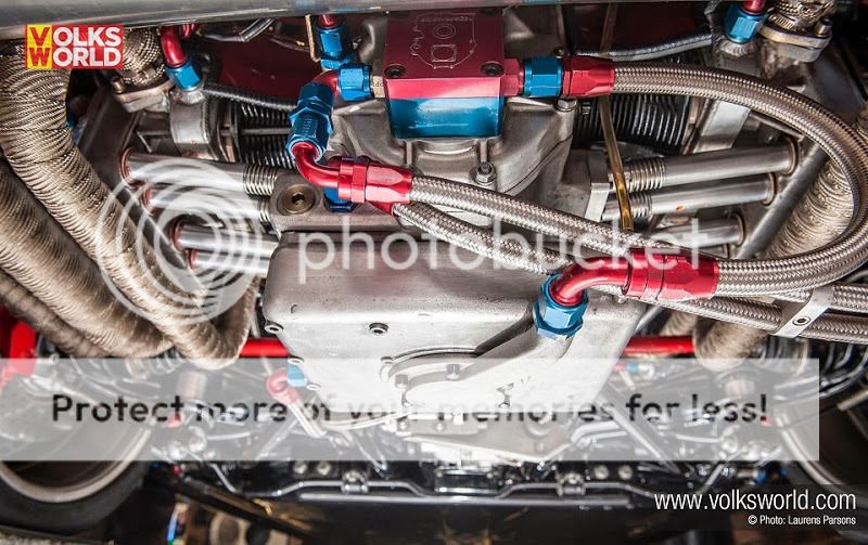

Man, that's one very nice project:). Please allow me to ask a few questions. Is the engine a Auto Craft? The extra sump, or is it, looks low clearance. I'm not trying to high jack this post, just a few questions. Since I added to my type IV case a flange, so I can add extra capacity sump. Since then I looked on the Pauter website and saw the Auto Craft bottom pick up, I just love that possibility. I will be using a Berg 3.5 capacity sump, and hopefully the Auto Craft pick up. But I note the low clearance possibility. The car being shown can go wherever, track or street. But it looks low clearance for the engine. This worries me for my project. Please allow me to show just my case so you can see what I'm talking about. Again, I am not trying to high jack this post
http://i86.photobucket.com/albums/k9...7.jpg~original
