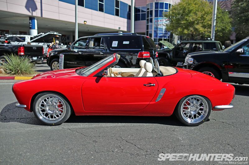

vw1303 October 31st 2012 14:47
If your at SEMA check out the Karmann Ghia with Boxster running gear.
volkdent October 31st 2012 15:15
Oh sweet!!! Any name to go with it or a booth number? I've got the catalog so I can look up the booth number if I have a name.
vw1303 October 31st 2012 15:43
Saw it on Speedhunters. They say its in the outside area of the show.
volkdent November 3rd 2012 02:01
I looked and looked and looked for that Ghia, no dice. I even found the exact spot the pics were taken at but no trace. Looking at the pics some more, they grafted Ghia panels to the Boxster, while the Boxter stayed largely in tact.
I found the build here!
Translog GT
That would have made my job a lot more simple, but the lines of a bug are hard to duplicate, as Volkswagen has learned now with the new-new beetle. I saw the APR one there, it is very understated for having 500hp.

More Ghia/Boxster pics, "Ghia Monster"
http://images.thesamba.com/vw/gallery/pix/987957.jpg
http://images.thesamba.com/vw/gallery/pix/987956.jpg
http://images.thesamba.com/vw/gallery/pix/987955.jpg
http://images.thesamba.com/vw/gallery/pix/987954.jpg
http://images.thesamba.com/vw/gallery/pix/987952.jpg
Jadewombat November 6th 2012 16:53
Incredible. Love the slots on the rear fenders. So many questions though, mostly how the heck did the wheelbase length and width wind up fitting the ghia body. The centering and width is spot-on with the wheel wells.
