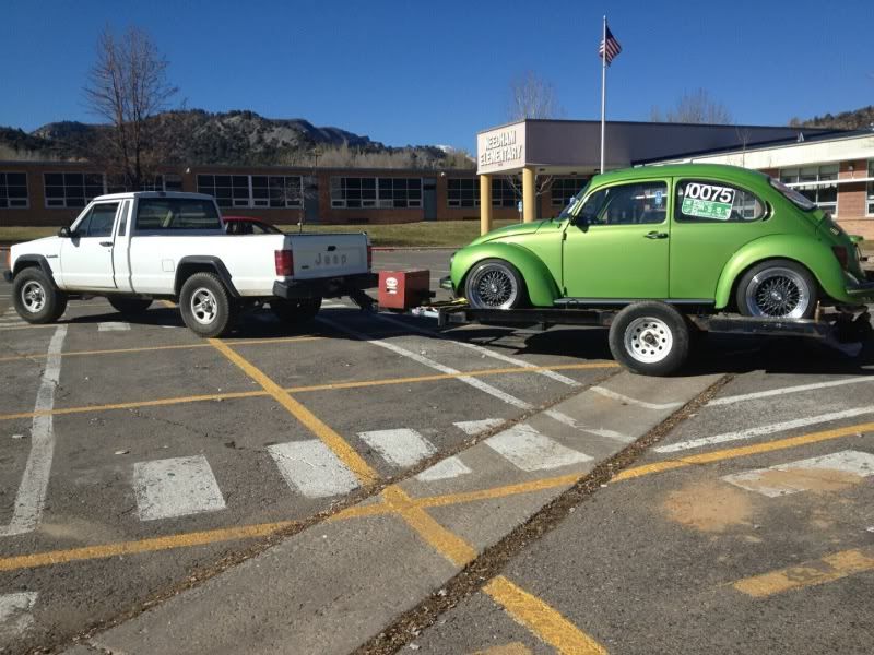

heres me loaded and ready for the big WUSTE vegas euro show.
http://i27.photobucket.com/albums/c1...8.jpg~original

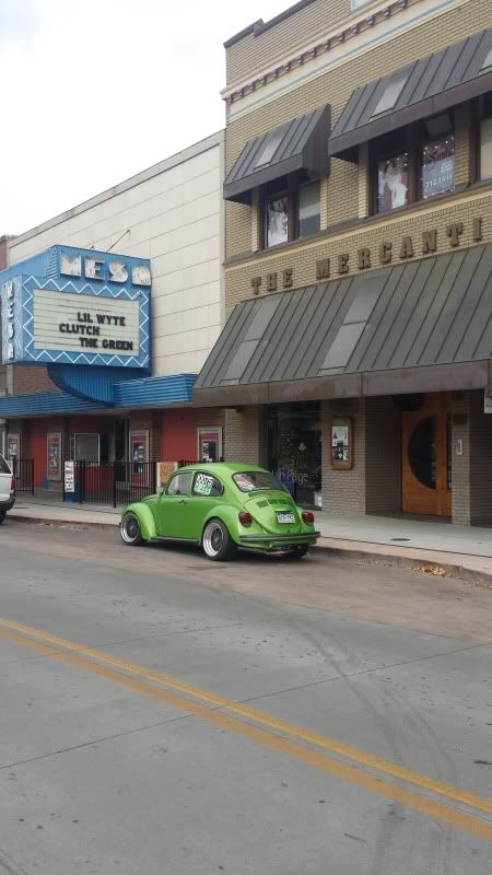

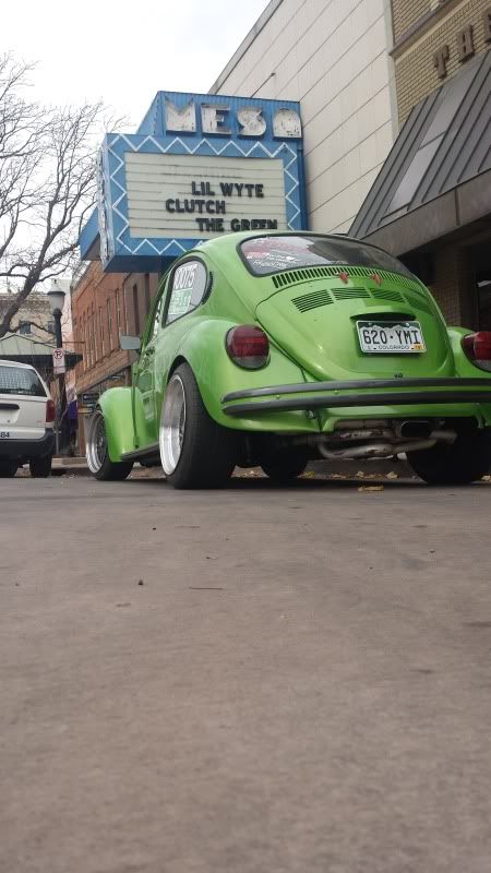

heres some photo shoots that ive had friends take of the car while i was driving around in grand junction. i trailerd the car up to junction and i drove it around town for a few weeks. im planning on relocating up to junction in a few months. so theirs a pic of my cool jeep comanche pulling my bug. the jeep in it self is also another whole project soon to start as well. lol.
http://i27.photobucket.com/albums/c1...c.jpg~original
http://i27.photobucket.com/albums/c1...d.jpg~original
http://i27.photobucket.com/albums/c1...2.jpg~original
http://i27.photobucket.com/albums/c1...7.jpg~original
http://i27.photobucket.com/albums/c1...5.jpg~original
