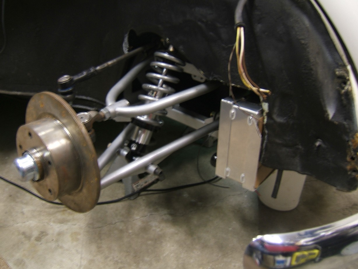

Last night the car finally hit the floor. It's been on jackstands for 3 years now, so it was quite a momentous occasion. Here is the rear end on the ground:
http://www.thesamba.com/vw/gallery/pix/235293.jpg
http://www.thesamba.com/vw/gallery/pix/235295.jpg
I should mention, at this point in time the rear end still has the ability to steer! So it makes this thing easy to move around the garage
http://www.thesamba.com/vw/gallery/pix/235296.jpg

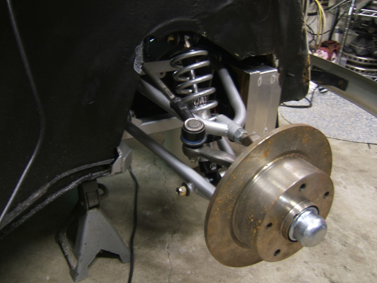

Obviously this is temporary. The C-clamps should do just fine for moving it around, but I put the zip ties on just as a safety precaution.

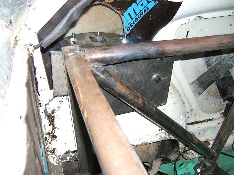

volkdent October 31st 2005 01:16
http://www.thesamba.com/vw/gallery/pix/235298.jpg
Here's my Boo Boo. I had a preview of this over a year ago, but I was beyond the point of no return, so I had to keep it going. The wheel is set back slightly, I'm guessing about 15mm. A longer wheelbase will be better for high speed stability anyway, right?! If I get too upset about it, I'll reshape the front inside edge of the fender to make the gap look better.
http://www.thesamba.com/vw/gallery/pix/235299.jpg
This one is a little fuzzy, sorry. Better pics to come.
http://www.thesamba.com/vw/gallery/pix/235300.jpg

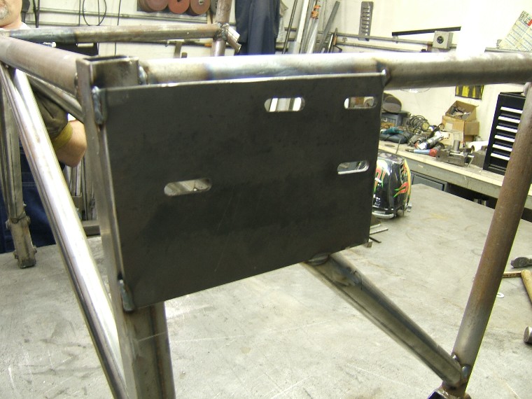

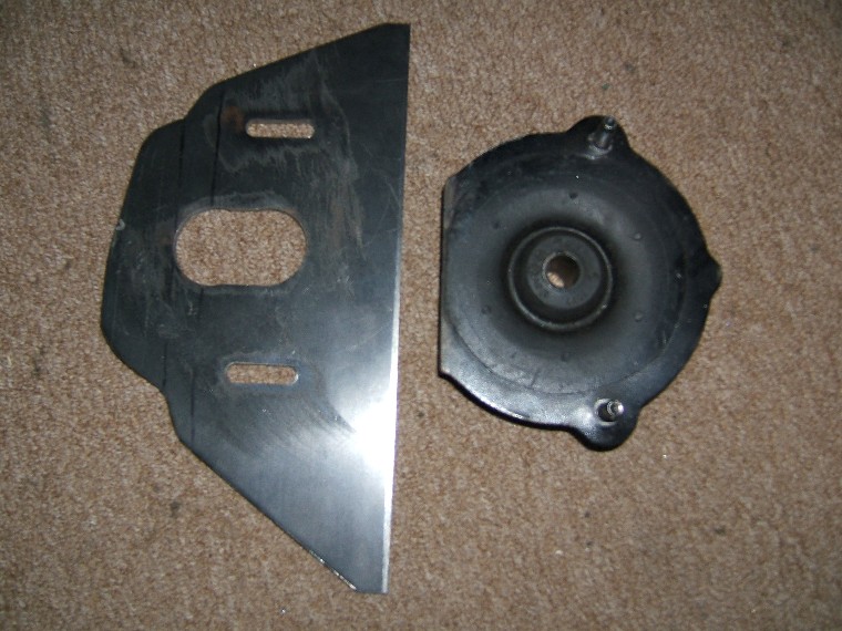

I went down and talked to Walt on the clock today. In a way it's nice to see him sweating over the details. I was just not getting anywhere, and I think he'll be able to get us a great result. I can breathe easy for a bit till it's done. Apparently the wiring harness(now from another source) will be arriving tomorrow and the radiator this week as well. Things are starting to move along.
Here's the plate that may be used for the strut mount, but the whole idea may be scrapped due to spacial issues
http://www.thesamba.com/vw/gallery/pix/237712.jpg
volkdent November 20th 2005 18:26

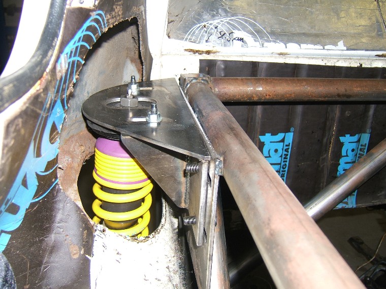

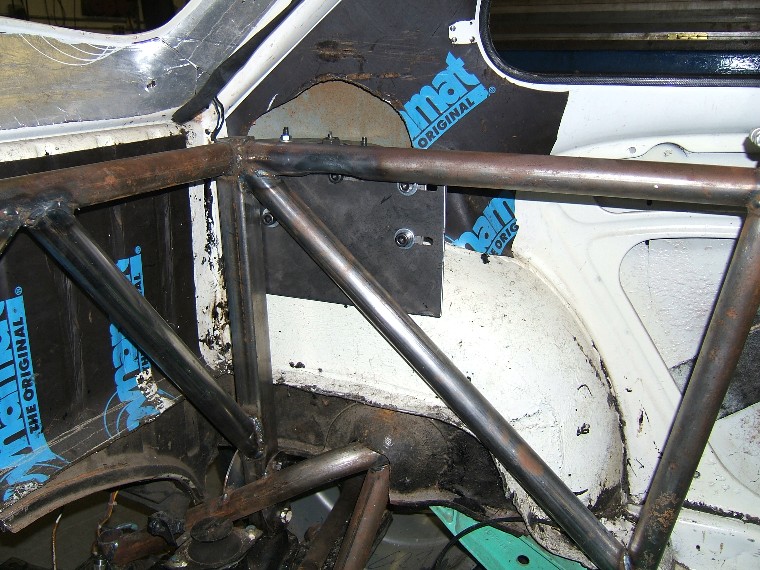

Well, she's back home now. Walt did a great job on making these strut mounts. There is adjustment for strut angulation front/back and then there is camber adjustment. Everything is tacked up, so I'll need to pull it all apart and do the final welding, throw on a coat of paint, then get the motor back in and see how she looks.
http://www.thesamba.com/vw/gallery/pix/238883.jpg
The hole got a little bit on this side, but when your doing things for the first time, a little elbow room goes a long way to keep the nerves settled!
http://www.thesamba.com/vw/gallery/pix/238884.jpg
http://www.thesamba.com/vw/gallery/pix/238885.jpg

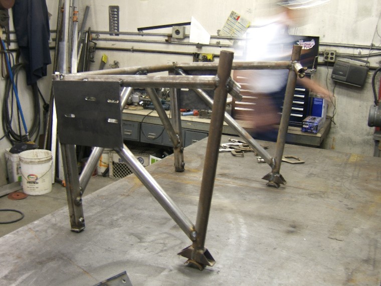

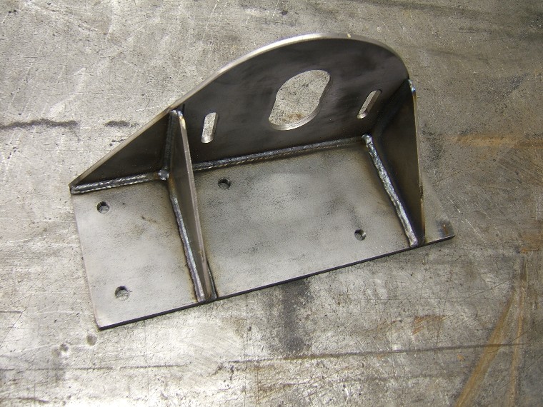

volkdent November 20th 2005 18:32

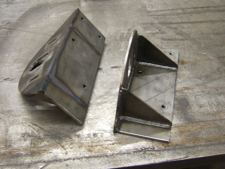

Here is is on the welding table. It's not perfect, but when all was said and done, this thing ends up being pretty close!
http://www.thesamba.com/vw/gallery/pix/238886.jpg
http://www.thesamba.com/vw/gallery/pix/238887.jpg
The welds are VERY nice. This will have a collar welded to it along the main plate to minimize flexing.
http://www.thesamba.com/vw/gallery/pix/238888.jpg
volkdent November 20th 2005 18:44
Walt says he's an old man, but as you can see here, he still works very fast, he's just a blur!
http://www.thesamba.com/vw/gallery/pix/238890.jpg

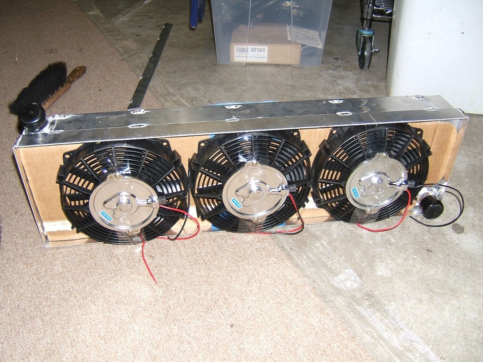

Here's the radiator. I had it made by Brian McCullough at Custom Aluminum Radiators in AZ. He did a great job.
http://www.thesamba.com/vw/gallery/pix/238881.jpg

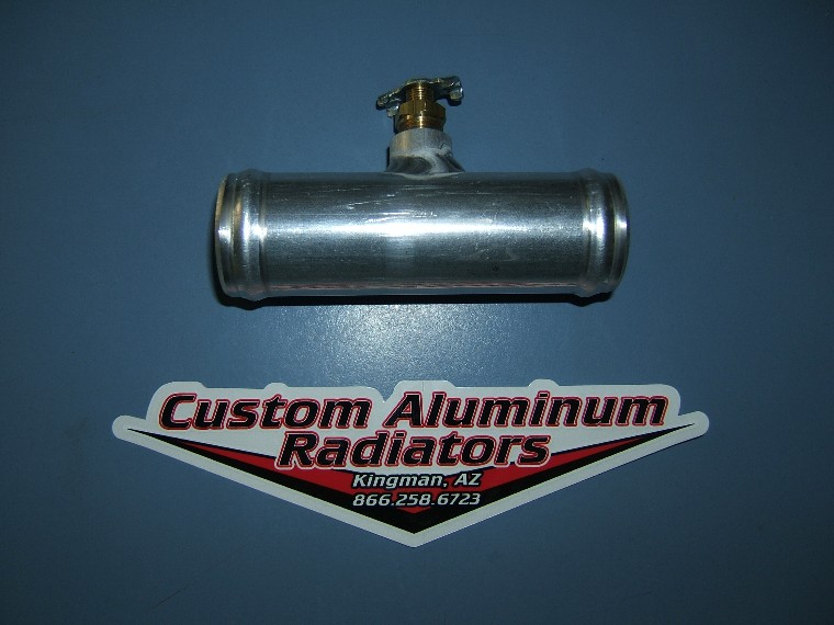

I had him make up this bleed srew as well. It will reside in the drivers front inner fender. It will allow me to bleed the air from the line up front, while the stock cooling system will bleed itself in the rear, or so the theory goes!
http://www.thesamba.com/vw/gallery/pix/238897.jpg
ricola November 21st 2005 05:00
Coming on great Jason!
Rich
volkdent December 3rd 2005 18:40
More surgery. This JUST fits in here with the fans installed. It's butted up against the back of the spare tire area, but fortunately it's angled so airflow should still be great once the ducting is done.
http://www.thesamba.com/vw/gallery/pix/241581.jpg
http://www.thesamba.com/vw/gallery/pix/241582.jpg
http://www.thesamba.com/vw/gallery/pix/241584.jpg
