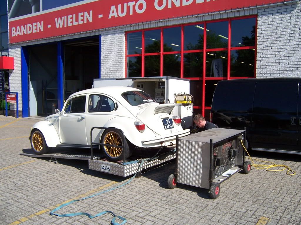

Allright, results are in and disappointing: same results as with the 2 ltr set-up! :confused:
235 RWHP and 270 FWHP (6K rpm) and the same-ish 255 ft.lbs or 350 Nm torque at a bit over 4K rpm at 14.5 psi:
http://i174.photobucket.com/albums/w...ingkamp003.jpg
Driving onto the mobile dyno:
http://www.youtube.com/watch?v=kOYaWh5hFSk
Dynorun itself:
http://www.youtube.com/watch?v=xSoyPv_QhNo
RWHP:
http://i174.photobucket.com/albums/w...ileruns001.jpg
Flywheel hp and torque:
http://i174.photobucket.com/albums/w...ileruns002.jpg
It was a beautifull morning and the engine ran great, but I think it may not have gotten the right amount of fresh air because of a closed deck lid and a mediocre Jamex air filter (not the big K&N one I had before).
Or the turbo is just not making enough air (too small). Next time with the proper K&N and an open deck lid on 14th June, lets see if it makes a difference ;)

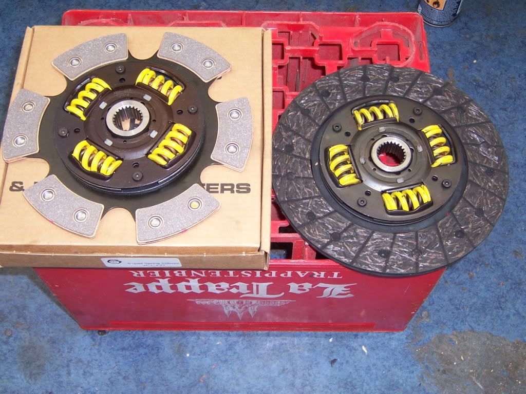

Now that I have some things fixed (you learn every time your out running it)...can't wait to get to it again :D
New 6-puck:

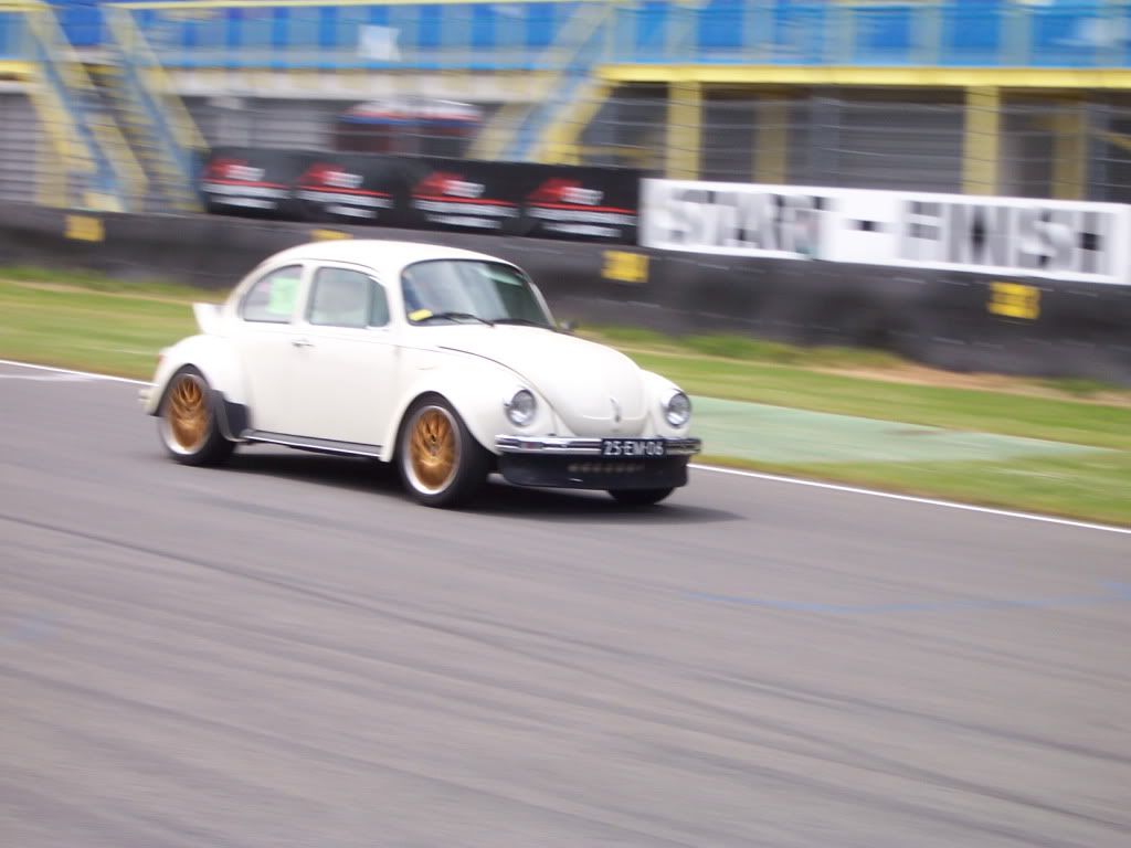

Today I redid my intake tubing of the turbo inlet.
The turbo inlet itself is a 56mm outside diameter, but I only had 50mm silicon 90 degree tubing at the time I made the 2 ltr turbo engine and did forced that one on there...
I now finally found the time to get a 60mm bend 90 degrees and that fitted much more easy :) 57mm bends can be ordered, but 60mm was on stock and now the more readily available 60mm tubing fitted better.
So I got some drain-pipe 60mm tubing and 45 degree bends and started fabbing up the new intake:
I think the cheap plastic even isolates the high radiant heat from the engine better than stainless or alu intake piping. Its also lighter than the previous 2" stainless pipe and the 20% larger intake diameter has a wopping 44% more intake area!
I dunno if this will make a huge difference (probably not at 14.5 psi), but I do know its better to have the intake tubing at least not smaller than the turbo inlet diameter.

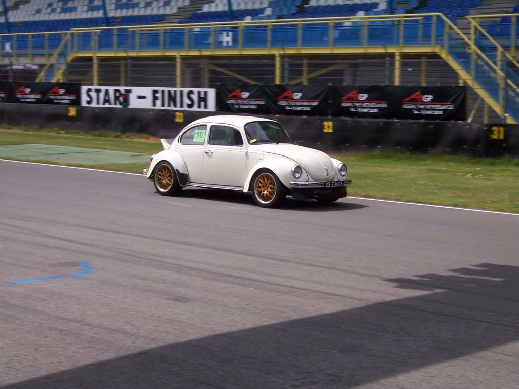

Yes, it woud certainly be an option, but I 'tested' the drain pipe today on a track day and went pretty much all out and it never melted or collapsed or anything. Oil never even got hotter than 90 degrees Celcius!
Engine ran very well and it was a blast. Clip is form driving onto the track with the other participants:
http://www.youtube.com/watch?v=MaQOS...e=channel_page
http://i174.photobucket.com/albums/w...uni2009003.jpg
http://i174.photobucket.com/albums/w...uni2009015.jpg
http://i174.photobucket.com/albums/w...uni2009017.jpg
Sorry for the overload of pics of my car...
