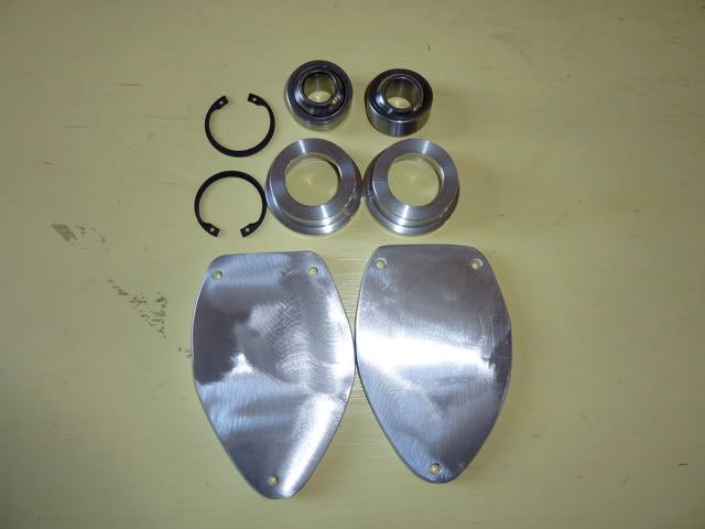

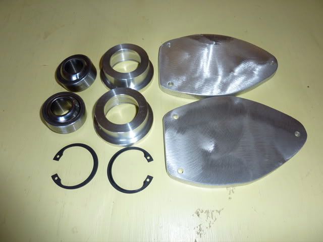

Hey man;) here is your front top mounts, just waiting for the bottom struts to come back from the platers and the hole lot can be shipped mate :D
Wally February 11th 2010 10:24
Awesome Lee!
I have a track day on the 5th of March, so with any luck, I could try them out on the track after welding and aligning.
Looking forward to using those ;)
