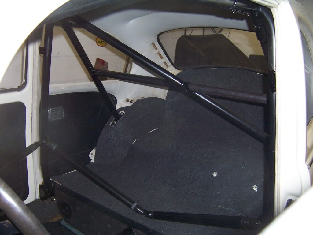

Wally February 11th 2010 14:54
Originally Posted by evilC (Post 74182)
Wally, the fit of the cage is awesome! As good as any I have seen anywhere including the factory race cars. I assume that the cage legs sit on reinforcing plates as it isn't quite clear in the photos. Also is there a cross brace at bottom dash level and if so is that point braced back to the A pillar?
Tnx, yeah, the front pillars sit on reinforced boxes. Those boxes are welded to the channels and the pillar is bolted to the boxes.
No, there isn't a brace under the dash with these bolt-in version. If you order the weld-in cage, there is is iirc and also braces to the top strut mounts. The weld-in involves leaving your car at Heigo, so that may be a little problamatic for most here ;)
I did consider making the under dash bar myself, but that would involve some redirecting of certain drains to make that possible in a nice way. The harness bar I will weld in afterwards however.
I still can't get over how tight your front cage is to the A pillar - it's brilliant. Just don't break a windscreen!
Ah, yes, the windscreen was really my concern when welding the A-pillars up top there...fortunately, the laminated and green tinted windscreen survived :)
Tnx,
Wally

Wally February 14th 2010 11:44
As some of you mentioned, there isn't a 'harness bar' with this set-up, nor can it be ordered, so made my own. Also adapted some of the interior parts and placed them back:
Wally February 14th 2010 13:17
And to show what the extra bars are for:
http://i174.photobucket.com/albums/w...stiging001.jpg
http://i174.photobucket.com/albums/w...stiging002.jpg
http://i174.photobucket.com/albums/w...stiging004.jpg
owdlvr February 14th 2010 14:46
Nice! That's the ticket.
I assume you haven't installed that harness 100% yet, just for photos?
Wally February 14th 2010 15:15
I know this is a trick question right? :lmao:
What can be done better?, pls spill it out already ;)
owdlvr February 14th 2010 15:42
Your harnesses aren't "finished up" around the harness bar. The end of the harness strap needs to wrap back over and into the clip. This "locks" the strap and ensures they cannot come loose.
From my rally car:
http://farm1.static.flickr.com/53/13...89e4f7fa_b.jpg
If you were to leave your harnesses as you currently have them, in an accident the strap can slide out of the clip and you'll lose the shoulder belts (not good!). You need to follow the instructions on page 24 and 25: http://www.schrothracing.com/sdocs/2...structions.pdf I wouldn't worry about the wrap instruction on page 27, it's difficult to do and the style on pg 25/25 is perfectly fine if you have the clips close to the bar like you do.
Looking at your harness I think you may need to go back to Schroth and/or the shop you bought them to get harnesses that have longer shoulder straps. It's a pretty common request, so I don't think you'll find them difficult to get.
Can you take some photos of your lapbelt mounting? Might as well tell you if they're safe at the same time ;)
Wally February 14th 2010 16:25
Good points! Yeah, they are actually a little too short for my liking as well.
The red ones are bought second hand on ebay, but look like new. I may probably better install the black 3" ones as they are long enough (a little too long actually).
The red ones are 6-point ones also. I have the bottom part as well, but no point installing that one as the seat hasn't got a hole for it..
Tnx!
