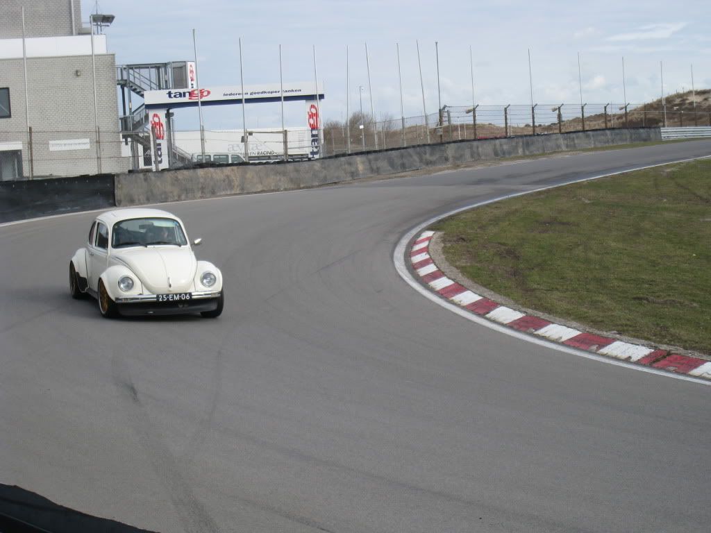

Wally March 5th 2010 15:15

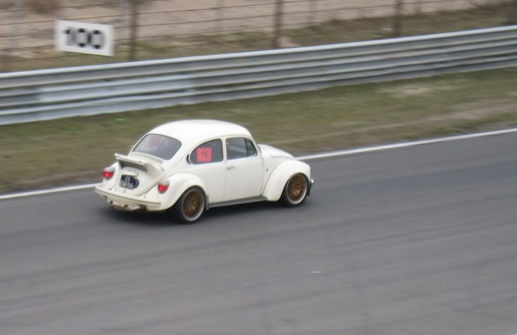

So, in absense of an ebc, I just deleted all settings and ran on wastegate today at our first trackday of the year. Its was COLD!
Track was partly covered in ice we we arrived early in the morning...
First session was a wet track, the 2 session afterwards were dry. Yesss!
Had great fun doing easy laps driving/learning the lines. New rear brakes bedded in nicely, but fronts still block first. Maybe also semi's up front as a next tire choice.
Still with the old struts, and the thicker rear torsion bars get my thumbs up! All in all a good test day :-)

Wally March 5th 2010 17:24
Cheers Paul, me too!
http://i174.photobucket.com/albums/w...g.jpg~original
Big tnx to Franc fo taking the pics in that cold winter day :)
