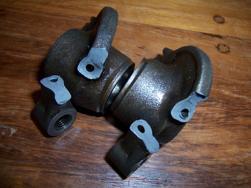

It is odd that 2 broke on the same cylinder.I´ve seen that happen on V8 cars that ran into the rev limiter on their burnout,it happened to my Mustang back in 1992.I broke 3 rocker arms due to valve float when I ran into the limiter (set it lower after that;) ),but they were all on different cylinders.Other than that,I would say that they just wore out and broke,stress cracking and fatigue. But very lucky indeed that it didn´t take a bunch of other parts with it!
Clatter March 17th 2010 03:49
It's just too coincidental that they are both on the same hole side by side...
Detonation?
Evil Detonation, specifically?:)
Wally March 17th 2010 05:56
Detonation?
No, its not from detonation, that I know for sure as I had the vid running showing the knock sensor not sensing knock when it happend.
Mark, its not from 'worn out' reasons either as no wear is visible. Wear by definition should always be measurable/visible. Not likely either as they run on DLC treated rocker shafts...
But I do also think pure metal fatique could be the most likely cause, probably combined or caused by a does of bad luck from coinciding ignition and/or fuel cut-outs all at once and overboost cut-outs during the tuning I did the days before. These are/can be rather violent.
I have no other explanation as these original rockers are really considered as 'unbreakable' otherwise.

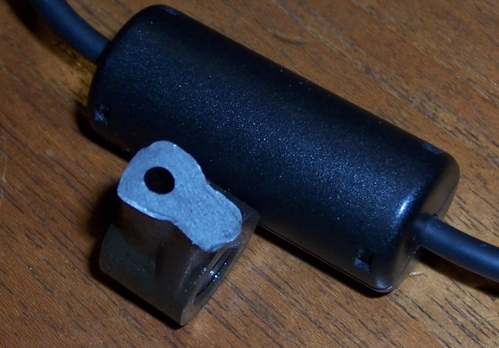

I'm no metallurgist, could you take them to maybe a local aeronautical engineer and ask their opinion.
owdlvr March 19th 2010 01:42
I've done a bit of failure analysis in the past, doubtful I could tell from photos but if you post closeups of both sides (broken side) I can at least take a look.
vwdreaming March 19th 2010 14:38
something 4 the trophy shelf
Wally March 19th 2010 16:15
Difficult to photograph so up close. This is the best I could do:
http://i174.photobucket.com/albums/w...i.jpg~original
Yeah, the trophy shelf has another exibit for sure..
