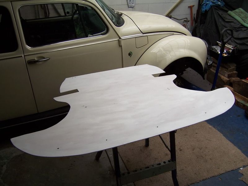

Last week I started something I am thinking about for a long time. So, just did it and went to fabricate a rough shape out of cardboard and when it was somewhat ok-ish, made a better one out of 5.5mm plywood.

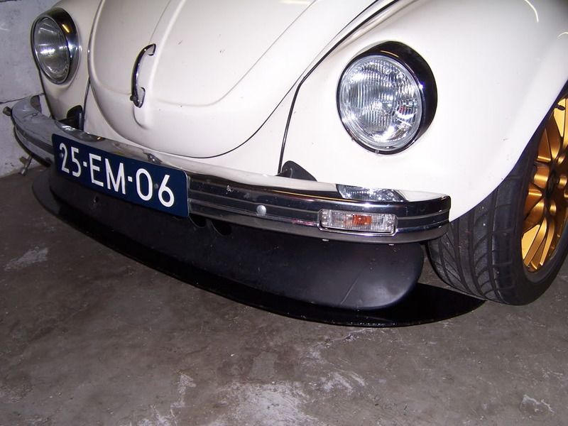

Its a 'splitter' and turned out like this (in primer now, will be painted black):
I have no idea if it will work as I think it could be, but only one way to find out huh?

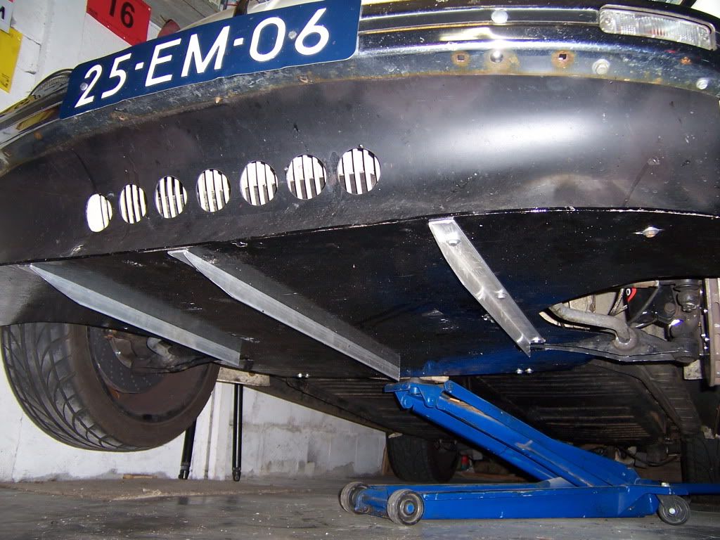

I got the plate painted black and made all the brackets for support, so trial-fit time. You can also see the alu profiles I used for added stifness of the plate.
Just need to think of something for the end pieces. Was thinking of an sloping upward piece for added downforce. Any ideas?
The ends will be connected to the bumper ends with a bar afterwards.

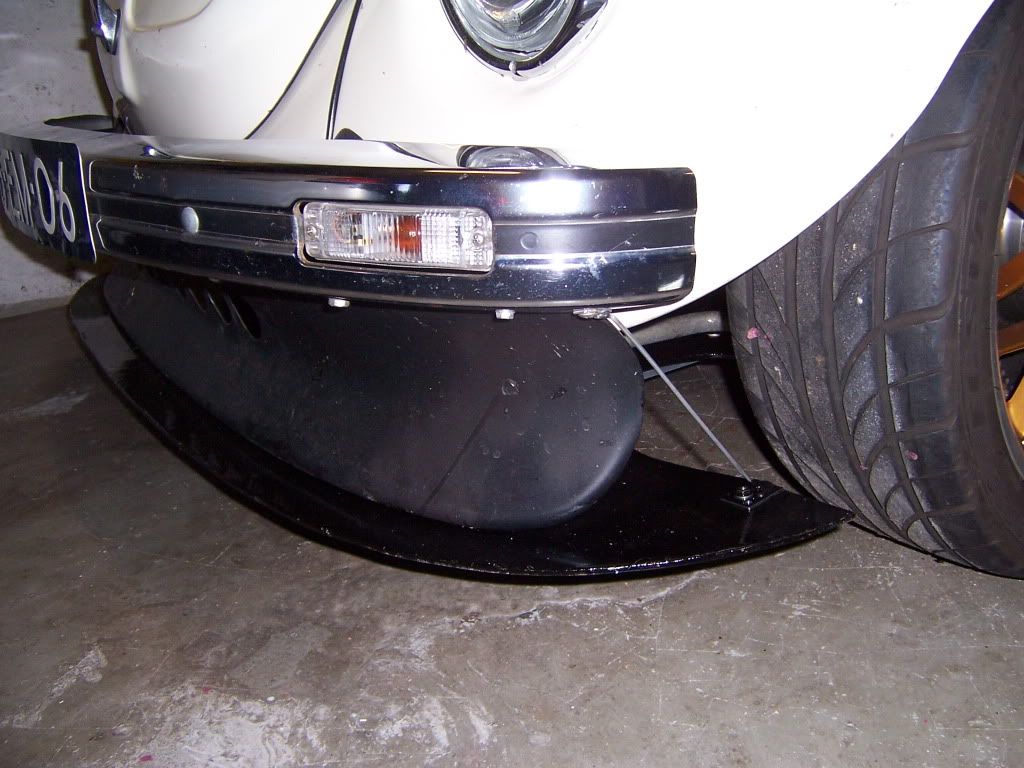

Just fixated the ends with some bars I welded quickly so they won't flutter at speed (hopefully) and I can drive/test this contraption.

70Turbobug May 13th 2010 09:00
Looks great Wally! I think it will work well also.I´m not sure if the cable attached to the bumper will hold up.The cable isn´t the problem,but I fear the bumper may bend at high speed,you might need a more stable mounting point,like the mounting bracket for the bumper inside the wheel well.
Wally May 13th 2010 11:29
Thanks! Yeah, your probably right as it all hangs now on the front bumper brackets. It would be better to support it a to the inner fenders as well probably.
Anyways, I did a test run today with the splitter for the first time and ... it stays put very well already :-))
Even above 200 km/h it doesn't bend too much at all. Very happy with that.
I got a youtube vid uploading now that should show how stable the splitter is.
