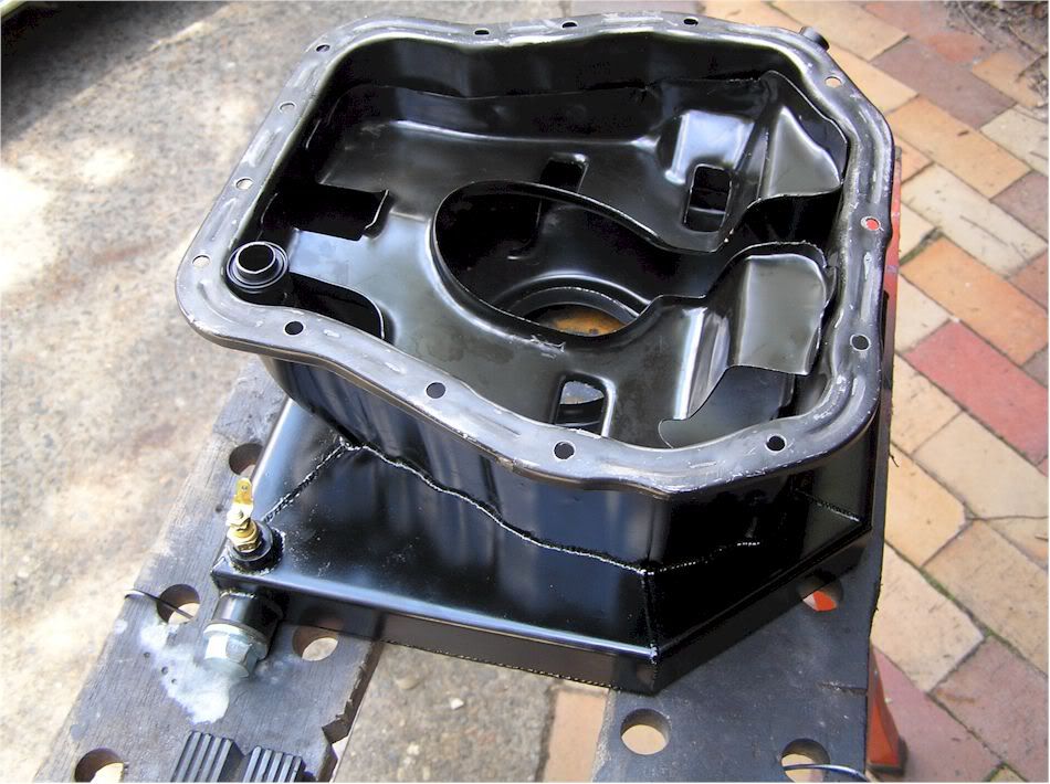

Steve C August 14th 2013 18:19
I hope you don't suffer oil surge with that sump mod, I had wings fitted to mine.
http://i1184.photobucket.com/albums/...p.jpg~original

Steve C August 15th 2013 04:04
Just noticed that my sump has a more elaborate windage tray, maybe because its a STI or just a different model motor.
Humble August 15th 2013 13:23
Mine is US spec Sti and I've noticed that the pans and pickups are different. The Sti pan is more narrow than the wrx and forrester pans. If you use equal length headers they won't fit if you have kickouts or a non-Sti pan. I'm going to supplement the oil system with an Accusump until I get a dry sump pan and pump. The section that was chopped was so smal l it only lost a quart or less of storage. When I refill the motor I'll mark the new high point on the dip stick and be good for the moment.

Steve C August 15th 2013 20:04
The Accusump is a good plan, I was going to fit one to my motor, I've kept it for an Oxy Boxer I'm building for my sons car.
I've only run my car hard on a track for few laps but I suffered no surge with my sump, talking to Subaru owners they often have oil surge issues. I'm probably not getting the same Gs as them or yourself
Humble August 16th 2013 01:46
Yeah, oil starvation is a big problem for subaru motors and they spin bearings very easily when the pickup goes dry. I know 2 guys locally with subaru swaps, a buggy and a beetle. Both of them have spun bearings more than once under autox conditions. I figure an accusump is cheap insurance, but a dry sump is the real fix.
