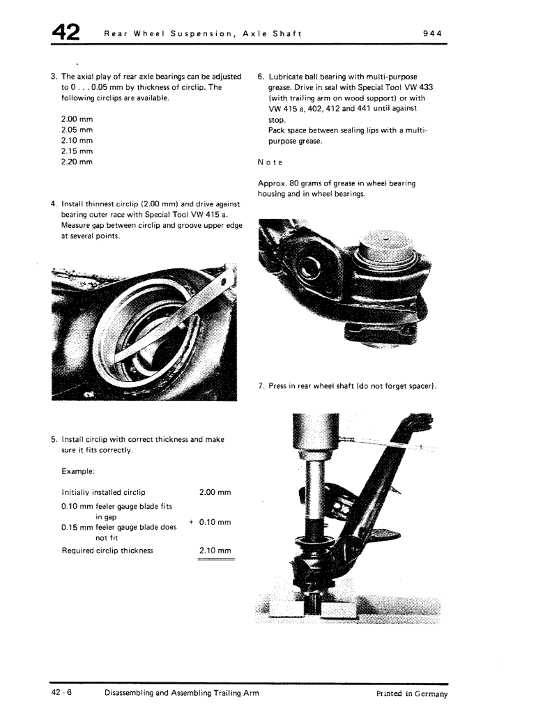

I did some tear down the other night.
I'm not missing any peices, but the play is still there. We've come to the conclusion that the bug bearings are narrower then the porsche ones (I think, can someone back this up?) So I need to eather get a spacer or get the 944 bearings and press them into the hubs.
When it came down to it, the spindle was comming to far in on the axle shaft by about 2.3mm, so the rotor was hitting the backing plate.
Here I have two photos to help.
http://img200.imageshack.us/img200/4668/dscf3960x.jpg
http://img182.imageshack.us/img182/147/dscf3964g.jpg
Has anyones else had this issue?
kombi211 August 19th 2009 07:25
well it hard to tell in your pic if its the alum arm or the steel ones. If its the steel arms there is no difference in the bearing Porsche uses the vw part number 113-501-283 same as irs bugs if you have the alum arms then its a different bearing altogether 999-053-020-01.
http://i154.photobucket.com/albums/s...M.png~original
Steve C August 19th 2009 09:22
All the part numbers for bearings, spacers and seals are all VW numbers.
I wonder why they have different thickness bearing lock rings?
kombi211 August 19th 2009 12:26
here the page out of the 944 manual looks like thats how the set up the axle end play. hope this helps
panic August 19th 2009 18:02
I have steel arms on my car fyi.
Thanks kombi that certainly clears things up a bit!

Steve C August 20th 2009 09:49
That shimming with circlip is interesting, I wonder if VW did the same thing.
