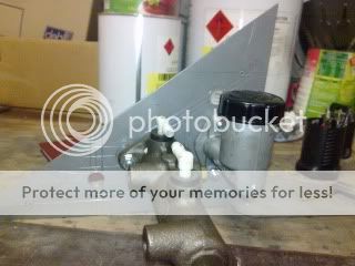

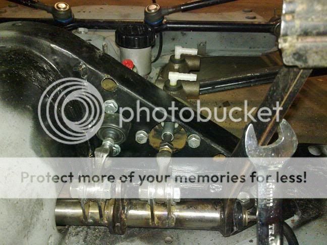

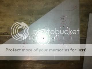

my mc for my clutch runs at a 45deg angle towards the bulkhead it mounts to so im running the hard line right up & over it then down the tunnel, not sure if i should run it over the tunnel & mirror the brake line or run it above & switch over to the clutch arm side at the forks... pics shortly... worked longer than normal yet again :)
mounted loosely, need to grind out the hole for the kombi MC 1 mm more as theres no 42 mm holesaw available at the time, the holes to the top of the clutch MC & to the extreme left of the brake MC is for the hard lines to go to the rear of the car, best compromise of location & functionality with the space available
http://i975.photobucket.com/albums/a...0.jpg~original
give people an idea of how its mounted/layed out
http://i975.photobucket.com/albums/a...9.jpg~original
should be ground out tomorrow & then its cutting time on the floor pan!, oh & because of the extra holes, im using thicker steel but also will weld in some piping between the 2 plates, for the bolt holes, pushrod & hard lines :)

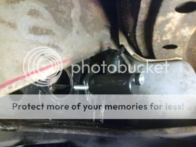

STIDUB January 5th 2010 19:17
an update for those that are interested....
http://i975.photobucket.com/albums/a...s.jpg~original
remote res clutch mc was required to clear the sheetmetal of the spare wheel well, then the red line on the body shell lip needs to be trimmed then stitch welds to replace it, will get some up later when its all plumbed in/finished off but at least we all know it WILL fit now, best part is the wilwood gear has about 6 different size options so getting it just right should be a walk in the park :)

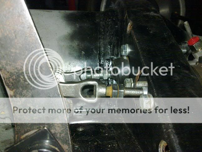

Steve C December 5th 2010 06:17
3 Attachment(s)
I did some work on my pan today. I relocated the brake master cylinder 30 mm to the drivers (right) side, this gives me enough room to fit a clutch master in next to it.
I now have to move the lever on the brake pedal over 30 mm as well and fit rose joint attachment to the clutch pedal to operate the clutch master cylinder.
