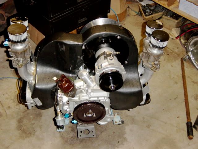

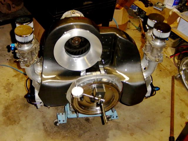

I am fighting my way forward on my 2.4L type 4 build. I had to spend more time than normal to fit many parts and spent more time than normal waiting for parts but it is moving forward.
I had a few days off and fitted my DTM. I ended up having to mill near 1/8 inch off the bottom of the alternator stand to get the alternator to sit true and the fan/backing plate to sit properly in the opening. Now I need to get the linkage built. I have one set of center pull linkage but I have had problems with this brand in the past so I am going to try a different center pull rather than use a crossbar set up.
Anyway here is what is in it.
GA case
DPR 82mm crank
96mm KB piston/Bored OE cylinders
CB H beam rods
Web 119/163 cam w/Jakes lifters
Manton push rods
Porsche 2L heads worked by Len Hoffman (all the tricks in his bag)
Mallory Unilight dizzy w/6LA Hyfire and E-coil
45mm Dellorto DRLA's (for now)
Kennedy Flywheel (12 lb.), Press plate and disc

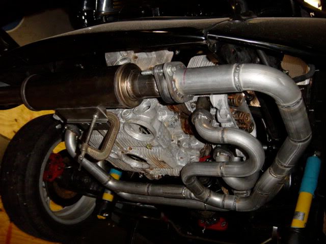

Home Built Exhaust (not shown)
http://i209.photobucket.com/albums/b...0.jpg~original

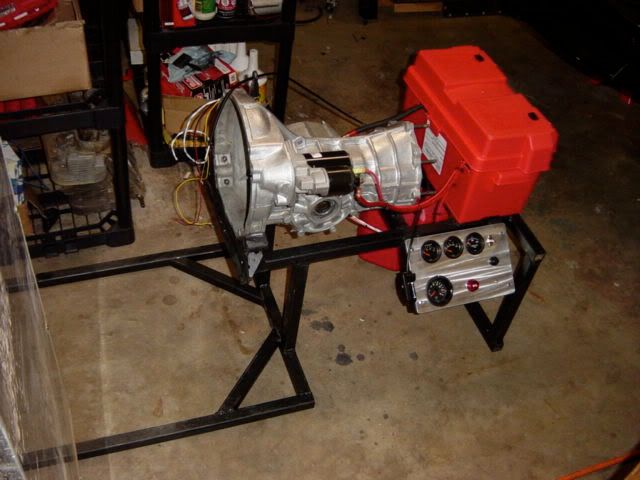

I built an engine run stand to break it in on.
http://i209.photobucket.com/albums/b...7.jpg~original

That exhaust is gonna sound nasty!
Looks great Dave!

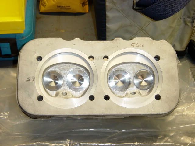

Originally Posted by NO_H2O (Post 72012)
NO_h20
I am looking at your head cc information and i am seeing 59cc for one head and 56cc for the other is this correct, isn't this going to pose a problem for you when you try to tune it.
By the way nice setup this engine should be nice. Saw on jake's site where he did a 2.4ltr also with a 84mm crank and some 5.9inch rods. The engine made 220HP. Are you using 5.5inch rods on your 82mm crank.
NO_H2O October 31st 2009 15:08
the final camber volume was 54cc for all 4. The sharpie notes were left on along the way. I should have hit them with some brake part cleaner. My rods are 5.7 with chevy main journals.
Bad bug October 31st 2009 18:46
O.k. great, your rod ratio is 1.76 : 1, good. How wide is the engine? I know for a stock type 1 engine the measurement from the crank center to connecting rod pin center is 211mm. I can't remember if the type 4 is 207mm or 209mm.
So is your engine wider than a stock t4 engine.
