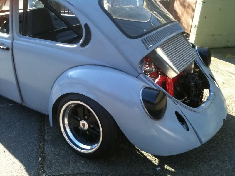

Engine fits:D Under stock body with a little massaging.
http://i7.photobucket.com/albums/y25...1.jpg~original
Wheels are 15X8.5 front and 15X10:eek: rear.

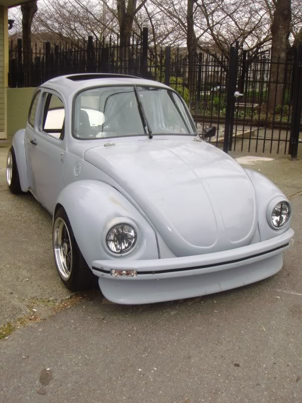

http://i7.photobucket.com/albums/y25...0.jpg~original
I didn't see the JDM sticker before, nice touch. This thing is Hellaflush.

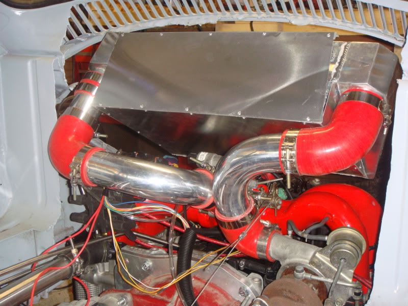

And some ducting for the intercooler which is going to be fed by to NACA ducts and 3" flexible hose in the rear window. Started on the rear firewall. That is going to be a big task.

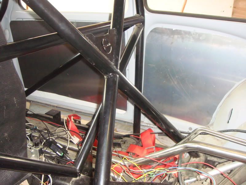

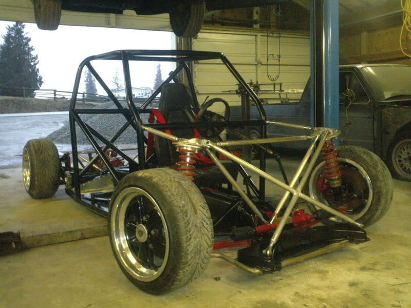

Here are some more photos of the cage. This picture was taken just after I had the entire thing powder coated. 3 years ago:o
I need to support my steering rack better. I CNC milled a pedestal that the rack sits on but I want to tie it into my front strut brace as well.
This picture show when i was using the rabbit rack with made my wheels turn opposite!!!

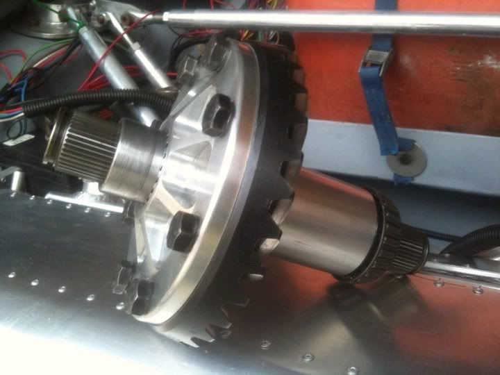

Picked this up as well. Along with some heavy duty axles and cv's.

JDM sticker is the symbol for new driver in Japan. It's a magnet and came with a cheap steering wheel I got.

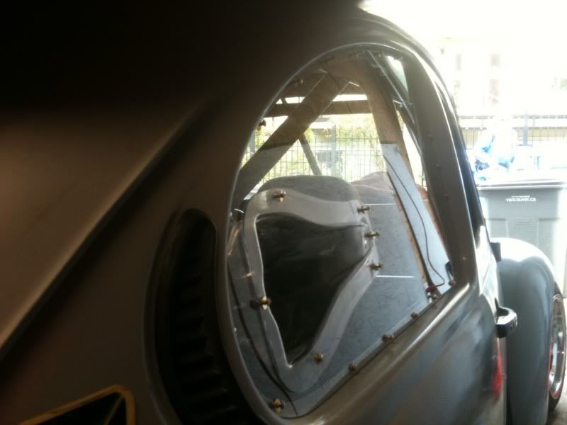

http://i7.photobucket.com/albums/y25...3.jpg~original

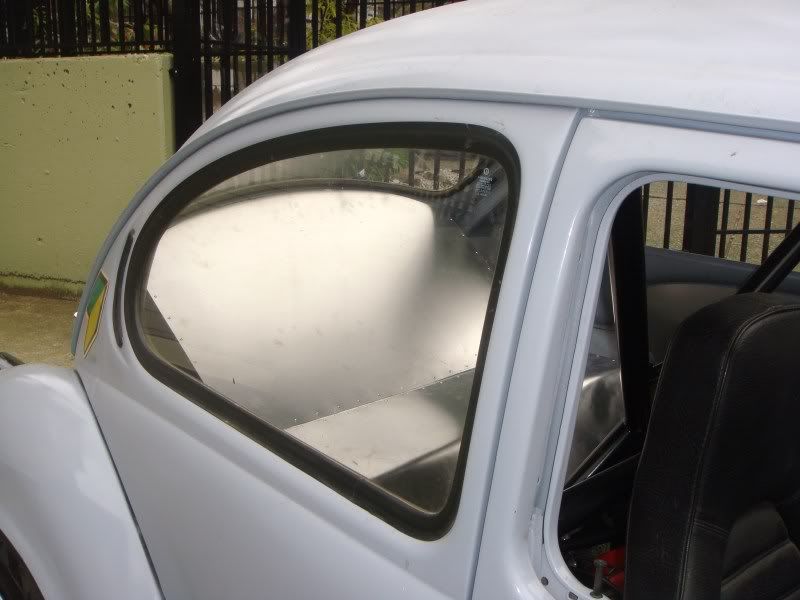

Working on my rear windows. You have to be really careful when working with lexan as to not crack it:angry: It took a few attempts but the results were worth it.
