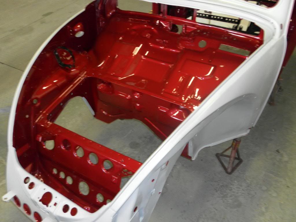

Thanks Dan for posting the pics. Will get some more on when the Wife can be bothered!
To bring everyone up to date the engine will be Type 1 Air Cooled and Water Cooled (water jackets over the heads) so I can run decent boost without it getting too hot. 2332 turbo autocraft case, superflow heads, big holset turbo, charge cooled. Should be good for over 400 hp. The car is built to go up the quarter mile pretty quick and to be rapid round the twisty bits. Will get some more pictures on soon to get you all going.
PS. Dan your car is looking great. I also like Wally's 1303 (reminds me of my old supercharged German look 1303 from back in 2003.

Glad to see your finaly on here, good old Andrea:lmao:, here are some more pics of your bug, b.t.w. I spoke to John a few weeks ago hes dyno testing one of our Vintagespeed mufflers, i'll mail him this week.
Cheers.
Dan.

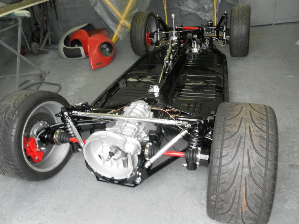

dave forder October 3rd 2011 16:34
Dave Forder's Bug Update
5 Attachment(s)
Still waiting for the turbo engine from John Maher. Apart from that all ready to go.

dave forder October 3rd 2011 17:20
My aim is to debut the car, fully finished, at the Volkswold Show.
The suspension setup is Porsche rear arms. Unibal setup (I believe to be an American setup that Marco Mansi sourced years ago when the project began). IRS adjuster bolts. AVO fully adjustable coilovers. Front end AVO adjustable coilovers. The beam has been modified to accept special bearings that allow the arms to move independantly a mod by Marco. The top arms have been modified to pull the top of the wheel in to give negative camber. (Trying to be like you 1303 Boys!).
There is a few other tricks in the chassis regarding bracing of the gearbox and frame horns and also the strenghtening of the front beam. All credit for the superb finish of the chassis goes to Mark at Flatlands.

72marinablue October 4th 2011 15:55
Is there any way you could post some pictures of the modifications to the top arms of the front suspension?
