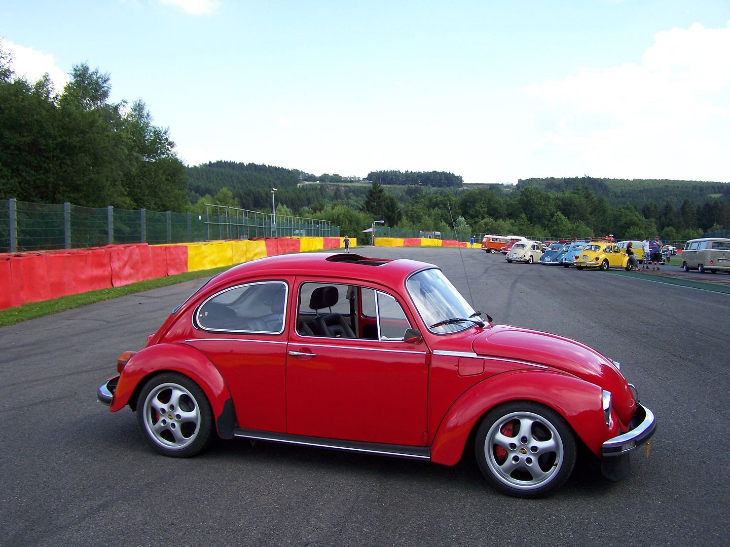

Same spot, different '75 super
@ Bugshow Spa 2015

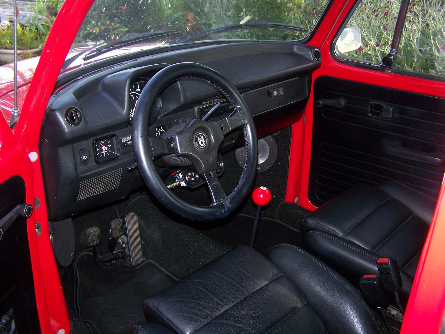

New Red 03 poolball gearknob, appropriate in this red '03
http://i129.photobucket.com/albums/p...r.jpg~original
http://i129.photobucket.com/albums/p...o.jpg~original

Few more pics at the Bugshow Spa Francochamps.
http://i129.photobucket.com/albums/p...h.jpg~original
http://i129.photobucket.com/albums/p...6.jpg~original
http://i129.photobucket.com/albums/p...3.jpg~original
http://i129.photobucket.com/albums/p...m.jpg~original
H2OSB August 22nd 2015 16:23
You car looks outstanding. It was your camber plates I used as an example for the guys at Silver Project to make the ones they now sell for 1303s. Good job! Because of you many can have camber plates like you're using (Not me yet...I was hoping the Silver Project guys would give me a set for free since I gave them the idea and the stock upper strut bearing they used for dimensions...Alas, it didn't happen).

Blizzard August 22nd 2015 16:42
Front.
KW inox coilover set. Home made camber plate. 944 NA spindle (with hole for speedo cable) with custom bearing spacers. 944 S2 hubs without ABS. 944 turbo '87> brake rotors. 2006 Boxter S calipers on home made axial > radial adapters. 993 Cup-2 7Jx17 ET-55 Goodyear Eagle F1 195-45-17 under stock fender.
I don't know how low it is compared to stock. Its as low as possible without scraping the Kamei on speedbumps. I can put one finger between the tires and the fender. I like the look when the edge of the fenders follows the tire with the gap the same front to back. I even raised the back again when I put a heavy subwoofer behind the backseat.
