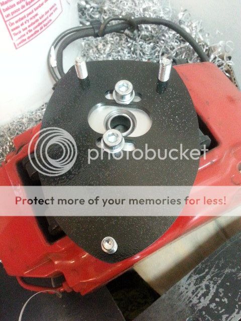

flat October 28th 2013 22:06
Finally!
http://i797.photobucket.com/albums/y...2.jpg~original
Approx 2 degrees positive caster gain
Approx 1 degree camber adjust either way
Camber adjust properly aligned on chassis
Adjust from under the hood
Aurora spherical bearing
Sealed bearing underneath to keep out the elements
Details to follow

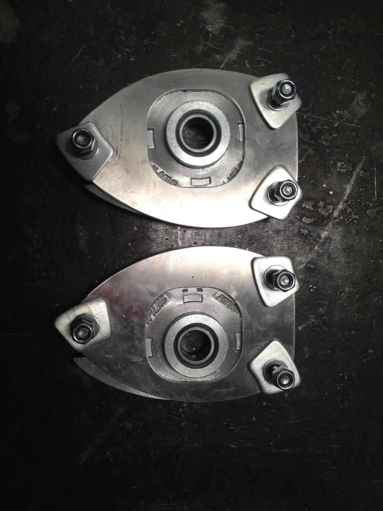

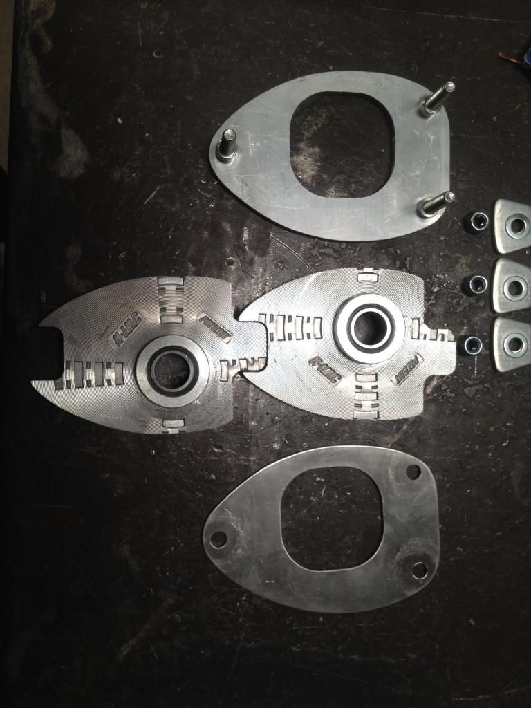

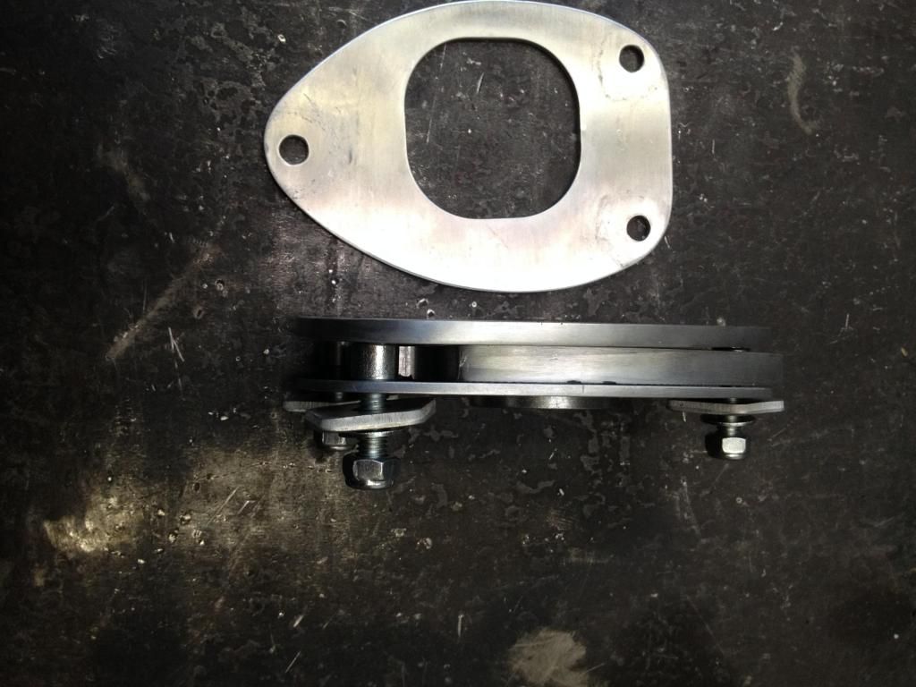

SuperRSi October 31st 2013 02:11
Here is a look at the KMacs. Looks like camber changes will come with caster changes. Will reserve judgment until I try to make them work. Cast center section, I nestled the two together to show the cuts. Captive bolts for squeeze factor. Thrust bearing held in with C clip. Funny the box says you can change your Caster/Camber in only 30 minutes. We shall see!
http://i1119.photobucket.com/albums/....jpeg~original
Oval November 15th 2013 08:10
yeah it all seems loose now, but when it is all in the car, you can 'lever' the plate fore and aft and side to side for camber and caster adjustment
