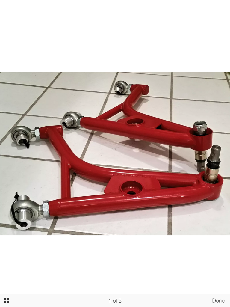

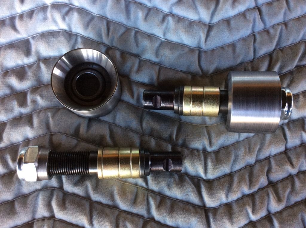

Damn I wish anyone else would have built these. But now I am working on a test set after seeing a set of Porsche 944 aftermarket arms. I contacted them and purchased the complete monoball end of their arms. $350 a set sounded pretty high, but when I got them they are beautifully made. Not something I want to build as a one off, or ten off. My plan is to do something similar to Ricola on his last post. The difference is I want to tie together the two blocks that bolt to the sway bar mount and make them double shear at the front. Hopefully I can get this done soon.

I would totally pull the trigger if something could be made that was bolt on, or nearly so. Why couldn't something be created that uses the factory mounting point as a location to bolt a mount to? Say, some two piece design that passes over and under the hammer head neck between the two factory control arm mounting points, then run a bolt through the new mounts and through the factory mount to lock it all together? Does this make sense? Once you're securely attached to the car, you can have any number of configurations to connect some kind of A-arm.

Now working on the double shear front mount design and prototype. When you guys say you want a tubular lower control arm are you thinking the single arm without the forward tube? Are you talking monoball or rubber ball joint? Beetle or 944T/S2/968 size? Hopefully I will be able to post a picture of the full suspension on my Beetle in a week. I am wire brushing the bottom of my chassis now so the pictures will be a little better looking. The prototype is a monoball with the forward tube connected to the control arm with a heim joint and a fabricated double shear front moun that picks up three existing bolt positions on each side.
