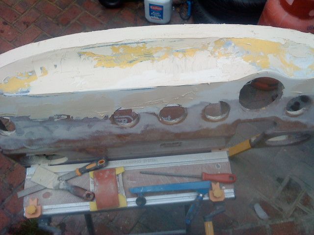

First blast at building a dash.I wanted to build one in two pieces so if there where any issues behind the dash I could remove the top section for access.The other design idea was to have the bottom section carbon and the top trimmed in leather the same as the seats.I was hoping to build the lower dash section and lay the carbon over it :lmao::lmao::lmao: if only I knew how hard this process is :confused::confused: as I say this was the first attempt.I am now on number four and i've also gained a lot more grey hairhttp://i1185.photobucket.com/albums/...d.jpg~original
graham May 7th 2013 20:30
[IMG]http://i1185.photobucket.com/albums/...9.jpg~original~original[/IMG]
Carbon cloth. This stuff is very difficult to handle it constantly wants to fall apart and misshape, once the weave is distorted its pretty much game over for that piece of cloth.If I where to give anyone some advise on making carbon parts I would say think very carefully about it, its very specialist.I have only posted the pics here to show how much of a pain it is.( you've been warned ) I would never of had a shot at it if I knew what was involved.But like all these things once you start you keep slogging away at it.
[IMG]http://i1185.photobucket.com/albums/...3.jpg~original~original[/IMG]
The dash on the left is the first attempt it doesn't look to bad in the pics but some areas looked terrible.this was the carbon laid on the dash.So the mdf mold/plug on the right is the beginnings of numero 2. Thanks to my mate Max he has helped tons to get this dash sorted.
[IMG]http://i1185.photobucket.com/albums/...1.jpg~original~original[/IMG]
After covering this MDF in resin you are left with a bobbly uneaven surface this is where the sanding begins LOTS of sanding and polishing Lots of that **** as well until you start to get this.
http://i1185.photobucket.com/albums/...e.jpg~original

graham May 22nd 2013 19:04
My attempt at building GL beetle
A few more pics of how my dash has evolved.[IMG]http://i1185.photobucket.com/albums/...5.jpg~original~original[/IMG]
The steel top section had a few mods including moving the speedo area slightly and reducing the overall width of the dash by slicing a section out next to the air vents and moving them towards the centre.
The dash now sits between the roll cage and does not run the full width of the car to the door pillars like the stock one.I then filled and shaped it to line up with the bottom section.[IMG]http://i1185.photobucket.com/albums/...a.jpg~original~original[/IMG]
[IMG]<a href="http://s1185.photobucket.com/user/rsg2/media/DSC01128_zpsc1fc8a8e.jpg.html" target="_blank"><img src="http://i1185.photobucket.com/albums/z351/rsg2/DSC01128_zpsc1fc8a8e.jpg" border="0" alt=" photo DSC01128_zpsc1fc8a8e.jpg"/></a>~original[/IMG]
not sure if anyones really interested in this but I thought I would post some pics anyway.[IMG]http://i1185.photobucket.com/albums/...0.jpg~original~original[/IMG][IMG]http://i1185.photobucket.com/albums/...c.jpg~original~original[/IMG]

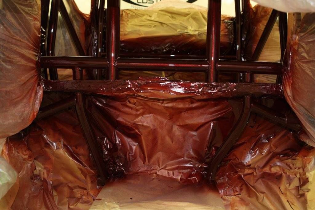

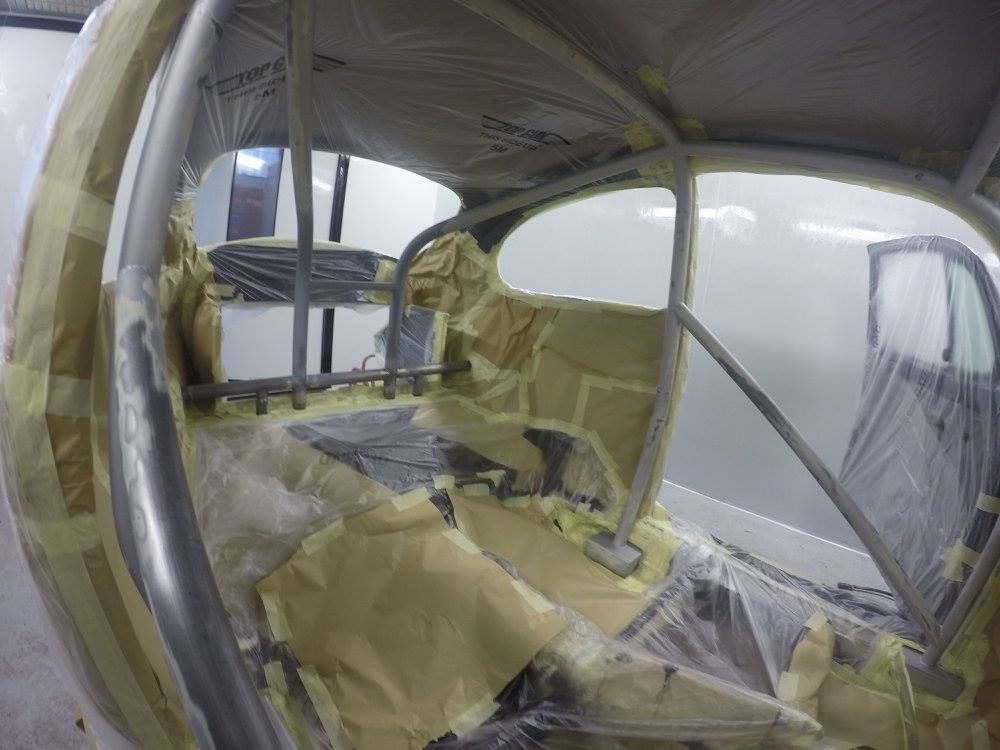

graham October 14th 2013 18:42
[IMG]http://i291.photobucket.com/albums/l...5.jpg~original~original[/IMG]Ok its been ages since Iposted any pics life's been HECTIC to say the least.
Some pics are old but this is how the build has roughly progressed.
[IMG]http://i291.photobucket.com/albums/l...6.jpg~original~original[/IMG]

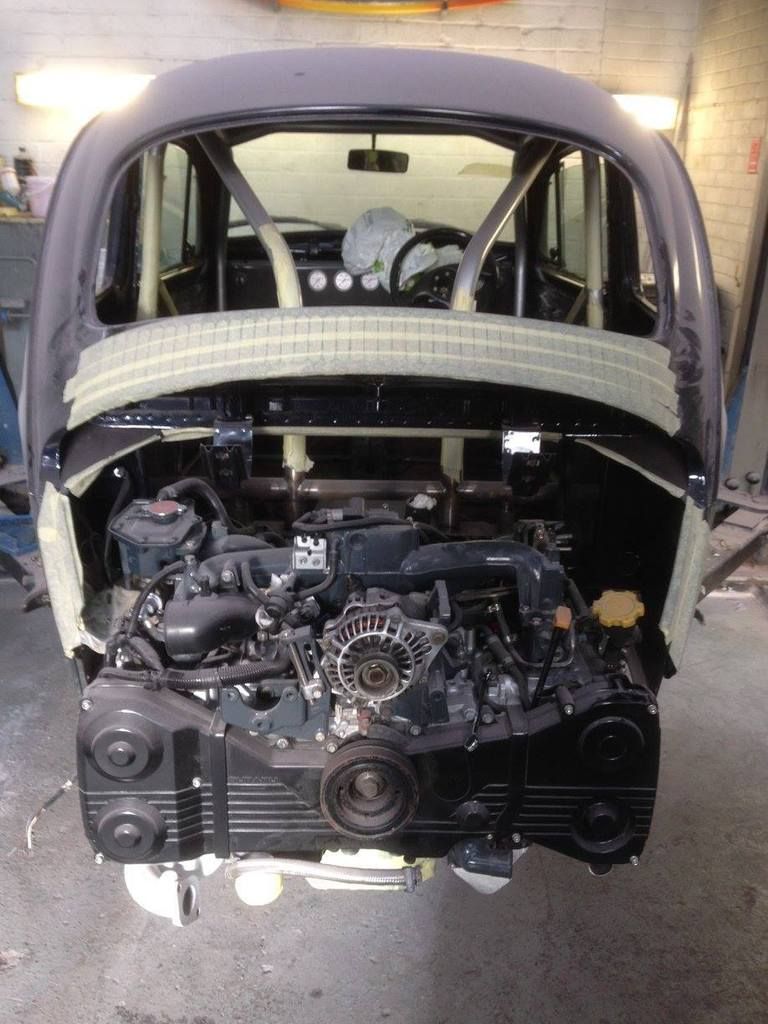

After this pic was taken the car went off to have the subaru engine conversion bodged up and thrown in by the UK's so called Subaru Engine Conversion Specialists:angry::angry::angry:.Fast forward and after the interior was fitted and the car was road tested the gremiln's started to raise their ugly heads.And trust me there where tons of them..:angry::angry::angry::angry:......Fast forward again and after some successful legal action and money back my way the engine has been pulled.And all the other crap they fitted has been removed from the car.

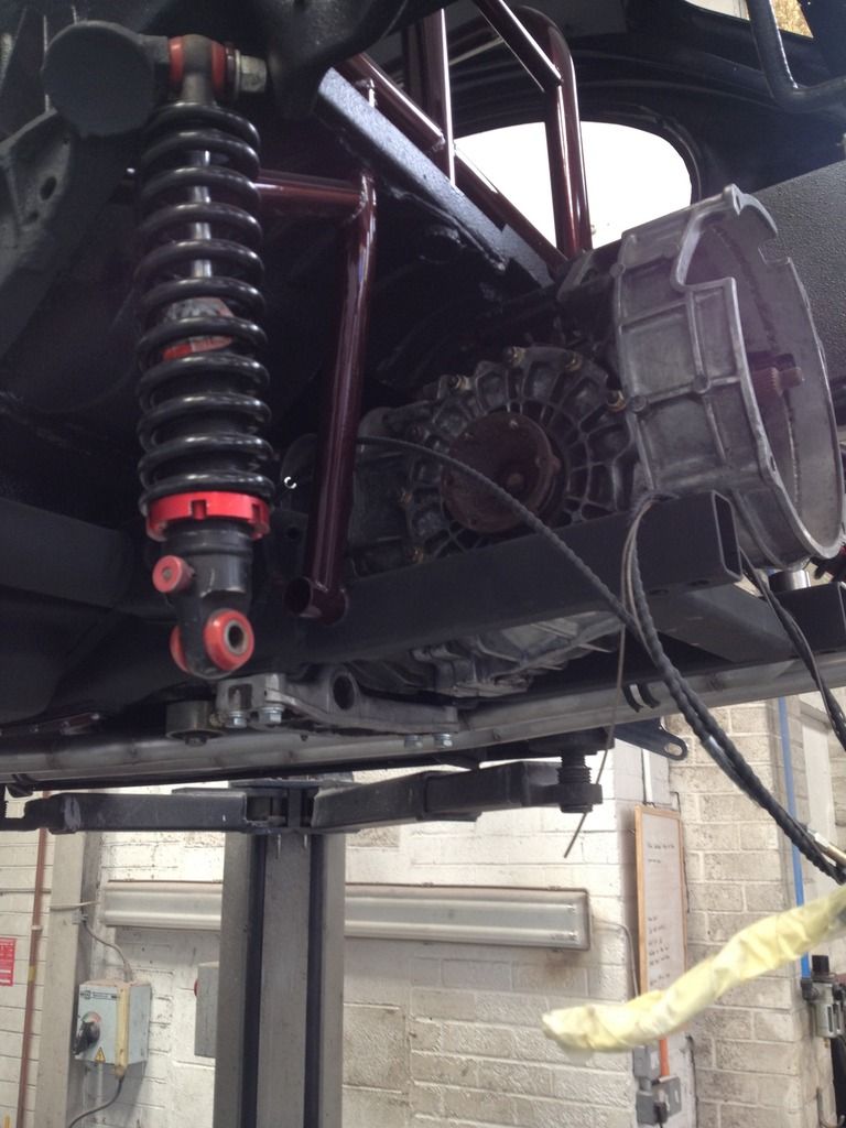

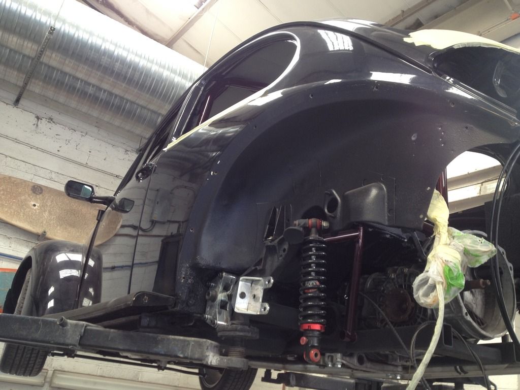

graham October 14th 2013 18:55
TAKE TWO freshly built 2003 STI Engine[IMG]http://i291.photobucket.com/albums/l....jpeg~original~original[/IMG]
graham October 14th 2013 18:57
:D:D:D[IMG]http://i291.photobucket.com/albums/l...3.jpg~original~original[/IMG]
graham October 14th 2013 18:59
:D:D[IMG]http://i291.photobucket.com/albums/l....jpeg~original~original[/IMG]
Lazarus October 14th 2013 20:10
looks impressive so far. you have done a ton of work. some of the build pics remind me of my build. you will definitely keep us up to date on the scooby conversion. i have a personal interest in that as i am currently considering either that or a 2056 type 4 for my daughters 62 Germanlook
