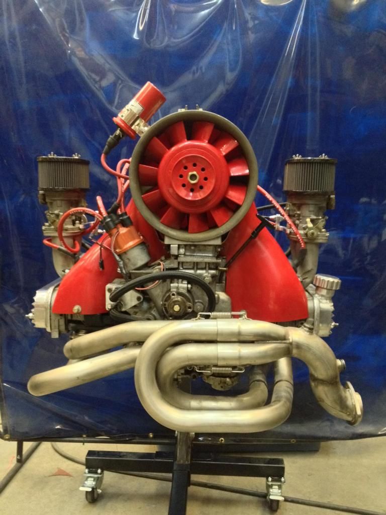

SuperRSi March 8th 2014 16:42
Finished re doing my old 2.3L Type IV with the FAT 911 cooling and BAS Stainless Cup Exhaust. About 175hp. This will do until I can afford to build a Nickie engine with Klaus cooling I bought parts for from Alex N. here. And hopefully a set of Thorsten Pieper billet heads in 102mm.
http://i1119.photobucket.com/albums/....jpeg~original
volkdent March 12th 2014 21:38
Do you have an ETA for getting this thing on the road?
SuperRSi March 13th 2014 00:29
Depends upon how long it takes the paint shop. They promise 4 weeks. The last company that told me 4 weeks delivered in 19 months. So when it gets back, new wiring, install 911 dash, interior seats carpet, all new rubber seals, new top. Trying for summer here which is by Oct at latest. We shall see...
