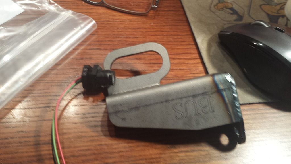

I'm currently installing an AEM EMS4 EFI system in to the Ghia -- -- I have been using the Honeywell GT101 Hall effect sensors for most of the applications
Now I'm installing a speed sensor onto the Ghia -- The bracket and pulse ring I got from Pacific Customs in Corona
pulse generator ring:
http://www.pacificcustoms.com/mm5/me...nders-hardware
bracket for my 091:
But with this bracket a standard GT101, which has a tab that you bolt to your bracket, will not work -- I need one that is threaded on the outside so that adjustments can be made -- -- SOOOO after spending half of today cross referencing parts I finally found someone that had the knowledge to finish my quest -- The part number I need from Honeywell is SR4P3-A1

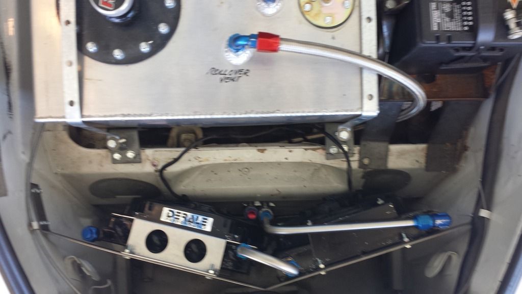

Finally decided on a plan for the oil coolers move the front of the car -- -- I know, I know, but sometimes it just takes me a while to decide on a course of action -- I decided that since the shift rod was now run on top of the tunnel, I'd run some 5/8" aluminum tubing thru the tunnel -- - -- Since the PO cut the bottom of the tunnel at the rear to do the shifter for the 901 trans is should be a cake walk -- -- I got some water hose and cut it into 2" lengths and placed them every 1.5 to 2 foot along the tubing to hopefully reduce rattling -- I was going to put over the entire distance but I was wanting the tubing to act as a heat sink to also help lower the oil temps so I didn't --- --
I did some work on the front vents so that I can maybe add some ducting to the coolers
http://i586.photobucket.com/albums/s...pspjpcupze.jpg
Here is a picture of the tubing exiting thru the PO's 901 hole:::::::
http://i586.photobucket.com/albums/s...psfmrkfee0.jpg
I'm still playing with a couple of different ways to mount the coolers in the nose -- and the mounting brackets -- but here is kinda what I'm leaning towards----- (you can see the tubing exiting thru the shift rod access hole)
http://i586.photobucket.com/albums/s...psk49khayr.jpg
Hope to finish this up tomorrow and get some brackets made and all the hoses ran to the coolers................

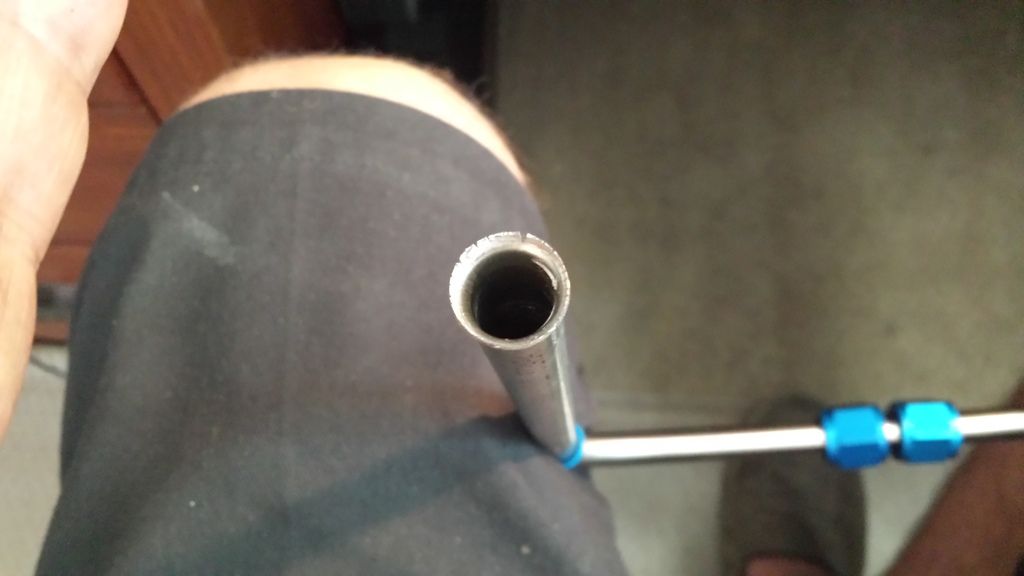

So was finishing up the oil cooler install and using SS tubing -- Things were going pretty good, then started flaring the tubing ends -- you know, always feeling it needs to have the last quarter turn to finish that perfect flare -- NOT
http://i586.photobucket.com/albums/s...z.jpg~original
It's amazing just how much can leak thru those little cracks at pressure LOL -- -- Then started looking for that last piece of tubing to finish the install -- -- damnit -- it was 5/8" aluminum, needed 1/2" SS -- Oh Well, 20" short of tubing finished the day for me -- might stop by G and J in Ontario and the way home tomorrow and get a piece of SS tubing
http://i586.photobucket.com/albums/s...o.jpg~original
