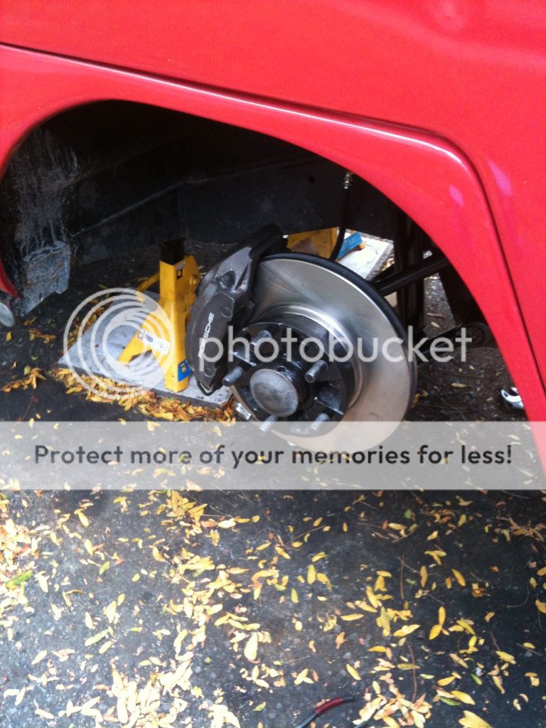

Here's a 56 bus I did last summer. 7 and 8" 16 dials. 4" beam with stock micartas turned down for scratch built beam, 4.85" non-flipped hybrid dropped spindles, boxster brakes, straight axle (short) with Wagenswest offset plates. Rear required 5/8 " spacers.

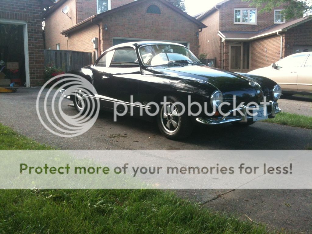

Porsche wheels the easy way: 1" adapters. Stock suspension on 14x5.5s
