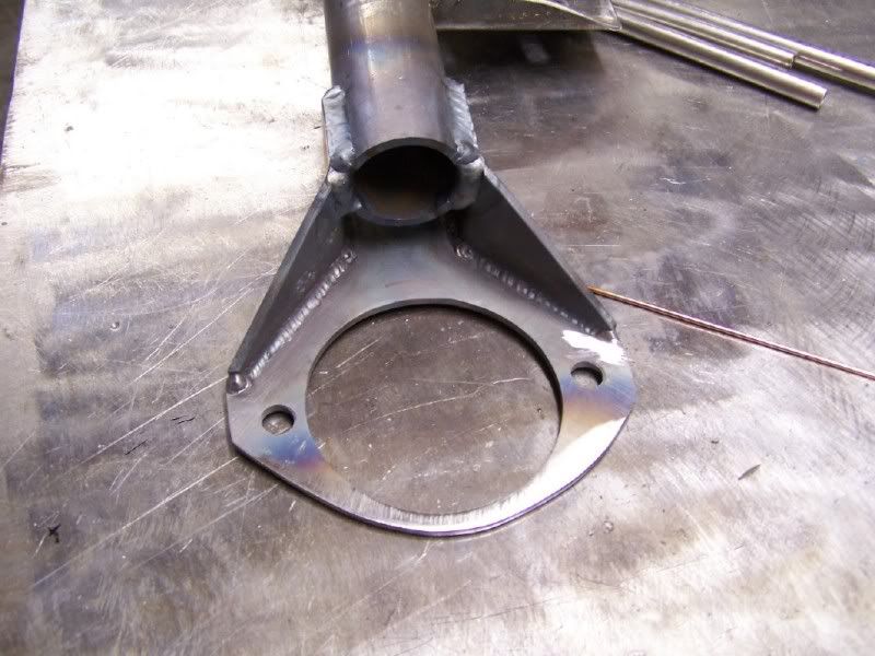

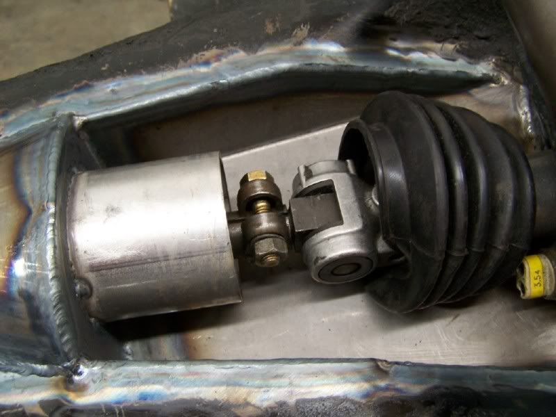

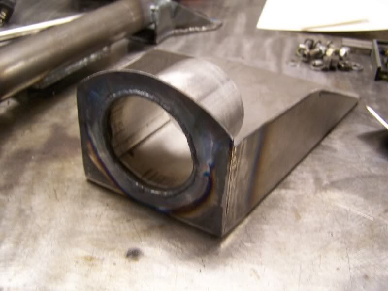

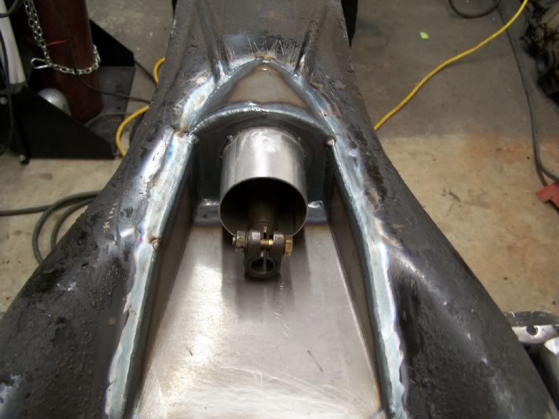

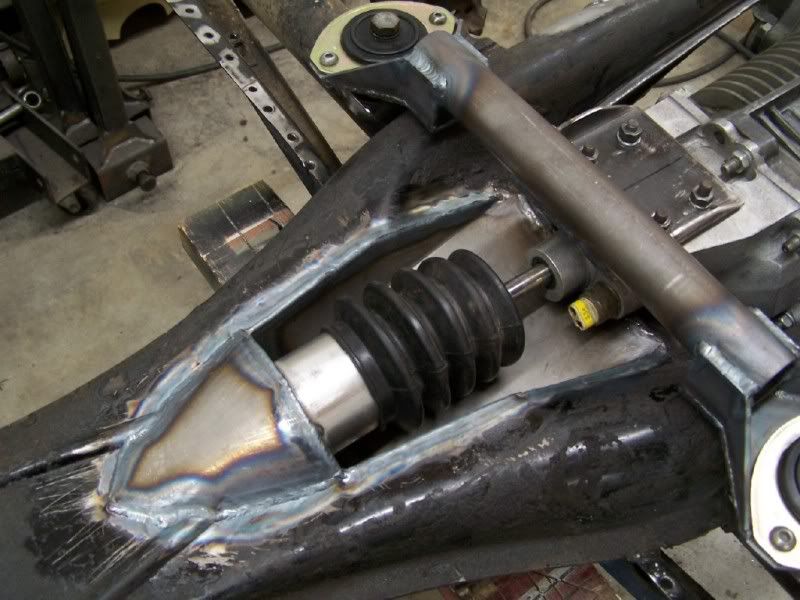

OK. This should be the last mount bar (I think) The mounting pads on the pan were for these from the start, but wanted to try other mounts just to be different. The boot is from the 911 the trans came out of, and seemed like a good way to keep water out of the tunnel. So, had to put the fab skill's to work again on a "box" for the shift rod and linkage to come through. No getting in the back of the car anymore to remove the shift rod coupling!

That is absolutely SUPER how you made that shift rod entry box and seal!!
Never seen it before, but should be the standard from now on :)
I should have done s/th simularly...
ricola January 1st 2010 07:09
Now we're talking! That's superb... From looking at it the only improvement I can think of is to extend the fillet pieces from the trans mounting plate further up the bar to better resist twisting. I've just finished painting my pan but you are making me consider changing it already!!!

That came out sweet. Great idea to use a bus boot. Looks very clean.
