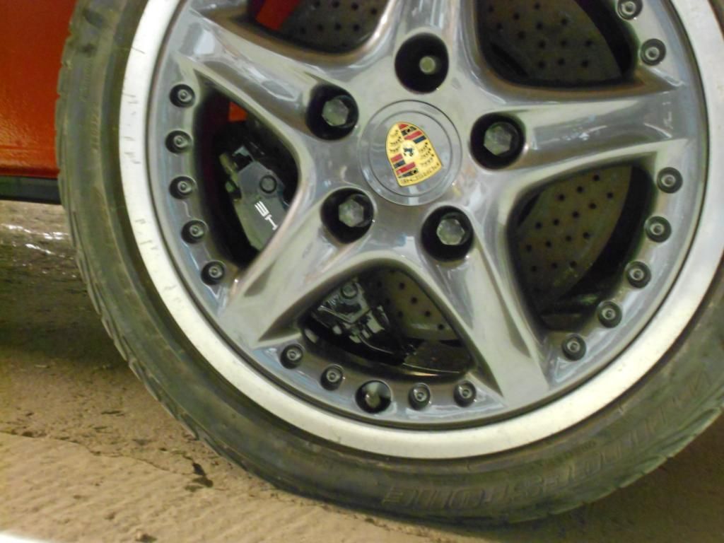

It looks awesome! Was it hard to machine dropped spindles to accept those brakes or it was not an issue? :D
NO_H2O February 7th 2011 12:37
Bright red paint, big @ss brakes. I love it.

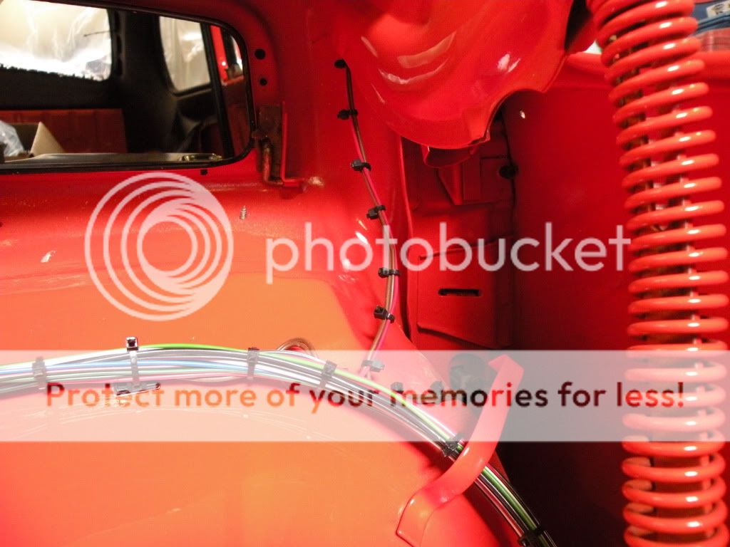

Ive got my wiring loom in - just needs connecting up. all made from scratch using modern thinwall wire with a few extra wires for guages etc.

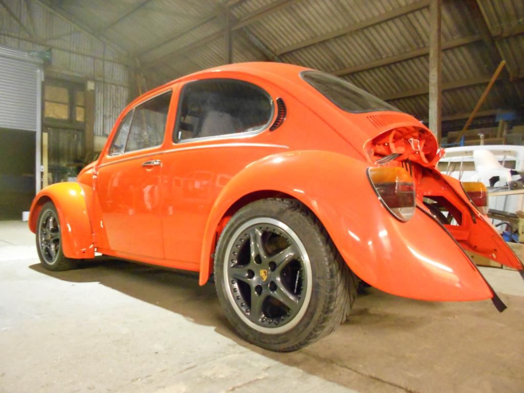

got my genuine front bumper fitted up and new hella headlight rims
http://i591.photobucket.com/albums/s...k/DSCN2461.jpg
NOS rear light back plates and hella lenses too!

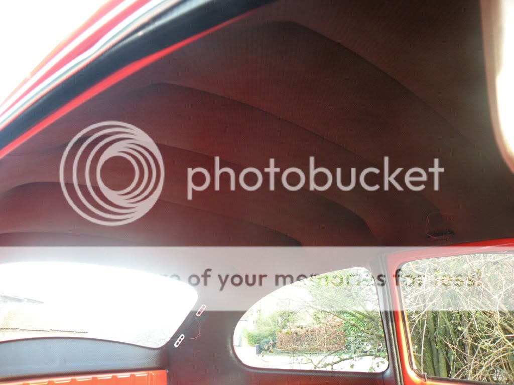

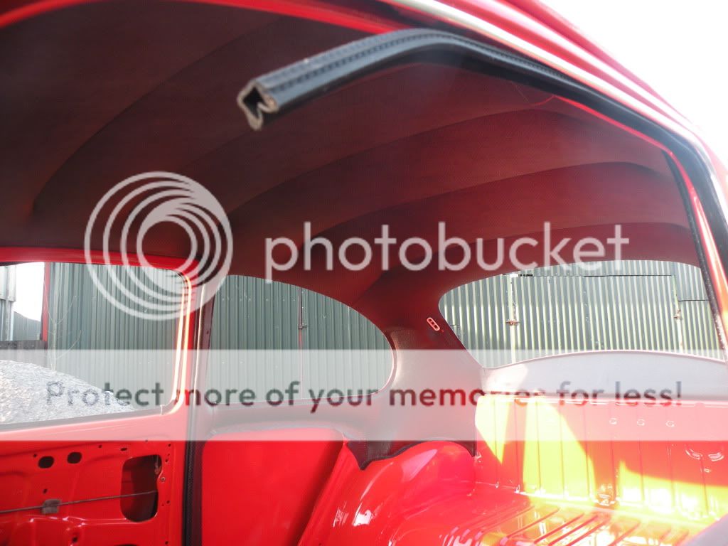

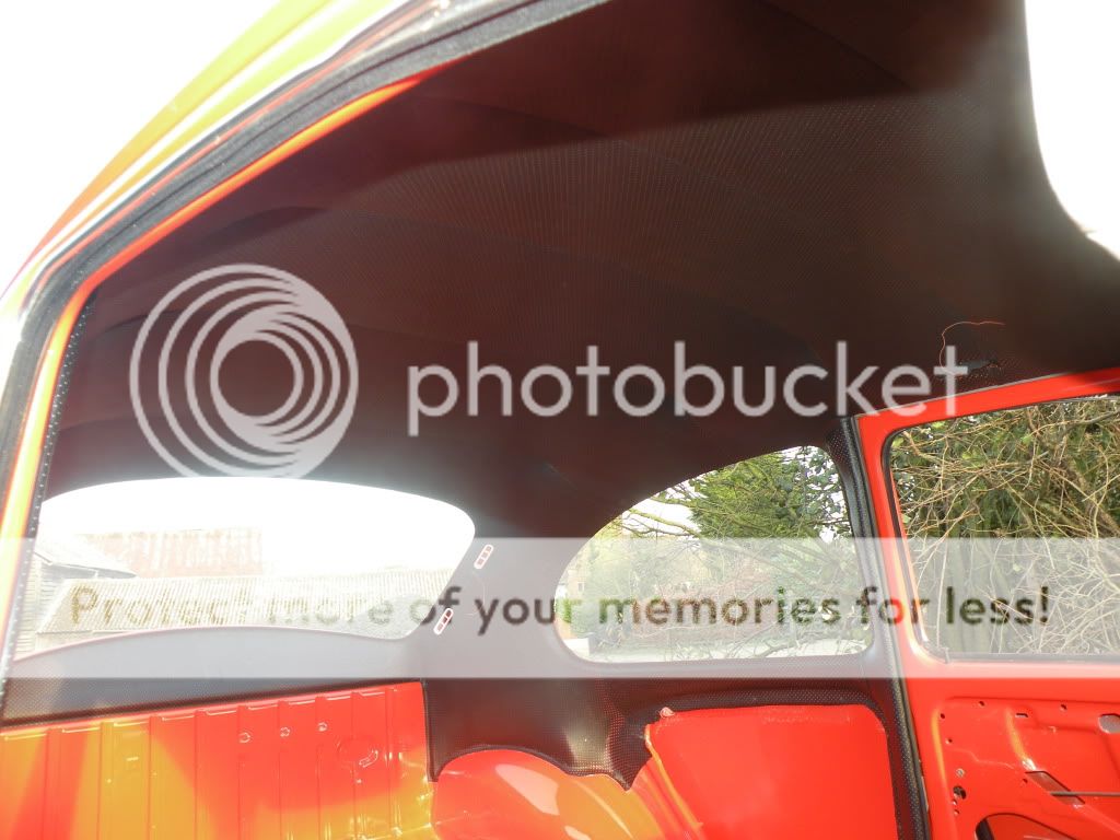

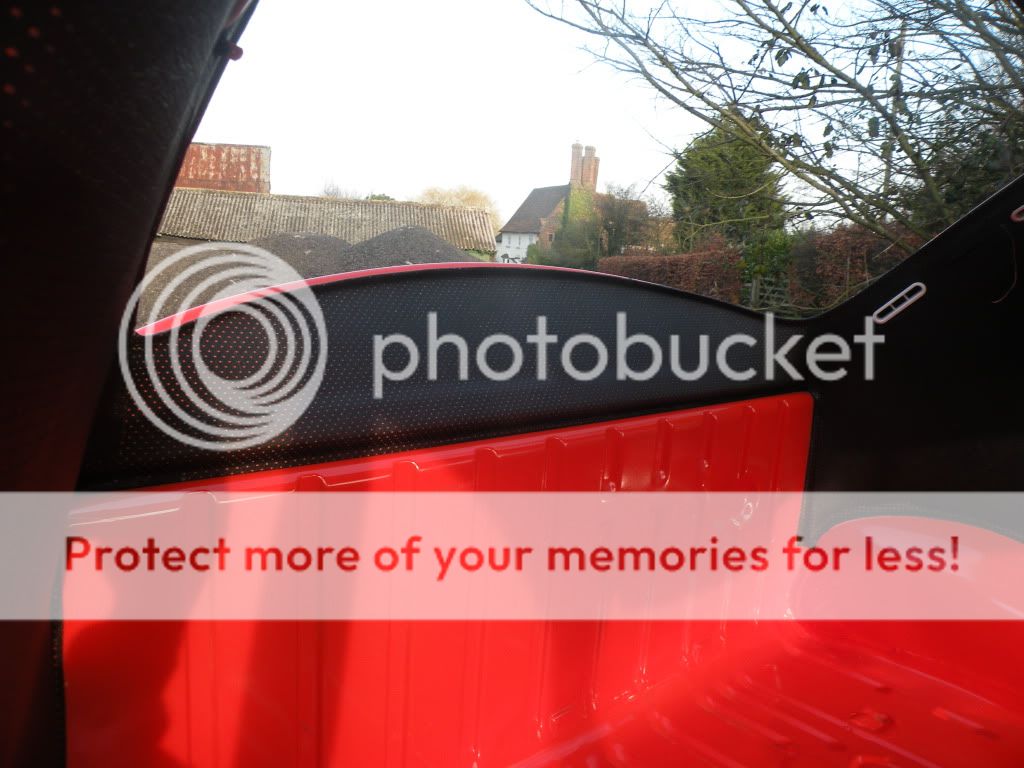

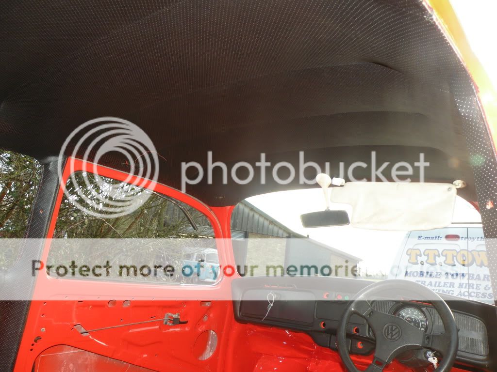

NO_H2O February 25th 2011 09:33

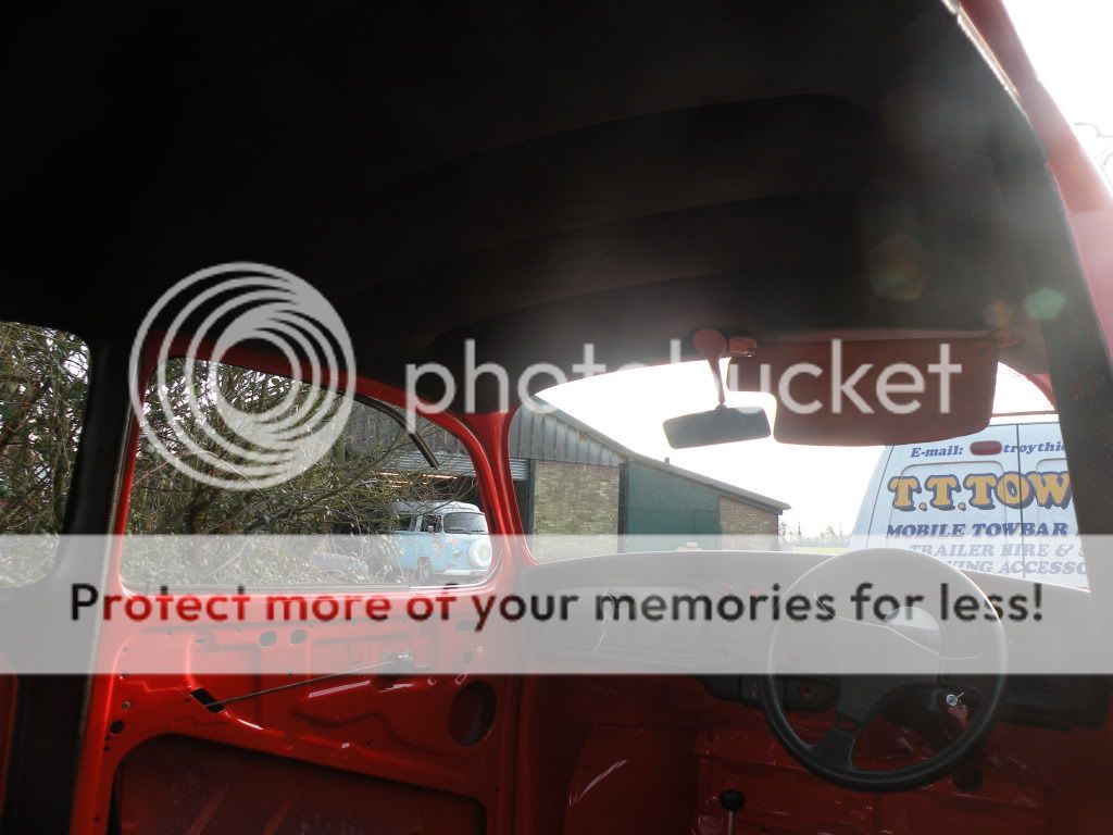

Looking good. Headliner came out great.
Clatter February 27th 2011 12:45
You Suuuurrre you don't want to take those white items off,
Rear-view mirror, visors, rear cabin vents, etc,
And dye them black to match the headliner?
That white, just...
Nevermind me,
I'm here to pick nits!:D
(Pretty easy to tell who's the jealous one here)
dub_crazee February 27th 2011 14:35
do ya think il be running dirty old white interior bits after the extent ive gone on this car ;) they were just put in holes to make sure thehealiner had been cut in the right place. al interior gubbins will be new black to match the rest :)

onixbonilla March 1st 2011 21:05
Very tastefull build. Solid parts choice and coming very nice. Engine details? Only thing not like is the black headliner make the interior looks smaller that it is, but that just my opinion.:)
MX67 March 4th 2011 12:34
That black headliner looks cool to me. But I also agree interior now looks smaller. Anyway, You don't have to do roof chop to get "that" feeling :D
Clatter March 4th 2011 20:06
I recently put a black headliner in my oval.
Makes the cab feel more cosy, like a regular car,
Not concert-hall cavernous like it does stock.
i remember my first ride in the back seat of a bug, and noticing how huge and high and round the roof was.
Wasted space, really.
if they weren't so damn hard to chop...
dub_crazee March 6th 2011 04:59
each to their own i gues. i like the black as it goes well with orange and i wont be having a back seat so i gues that'l open things up a bit. i also wanted a more modern look as clatter says. a lot of the modern audis have dark interiors and i think they look ace.

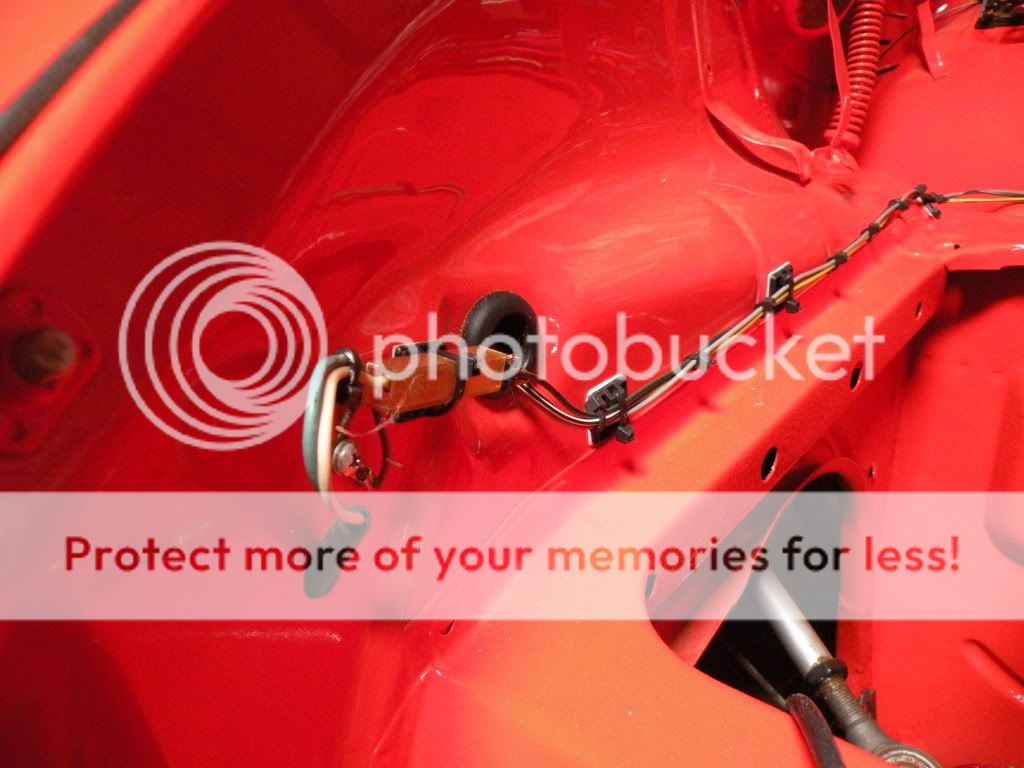

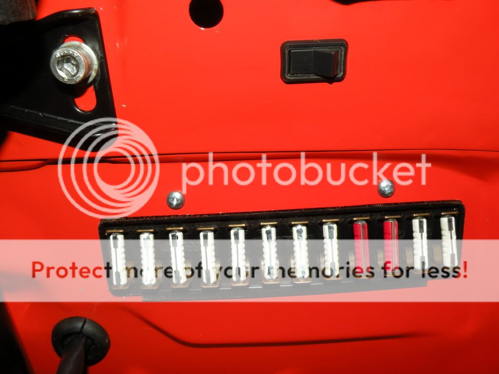

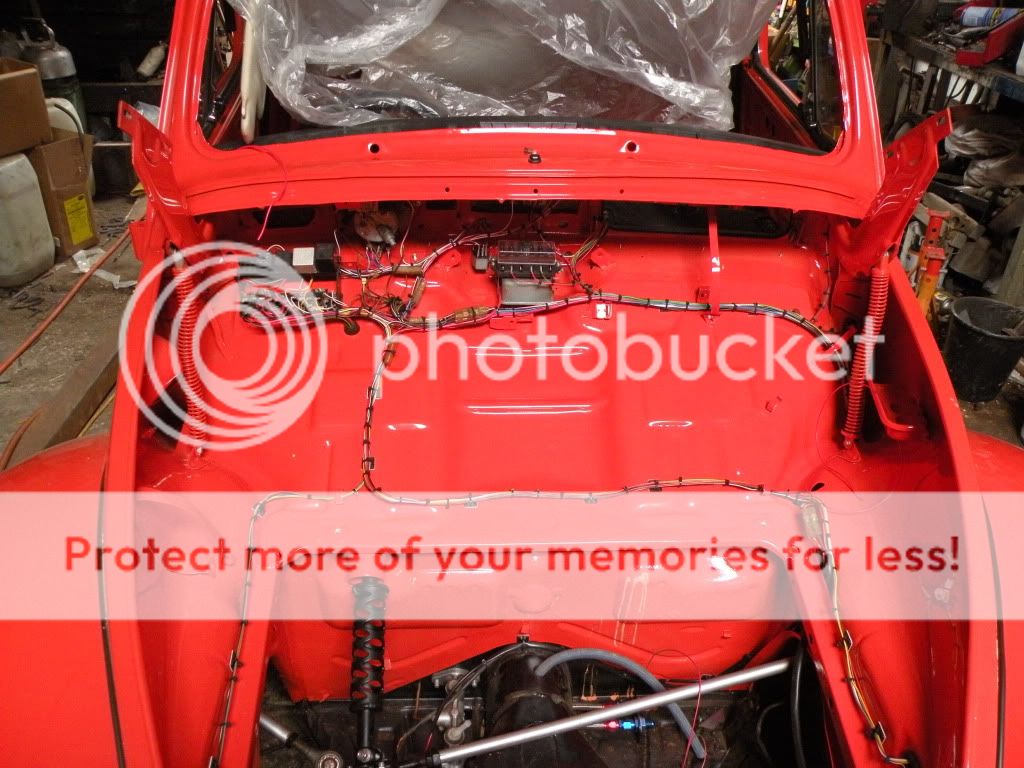

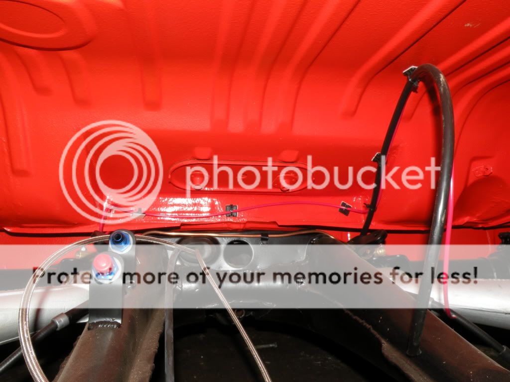

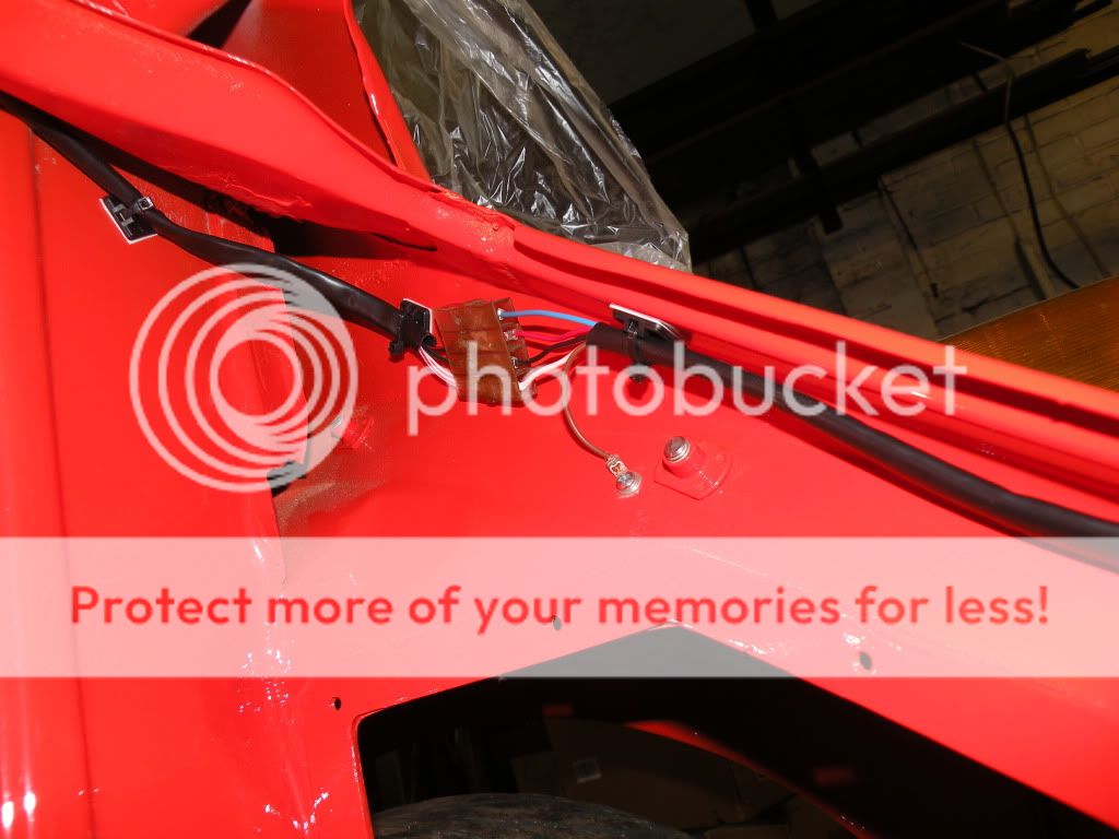

ive done a bit more and the majority of the wiring loom is in. just have the headlight switch to wire up and then start tidying the wiring. :D

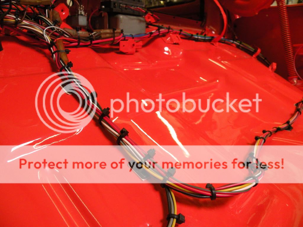

dub_crazee May 18th 2011 14:12

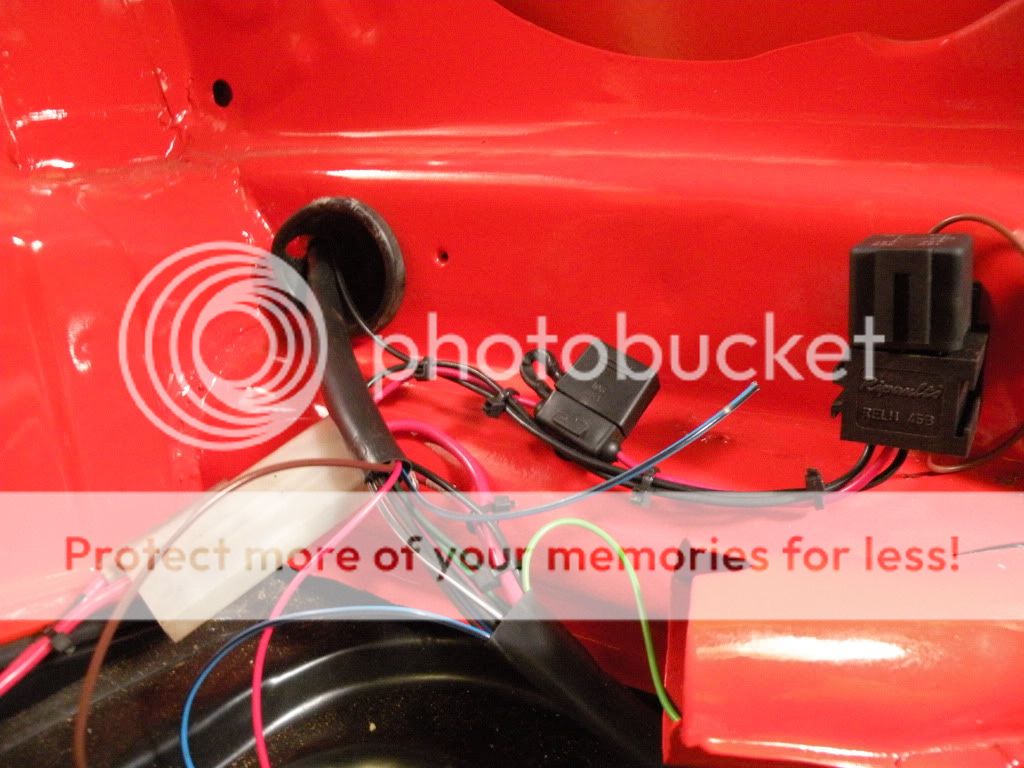

Right....finally got to do some more work on it!!
Craigs polished under the bonnet and i finished the wiring loom.

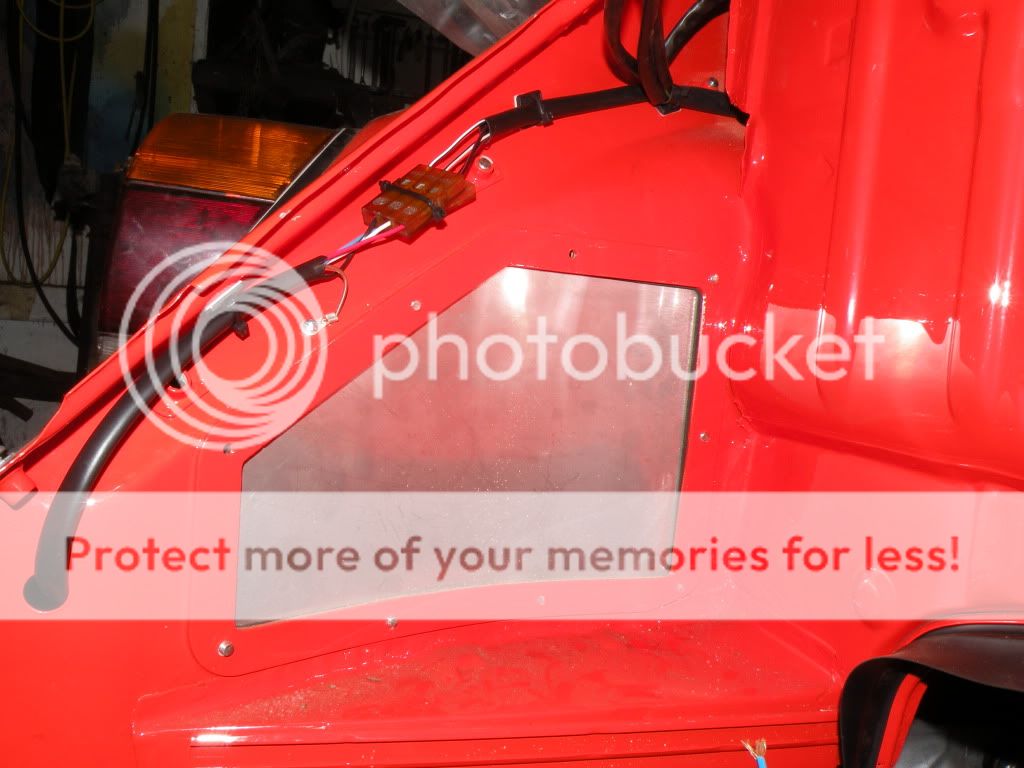

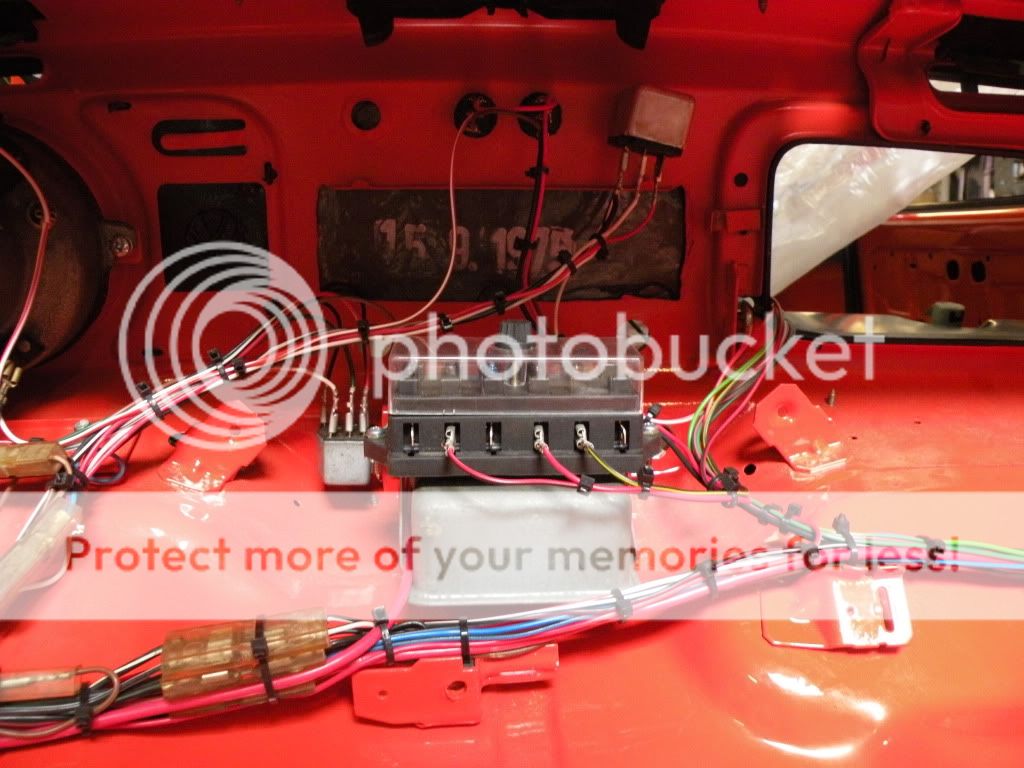

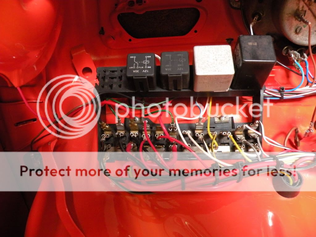

Some of you may wonder why im using old VW connector plugs and uninsulated terminals. Basically i wanted to make the loom look like in belonged - original but slightly better. All the wiring is in standard colours with a few little extras. Ive added wiring for my guages (tacho, pressure, temp etc), ive added electric washer bottle wiring which works off of the wiper stalk, front and hear heated screens, lineloc and fuel pump. The fuel pump is wired in on a relay circuit so if the engine cuts out eg in an accident, the fuel pump cuts out. I wired in the original heated rear screen switch to work the pump when i need to prime the system before starting the engine ----> pic

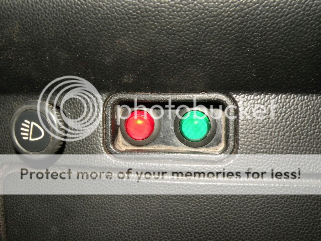

and these two are my heated front and rear screen in place of the electric fan switch
http://i591.photobucket.com/albums/s...8.jpg~original
http://i591.photobucket.com/albums/s...0.jpg~original

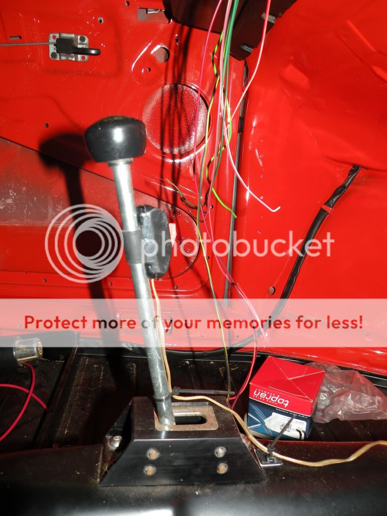

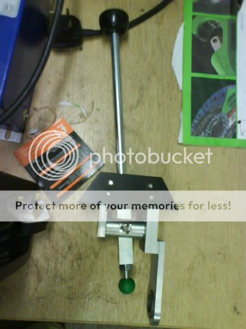

and finally shifter with lineloc button (all the wiring hanging through the glove box is for guages)
http://i591.photobucket.com/albums/s...9.jpg~original

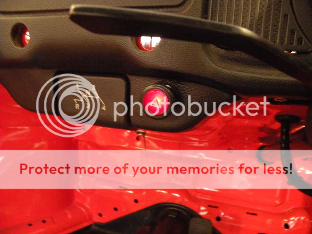

i just need to decide what to do with these two holes in the dash
http://i591.photobucket.com/albums/s...1.jpg~original
i was thinking about getting two hazzard switch knobs which light up - and changing the colours of the plasic so they look factory but can have one as a shift light and one as a line loc light
Xellex May 18th 2011 17:26
I love what you did with the wiring! Everything is so nice and organised.. I tried to do something similar in the engine compartment for the last month. An I actually see some stuff that I used too, like that small 6-fuse box.
What is the part number on the fuel pump relay? I heard of those special relays after I did my relay panel, and saw one on CSP for 60Eur or something. But I think all the old fuel injected watercooled VW's have it too. Just gotta find out the number that should be on it. I saw that all VW relays have that big number on top of them.
Oh, and do you take the signal for the relay from the negative side of the coil? I wonder what I'd have to do in my case... maybe from the Megajolt tacho signal or something.
owdlvr May 18th 2011 23:46
Factory part number 443 907 385 will work. Otherwise look up a relay for a 1985 Audi 4000 quattro. Part number may be different, but they are interchangeable.
http://www.rockauto.com/dbphp/x,carc...ump_Relay.html
Relay Terminal | Description | Connect To
15 | Switched +12V | Coil (+)
31 | Ground | Chassis Ground
87 | Fuel Pump Power | +12V Directly from Battery (remember to add inline fuse)
30 | Switched/Fused Power | Fuel Pump (+)
31b | Trigger Input | Coil (-)
The circuit requires that the coil be in the circuit. Just applying 12V to the trigger input is not enough. The circuit relies on the higher voltage pulse that is generated by the coil. Not sure how you would use that with Megajolt. I have successfully used these relays in tonnes of cars, including a '77 mustang with weird Ford electronic ignition.
HTH,
dub_crazee May 19th 2011 02:18
The relays s just a cheap 5 pin relay. about £4 and heres the diagram - no need for the coil to be involved
http://i71.photobucket.com/albums/i1...umpcircuit.jpg
hope this helps :)
Xellex May 19th 2011 08:18
haha, that's ingenious! So as long as the alternator is charging, the fuel pump will work. Nice one!

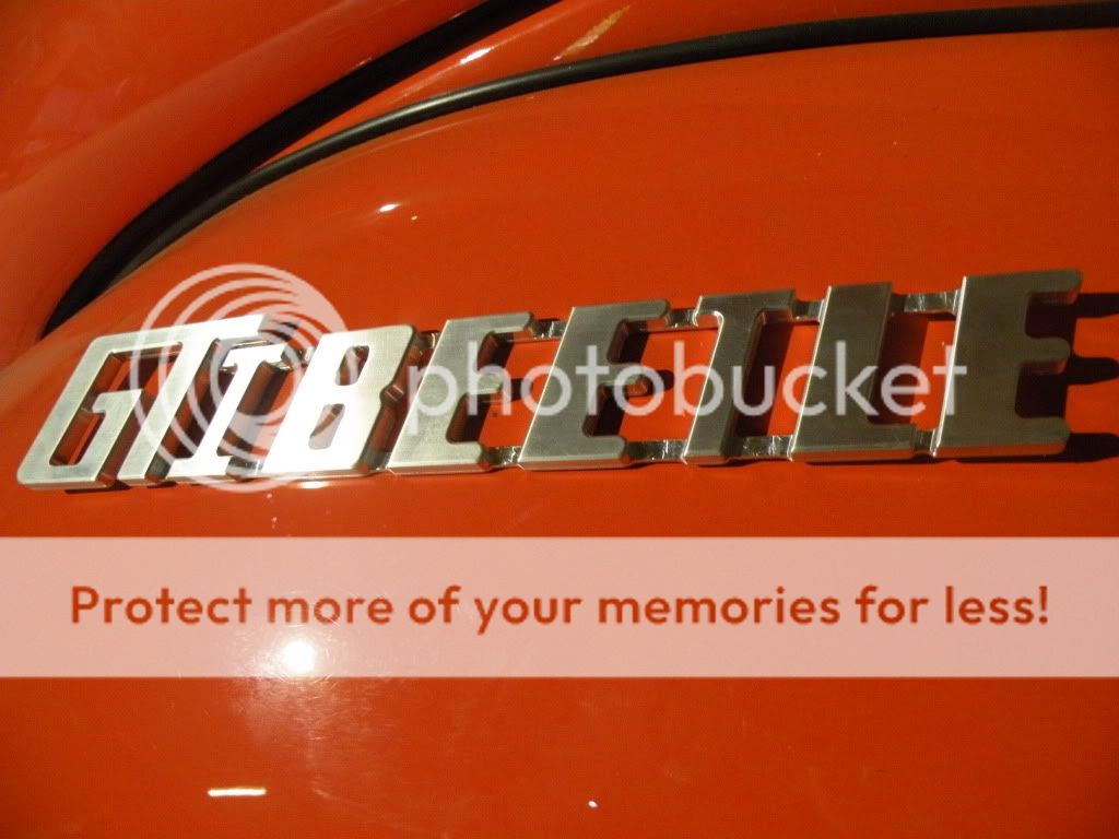

dub_crazee September 11th 2011 12:12

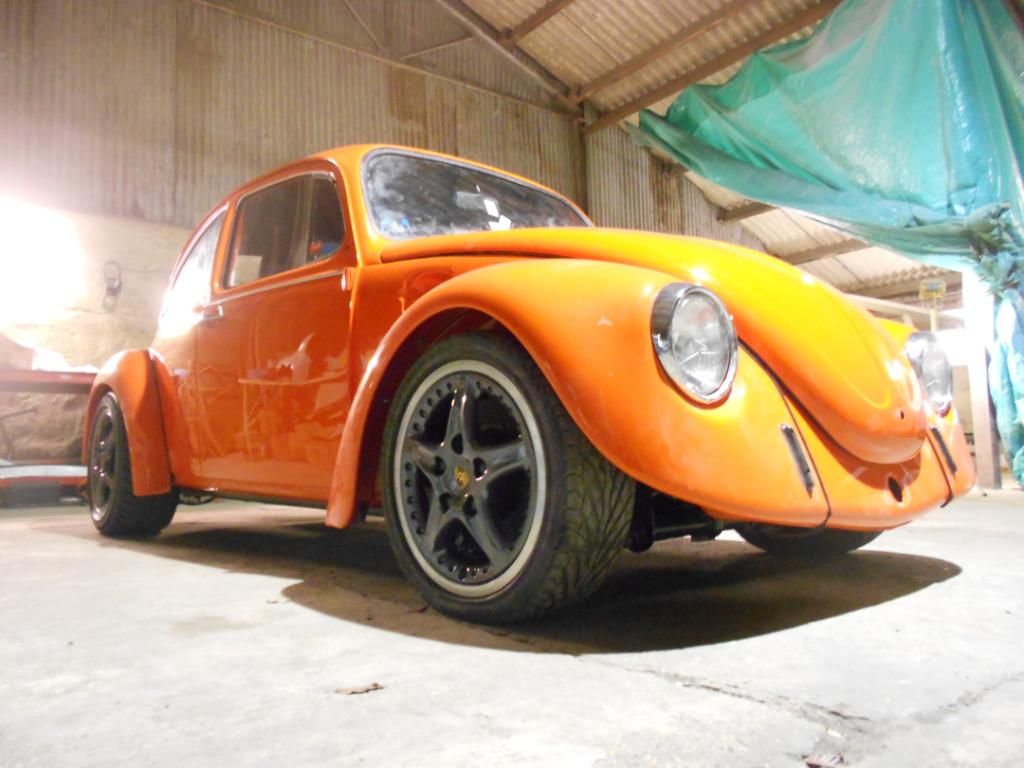

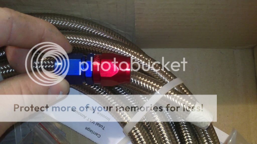

Well it's been a while since ive posted - and to be honnest ive not got a lot further on. i've been very busy working on friends' cars and starting up my own business so it's been hectic! I've put my 996 seats in and fitted up black sun visors and rear view mirror which isnt exactly exciting but i will be ordering engine bits this month which is a step in the right direction :D also, i had this made......which some of you may like.....and others may think it's a waste of time as it's not following the function over form rule of GL....
http://i591.photobucket.com/albums/s...6.jpg~original
i'm absolutely chuffed with it!
also, all of my calipers have been refurbed and painted.....and the front beam is off for some custom shock towers. once that's done the front end can be completely assembled and finished just leaving me with painting the gearbox and building the engine. deadline for completetion is last weekend in march (volksworld show)
NO_H2O September 12th 2011 07:58
Nice touch.
Steve C September 12th 2011 08:33
I like the badge.
Regarding the fuel pump relay, I used a BMW one on my sons 1303, it primes in the start position.
Bosch relay PN# 0 280 230 001 (BMW 520i 1992) and have the following terminal information:
50: Start Signal (from starter or ignition switch crank position)
87: Switched 12 volts (out)
87b: switched 12 volts (out to pump)
31: Ground
1: negative side of coil (trigger to keep relay engaged - engine running signal)
30: +12 volts supply (switched 12 volts in )
15: +12 volts supply from ignition key
al_kaholik September 12th 2011 20:05
Very cool Dean. How did you have that done CNC? Subtle is good.
dub_crazee September 17th 2011 06:13
cheers :) yeah cnc machined. GT badges are becoming quite rare and a lot of money - i can get GT badges made if anyone wants one. (GT not the GTi one)

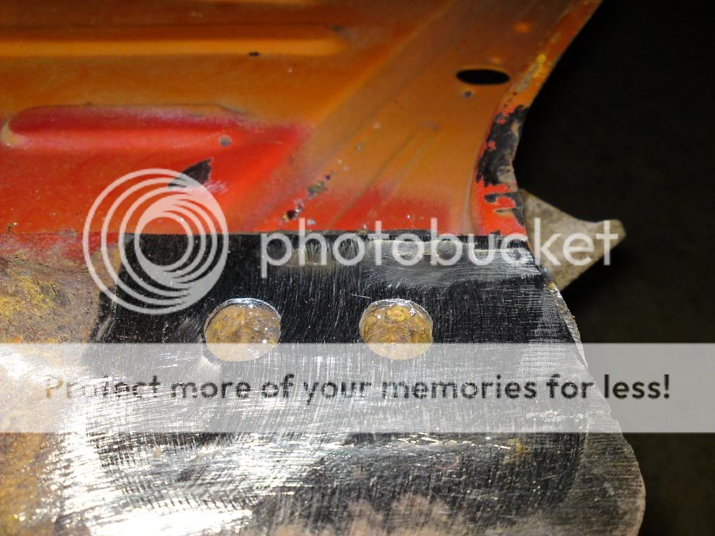

i also removed the bonnet seat strips off of the front - and cleaned the rust underneath.
Did you end up replacing them, or leaving them out? How are you sealing your hood?
-Dave (who's project is currently at the "do I remove the strips" stage ;-) )
Bruce. September 18th 2011 11:01
Use the bonnet seal that attaches to the bonnet not the slam panel.
The original metal strip for retaining the seal is a pita rust trap.
owdlvr September 18th 2011 13:56
Does that bonnet seal go around the top too? I ordered one for my 69 and it was too short to go all the way around the hood.
dub_crazee September 18th 2011 14:54
no - i removed the old strip along the front scuttle - repaired the rust and then replaced the strip along the top - i had to buy the mexi seal (clip on one) and the standard one so i could trim it and use it along the top
owdlvr September 18th 2011 15:31
Thanks Mate!

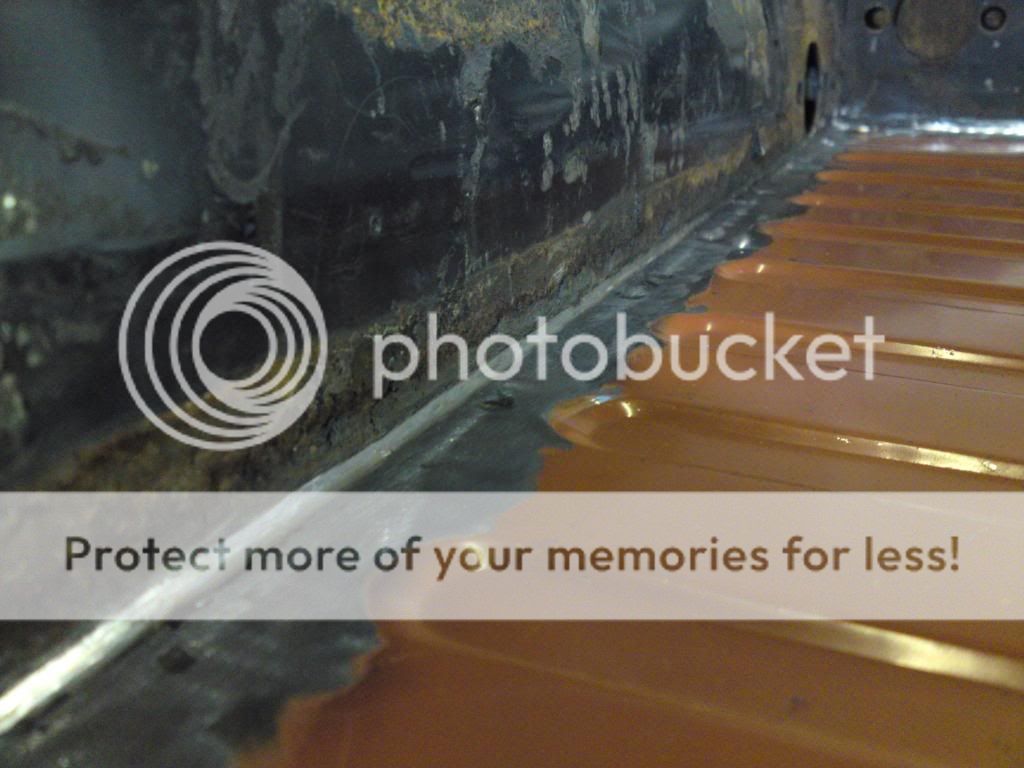

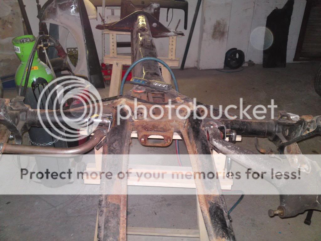

aircured November 9th 2011 10:47

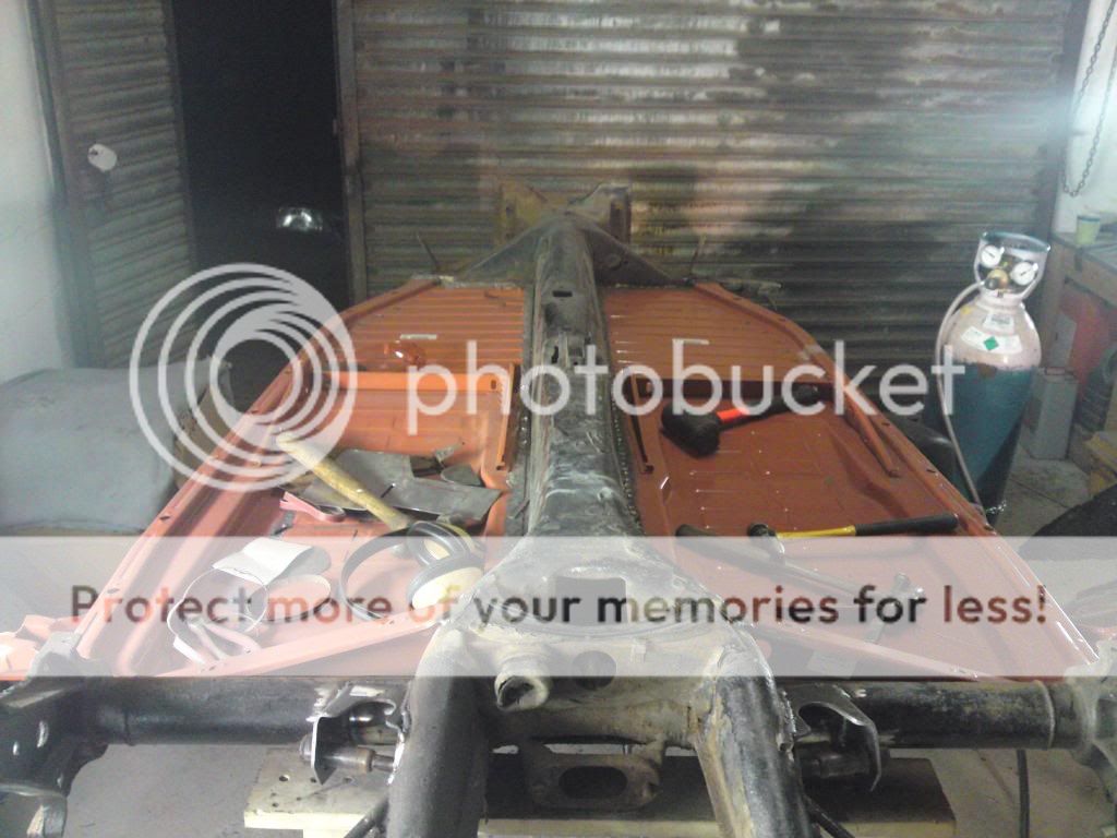

Originally Posted by dub_crazee (Post 73522)
i started this project october 2008 - starting with a 1976 body and 1969 chassis. I started off with a 1976 beetle i had since i was 15 - and acquired a 1969 chassis to IRS.
a couple of pics before
http://i591.photobucket.com/albums/s...2.jpg~original
First up was new heavy duty floorpans and IRS conversion with 944 Turbo a arms

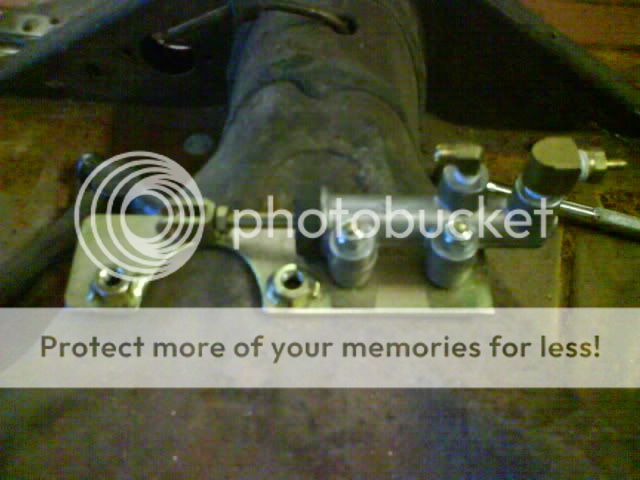

The chassis has also received a couple of small repairs to the framehead, a hydraulic clutch set up a a bug@5 speed shifter

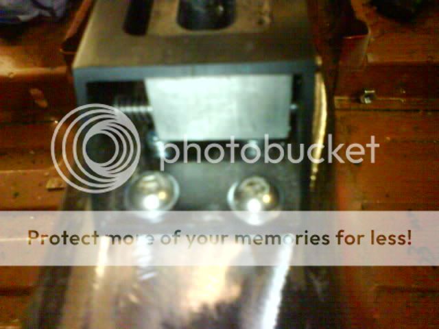

the clutch MC was fitted through the inspection hole (had to be slightly enlarged) and a hole made behind the throttle lever arm cover for access
http://i591.photobucket.com/albums/s...7.jpg~original
i think this is a much better way of installing it rather than cutting a large hole in the top of the tunnel as suggested :)
have you got any more information about the hydraulic clutch installation.
cheers
al_kaholik November 9th 2011 12:17
Pretty sure its a SACO unit that Deano has.
As per usualy I'm looking into MCs that will work with my current CNC slave and in future something else.
dub_crazee November 20th 2011 09:20
yeah Al is right its a saco unit. still havnt decided how to mount the slave - i will come to that soon!

dub_crazee March 5th 2012 15:31
the bug is back now after being at the paintshop with craig until 430 sunday morning redoing a couple of bits i wasnt happy with and refurbing the wheels - pretty happy with how theyve come out!
http://i1104.photobucket.com/albums/...3.jpg~original
http://i1104.photobucket.com/albums/...6.jpg~original
glad i went black caliper rather than red :)
http://i1104.photobucket.com/albums/...9.jpg~original
