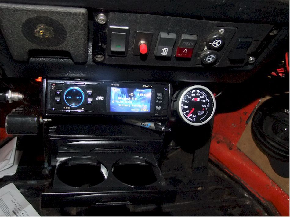

Not really GL stuff but I like a few comforts in my bug. I've been driving around without any sound system since I got the car on the road, so I now have blue tooth for my phone, Ipod and radio to find out why I'm held up in traffic.
I fitted a JVC unit I've had for about 6 years waiting to be fitted, I also fitted a cup holder on the bottom of the radio bracket.
I also fitted a resistor in my LED high beam warning light circuit, it was way too bright and while I had the dash apart and I also installed an air intake temperature gauge. As you can see it was 30 C in my garage that night.

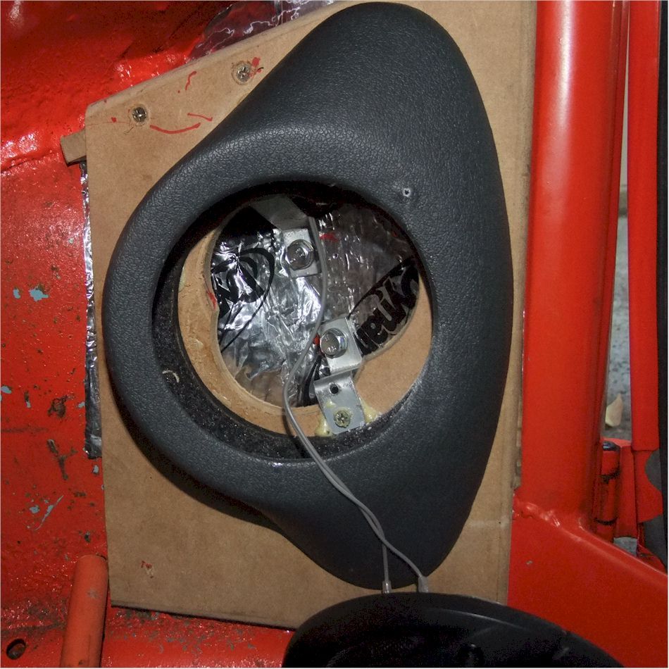

I made up some front speaker mounts, I bolted these into the front footwell area. When I was drilling holes for the nutserts I used a bit of conduit to prevent my drill from going in too far and damaging the inside of the front 1/4 panel, its also handy if drilling near wires etc. BTW these speaker mounts will carpeted in the future.
http://i1184.photobucket.com/albums/...c.jpg~original

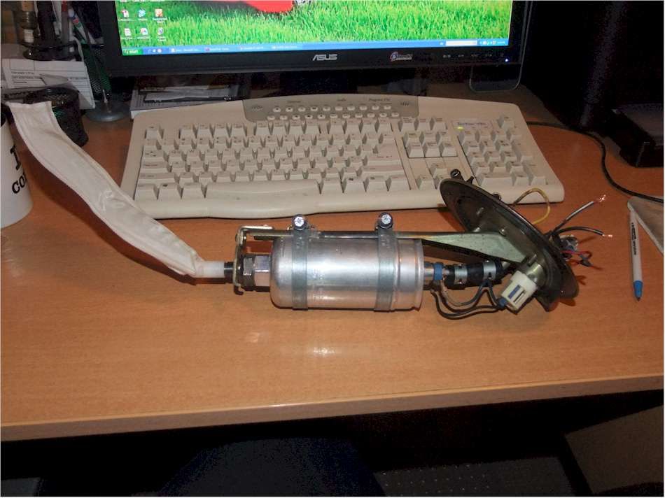

I've been collecting bits for my in tank 044 pump set up.
A friend has a Mazda Famlia that he tracks and he had a spare fuel pump housing that I could use for my set up. I had a weld in base for the fuel pump profile cut.
I went to my local EFI place http://www.afiaustralia.com.au and scored pump inlet filter, then I had my neighbour turn the 044 inlet fitting down to fit into the filter.

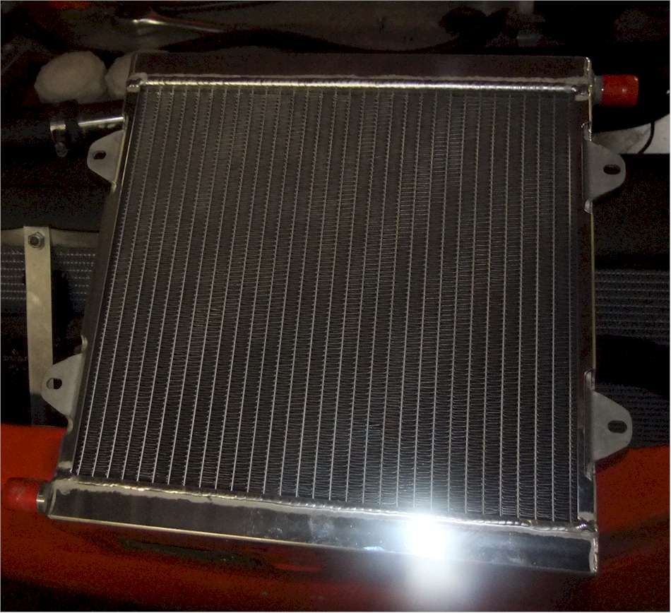

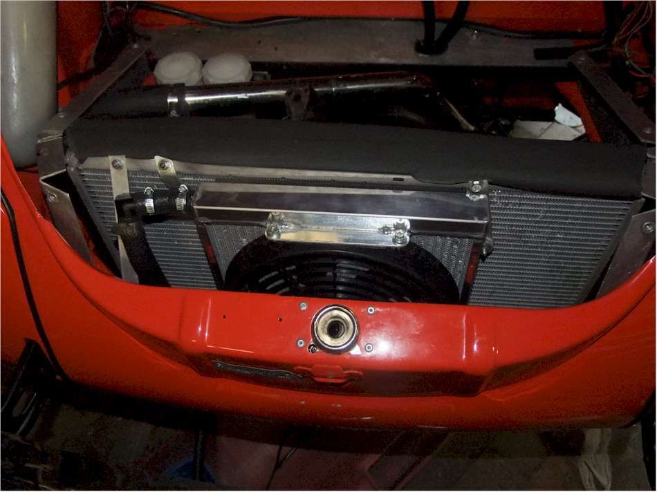

I'm also upgrading my intercooler radiator to a proper PWR unit.
http://i1184.photobucket.com/albums/...4.jpg~original

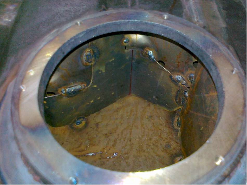

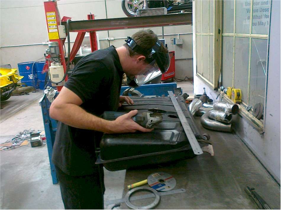

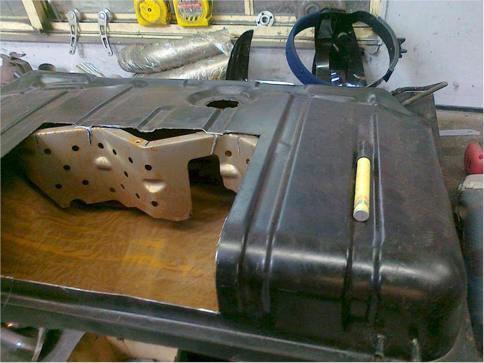

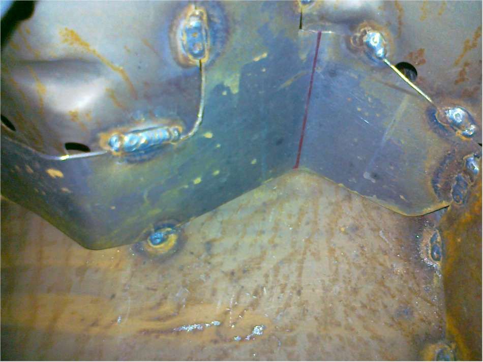

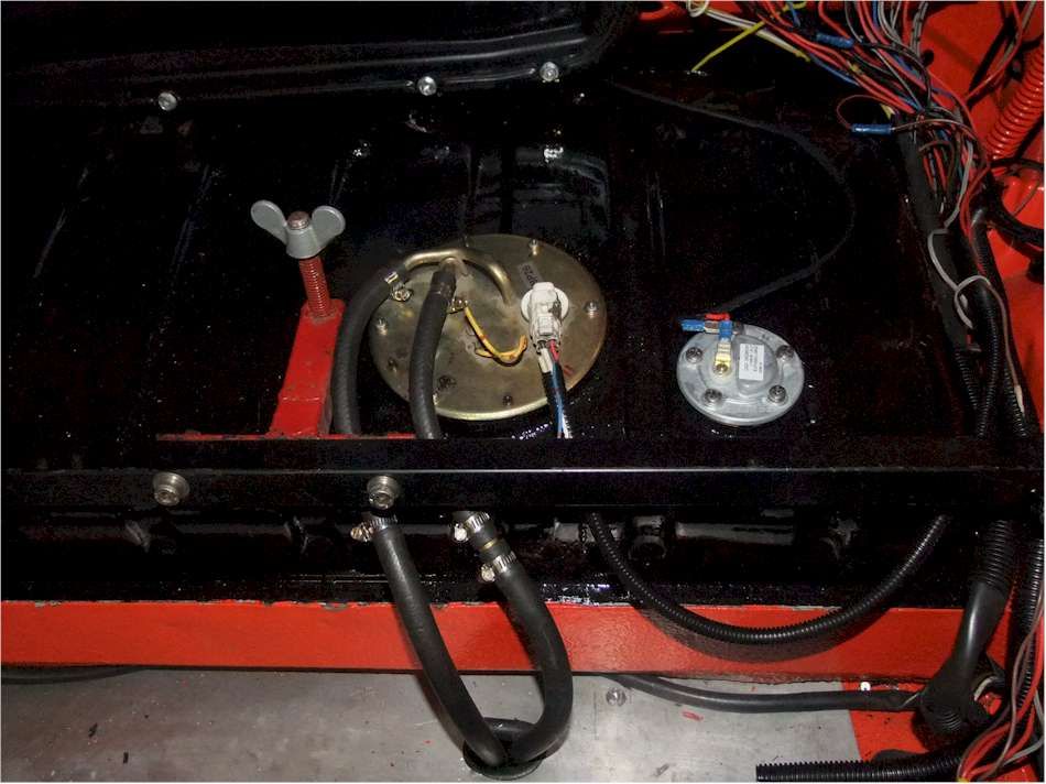

I had Brad at Westside modify my fuel tank to fit my 044 pump internally.
I washed the tank out 4 times with hot soapy water, no surprises.
http://i1184.photobucket.com/albums/...9.jpg~original
http://i1184.photobucket.com/albums/...2.jpg~original
Pictures tell the story.

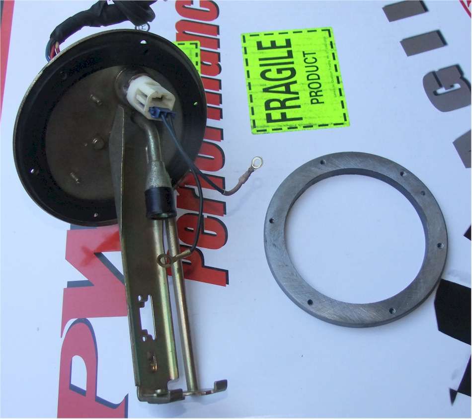

I also had Brad fit a Kombi tank sender, it was the only one Vintage VeeDub had in stock with the same ohm reading as my VDO fuel gauge. works great, I put 10 litres in and it read 1/4, filled it up and it read full, my tank holds about 46 litres. The stock 1302/1303 send would have been in the way.
A friend has Mazda Familia track and he gave me one of his spare pump housings, Brad gave a me useful tip, buy the special in tank hose for the fuel pump connection, normal fuel hose will disintegrate over time.
So I went to http://www.afiaustralia.com.au/ and picked up the special hose.

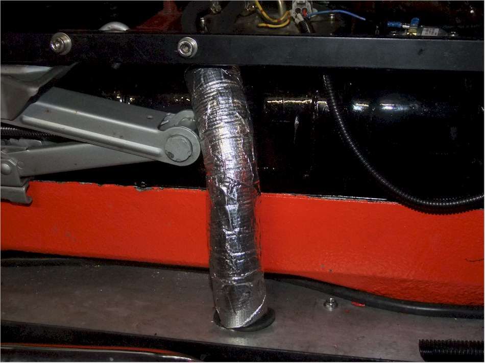

The reason I went in tank pump was to reduce the heat build-up in the pump, I covered the fuel hoses with some 1303 dash vent hose covered in an insulating tape.
http://i1184.photobucket.com/albums/...1.jpg~original
I drove the car last night and the new PWR intercooler radiator seems to be doing better than the old RS liberty one I had before.
http://i1184.photobucket.com/albums/...e.jpg~original

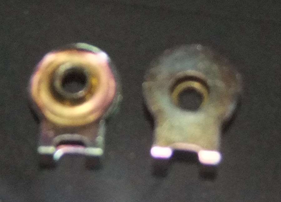

The 1303 fresh fan housing cover is held in place by self tappers and speed nuts, I've never liked that so I used some M6 J nuts.
http://i1184.photobucket.com/albums/...6.jpg~original

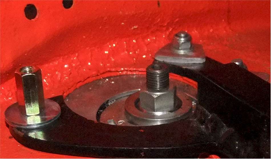

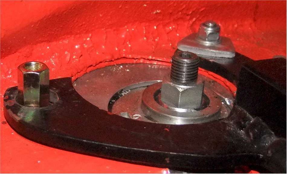

The one complaint I have of the K Mac strut tops is that if I ever need to remove my strut brace I would loose the camber & caster settings, so I drilled out one of the strut brace holes and used a M8 rod joiner in place of the normal nut, now if I need to remove my strut brace to remove my fuel tank I can use the one nut to hold it all in place.

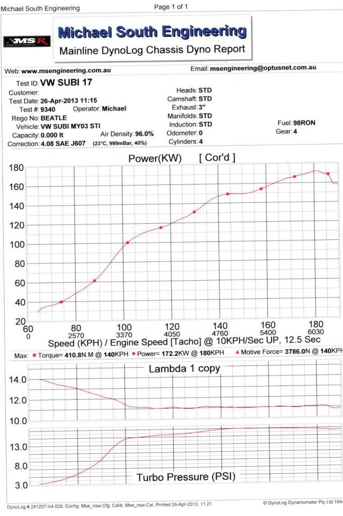

Went for a dyno today on the NSW Central Coast, caught up with Jak for a coffee while I was there.
Didn't make as much as I was expecting, with a few teaks he said it should make another 30-40 kWs

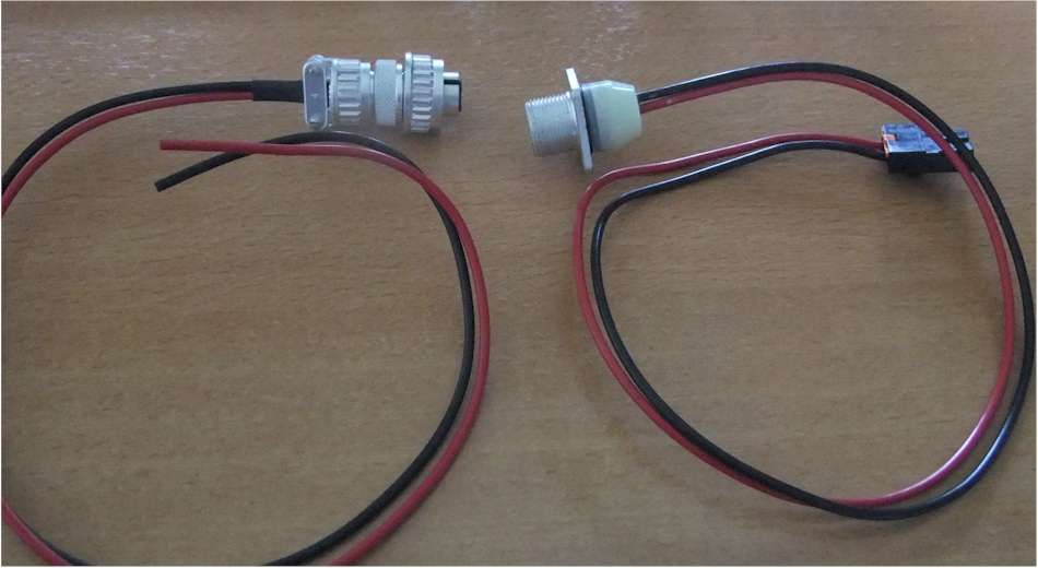

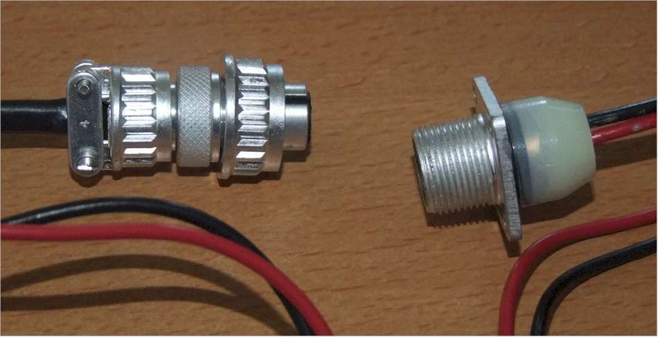

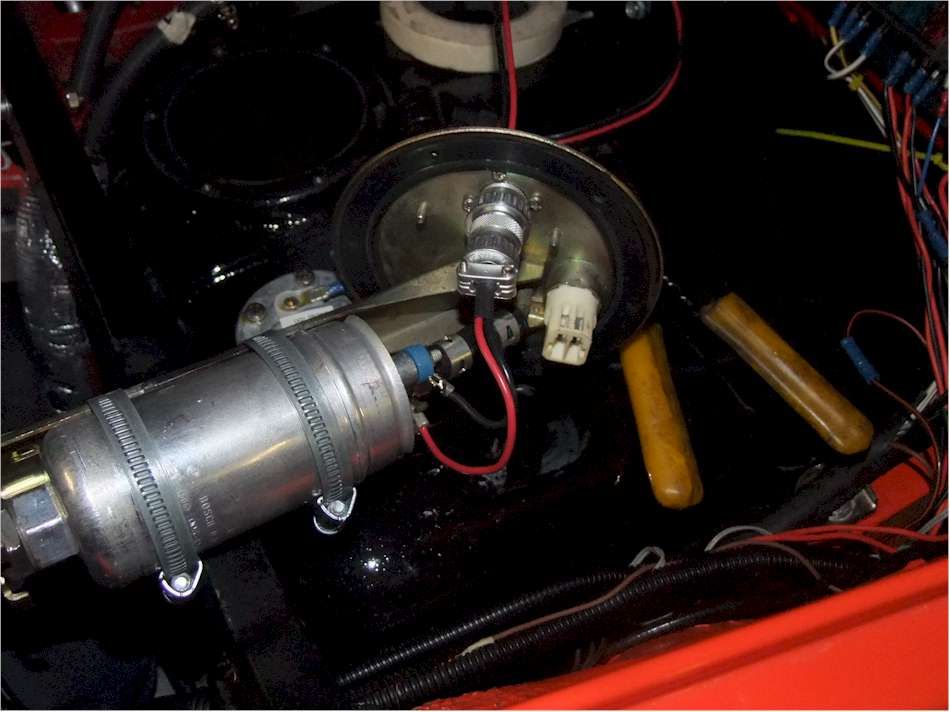

I was thinking that the wire on my Mazda in tank fuel pump may have been a bit puny to run the Bosch 044 pump.
I trawled the Internet to find a place that sold bulkhead fittings for in tank pump wiring.
Normal car electrical wiring is not fuel proof, I found these units on the HOERR site, not cheap but good insurance, there made by Fuel Safe.
http://i1184.photobucket.com/albums/...7.jpg~original

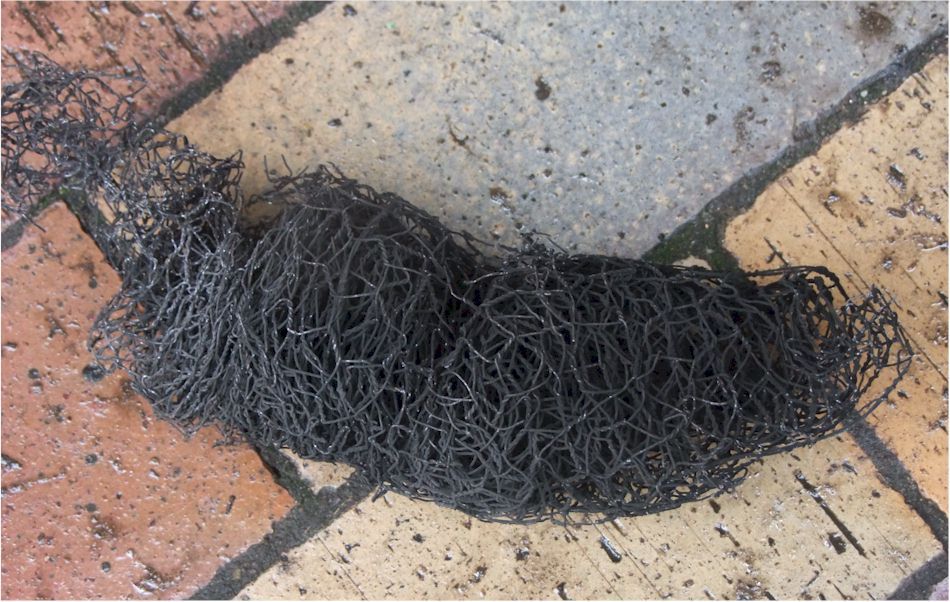

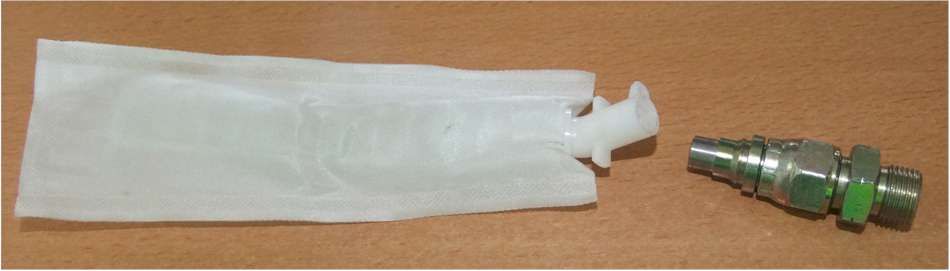

I still have a heat issues in the fuel system, I had to use the car in peak hour traffic last week and the pump started to make some funny noises after about an hour of it, then when I had some clear road I booted it and it appeared to run rough.
After my meeting when everything was cool again it was back to normal.
I'm pulling the pump tomorrow to check on the pre filter as it may collected some crap from the recent tank up grades and to fit my heavy wiring.
http://i1184.photobucket.com/albums/...b.jpg~original

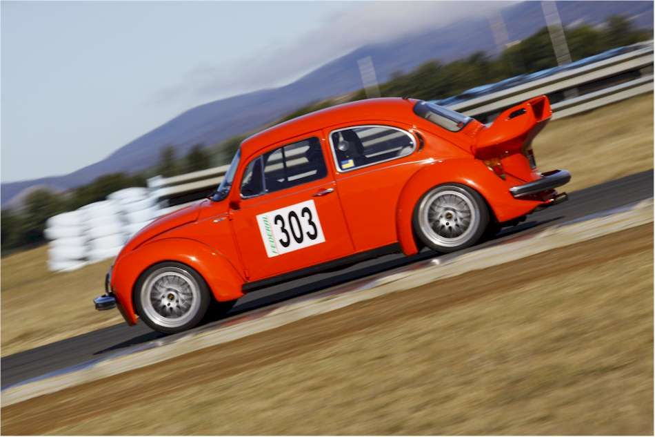

I just ran my first track event at Wakefield Park about, its about 2 hours drive from my house.
At Wakefield I found the coolant temps got up a bit after 4 laps, around 105 c so I will do a bit more shrouding around the radiator air intake, air intakes after the intercooler were 40 c. The coolant temp has never gone over 95 before
Other than that the car ran well on low boost all day, the driver needs some work. My best time was 1:15.0680, the Quaife worked well, I think it helped having no sway bars on the car, it had great traction out of corners, the front felt a bit slippery but after my friends Rudi and Paul told me to harden up, I got a bit more heat into the front tyres and it was much better.
I only did 4 heats, filled up at Marulan about 50-80 ks away on the way down and on the way home and I used 18 litres, very economical.

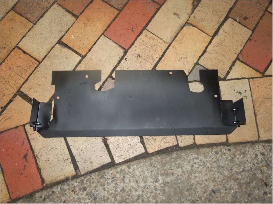

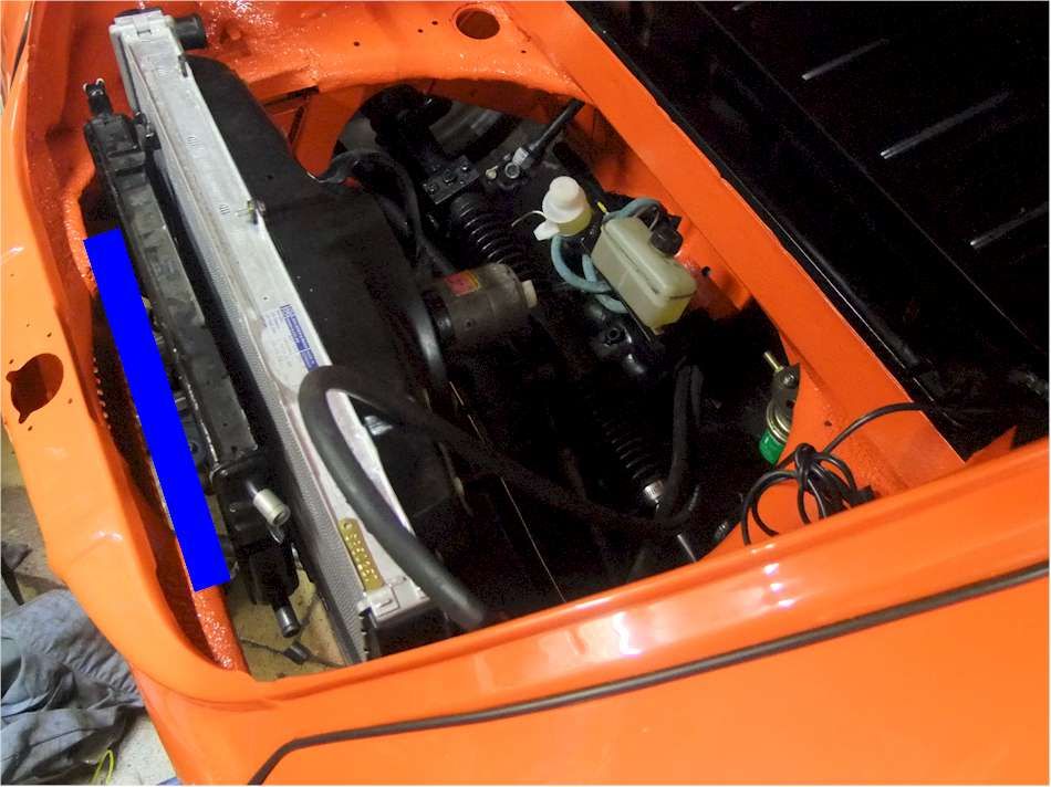

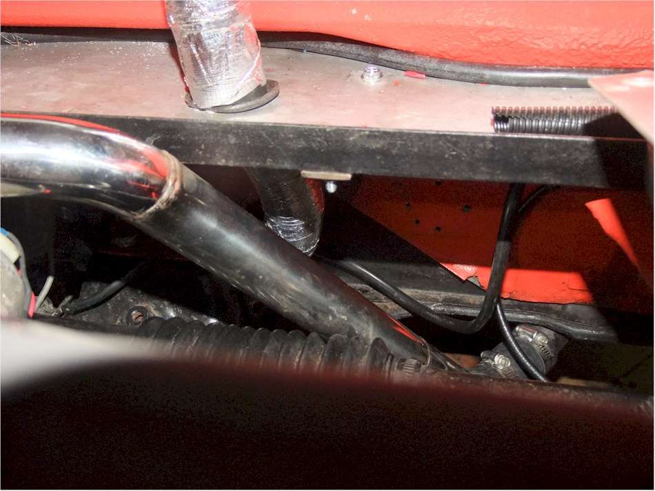

I made up this scoop to fill in the open part of my chassis and to direct air up to the radiator. I also filled gaps between the radiator and the shroud so that any air coming through the grille has to go through the radiator.
My friend Neil at Rust Right did all the folding and guillotining for me, he made my A & B stiffeners for me.
I assumed that all was working well as I had no issues driving on the street, driving at sustained higher speeds showed up the weakness in my design.
http://i1184.photobucket.com/albums/...8.jpg~original
http://i1184.photobucket.com/albums/...d.jpg~original
volkdent May 31st 2013 13:31
For a temporary measure I made one just like that from ABS, it worked great and I havn't yet been able to duplicate the success of the simple design.
Steve C May 31st 2013 23:56
I agree, simple things often work the best.
I've been driving the car around today, the weather was not all that hot today but I've noticed a difference, coolant temp always sat about 90 degrees, now its sitting around 82 which is just after the thermostat opens.
The thermo fan usually comes on if I've been sitting in traffic for a while, it didn't come on today at all.
Non 1302 or 1303 owners may not get what I'm saying about removing the deformation element from the front of the chassis.
http://i1184.photobucket.com/albums/...f.jpg~original
The shaded are is where the deformation element usually sits, I had this section open so air would come into the grille and go back out bottom, not actually doing any work.

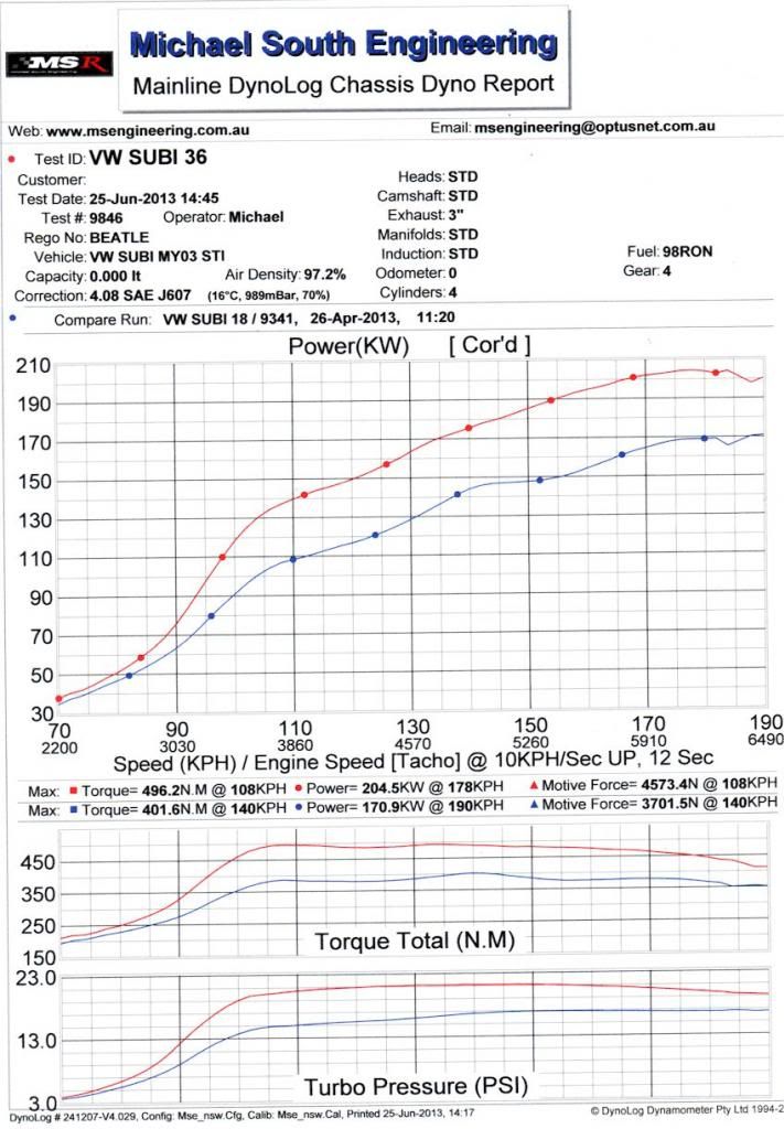

Some kilowatts were found. My car was just below the legal DB limit on a friends DB meter, to be on safe side I stuffed some chicken wire up the exhaust before going for rego inspection, I thought it had been removed, it was found to be still in place, I think some of my missing kilowatts are here.
Steve C June 26th 2013 21:59

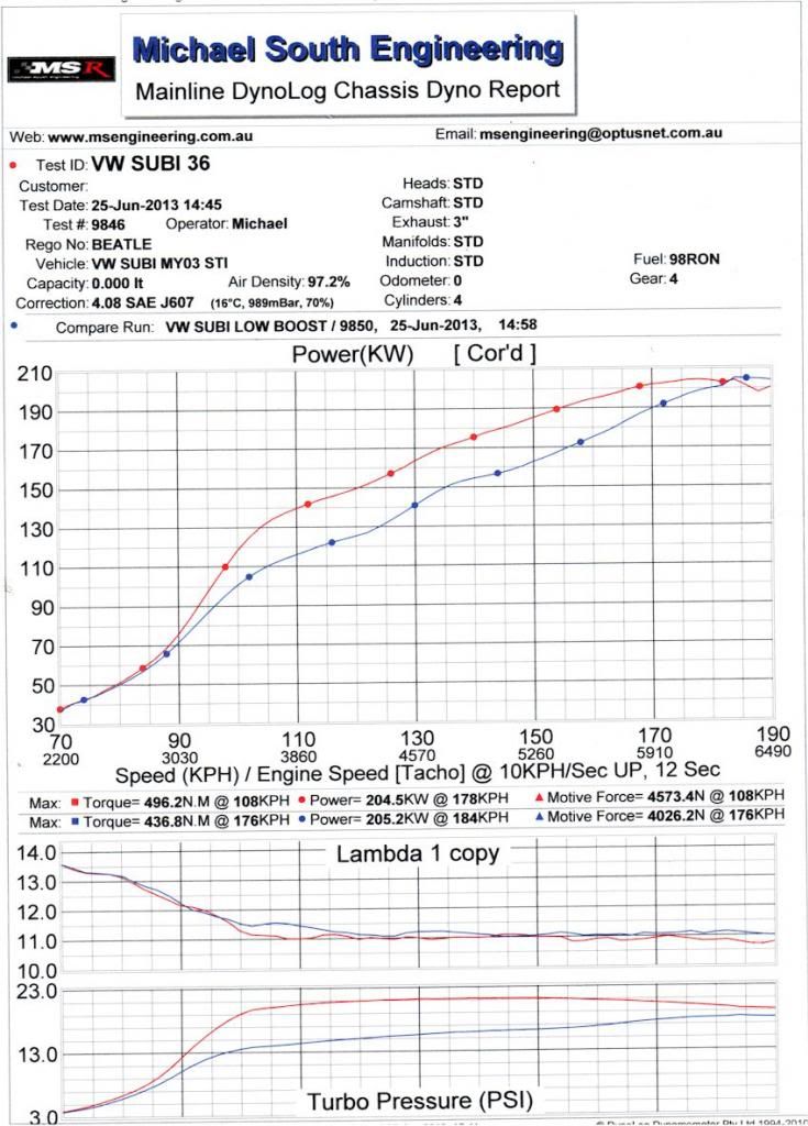

Just got back from the dyno shop, good news is that kilowatts were found as well lots of torque.
Shame its raining, I had to behave myself.
MSEdyno 2 is high and low boost settings on the e Boost 2, blue is low, red is high. MSEDyno 1 is just two different runs.
The E boost 2 defaults to lower setting which is about 16 psi on start up, I need to select the higher setting if I want it.
Its a heavy car so I will see how it goes on the weekend at the VWMA drags in Sydney.

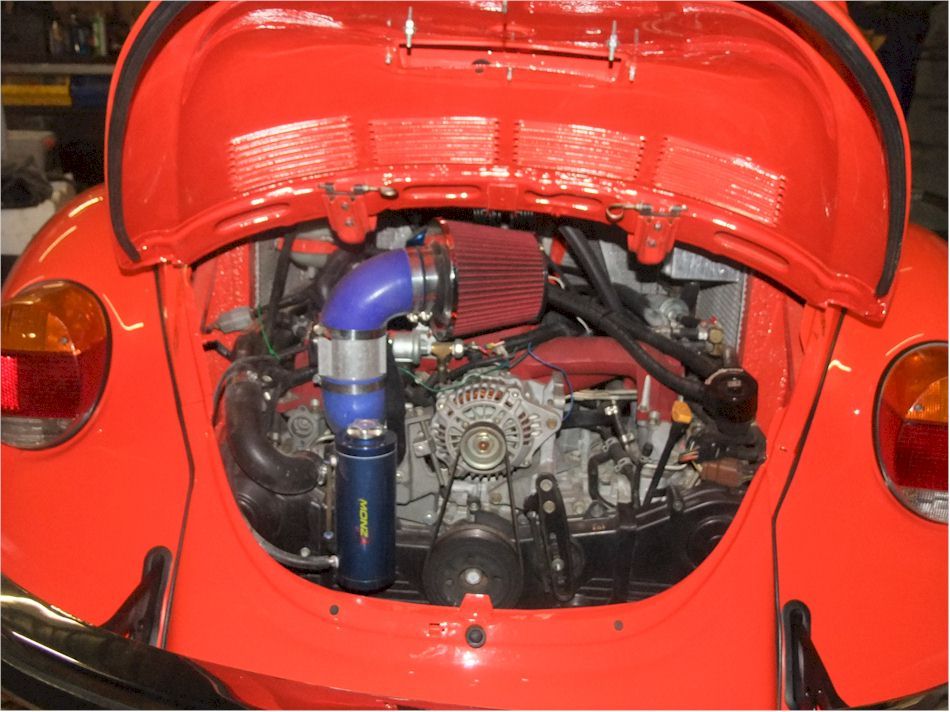

Car is all back together after a respray. I took the opportunity to get a stock engine lid painted at the same time, I think I will only use the tail for speed events.
All I had to do to fit the air cleaner in under the stock engine lid was to turn it around 180°
